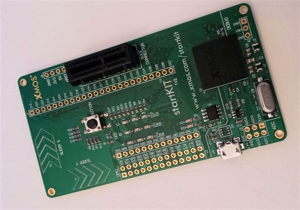

This post documents how to get started with XMOS’ startKIT which is an interesting board recently released (well, 5 months ago). The board is only slightly larger than a credit card (less than a centimetre longer) and packs an XMOS chip with multiple processors (more on that later), built-in 4-channnel ADC, touch sensors, integrated programmer/debugger, LEDs, switch and places for connectors. It costs under £12 including VAT (also available from Newark).
It was found that the XMOS startKIT is fantastic at handling timed events and multitasking. The development environment is fairly straightforward to use (it is based on Eclipse), and the programming language is C with a few extensions to handle multitasking requirements. Today, if you want to handle input/output at a relatively high speed with very high accuracy and ease-of-use, XMOS devices are very high up on the list of suitable devices.
The startKIT has a connector placeholder which is ideal for communicating to the Raspberry Pi, however for these first steps the board was used standalone. (Note - to use with a Raspberry Pi, a DIL pin header strip is required and a ribbon cable assembly; the board is not intended to be plugged on top).
For some initial experiments the XMOS board was used to connect to a hobby servo, and the on-board LEDs were used to test multitasking capabilities. A great debugging tool called XScope was also tried out briefly. Information on all that is further below.

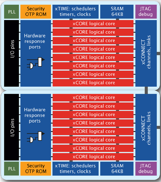

XMOS Terminology and Architecture
We are used to hearing about multi-cored chips which have multiple processors per chip, or at least multiple instances of most parts of a complete processor. In XMOS terminology, the term ‘core’ means multiple instances of some parts of a complete processor and the sharing of some things not present on non-XMOS processors. This may sound like a  bad thing, but read on and you'll find it isn't. In fact the implementation is a good thing for certain tasks; the kind of tasks that embedded systems often require. (I’ll call these cores ‘XMOS cores’ from now on, to make it clear). Totally unique non-shared instances of groups of XMOS cores can be placed on the same silicon; these unique instances are called ‘tiles’ in XMOS terminology.
A diagram can say a thousand words; the diagram below (taken from the xCORE architecture PDF document) shows in red the XMOS cores (8) per tile (two tiles in this diagram).
The device on the startKIT also happens to contain two tiles, each with 8 XMOS cores. One tile is available for user programs (tile #1), the other one (tile #0) is dedicated as a debugger on the startKIT.
XMOS have taken many of the essential bits of operating systems (i.e. traditionally software-based) and have implemented them in hardware. This means that you don’t need to run (say) uC/OS or other lightweight real-time OS’s, and you can still achieve multi-tasking.
In addition, you get ultra-low jitter, latency and the ability to prescribe timing (things still extremely difficult to achieve with traditional real-time OS’s on conventional processors) for one of the main things you’d want an embedded processor to handle - input/output.
This is the kind of stuff that is possible with FPGAs, and with non-XMOS processors running at a very high speed, but XMOS devices allow you to do this automatically with no software overhead, and with a standard programming language – C – with a few extensions. The extensions are designed to be as simple as possible to use (almost FPGA test-bench like) for handling I/O timing, and the message-passing/process synchronisation concepts are expressed as close as possible to the way conventional OS’s handle this.
This all sounds impressive (and it is), but XMOS devices take this a step further and make the message-passing/process synchronisation transparent to the programmer, so that the actual execution can occur between XMOS cores residing on the same tile, or on separate tiles on the same physical chip, or on separate chips connected with wire links. The hardware responsible for all that is known as xCONNECT (shown in blue on the right side in the diagram above). Again, some terminology needs explaining; xCONNECT is a term that appears to encompass links and switches. The links and switches allow the connection between the cores, regardless of where they reside. The links and switches are used to create point-to-point virtual circuits or ‘channels’ which can be opened up for as long as required, to pass information. The channels can traverse multiple physical chips to get to the correct destination. Each chip is connected to its closest neighbours using one or more sets of wire links (for a short distance of the order of several centimetres; for a longer distance additional circuitry would be required). At any one time multiple channels can exist; there is a ‘quality of service’ scheme that exists too.
Back to the XMOS cores in a tile; as mentioned earlier, each XMOS core has some dedicated hardware, and some shared hardware. The dedicated part is a separated set of registers per XMOS core. The shared part is memory and pipeline, but also a hardware scheduler used for implementing the process state and dispatching instructions into the pipeline in a round-robin fashion. Another major part of the secret sauce concerns the ability to timestamp events. XMOS instructions can be used to let an XMOS core sleep until one of a number of events occurs (such as a pin going high); when the event does occur, there is no delay waiting for a context-switch (which entails copying registers to memory and vice-versa) to occur as with a regular software-based OS. The scheduler merely needs to change the state so that that the sleeping XMOS core can execute. This is therefore fast and saves many clock cycles.
You may be wondering how timing can be guaranteed if XMOS cores can sleep. It is true that when many XMOS cores are asleep, the remainder ones will run faster. However, you can guarantee that the amount of processing time that each running one will receive will be a minimum of 1/x processor cycles, where x is the total number of XMOS cores currently running within a tile. The guarantee allows you to know beforehand if your code can execute in time to handle input/output. Actual I/O will still be timed precisely because I/O is time stamped. You can schedule input to be captured at specific times, or to be sent out at specific times. If the XMOS core needs to wait until that time occurs, then it will do so, allowing more processing time for the remainder running XMOS cores.

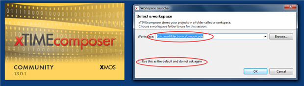

Installing xTIMEcomposer
For this, you’ll need to register at xmos.com and download “xTIMEcomposer” Community version from their support pages. (The screenshots below are for Windows, but the Linux version looked identical. Windows, Mac and Linux are supported, but for Linux check to ensure your particular distribution is supported).
Double-click to install the software, and accept the defaults where prompted. When installed, start it up.
For documentation, there will be a link in the Windows start menu, which opens a browser with all the online (mostly PDF) documentation, and this will be used later. All the documentation there is useful and relevant.
At the workspace prompt, put in something appropriate for your needs, and select it to be a default if you wish.

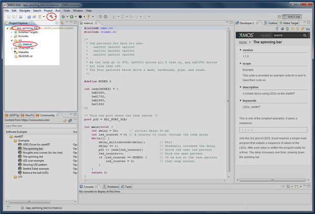

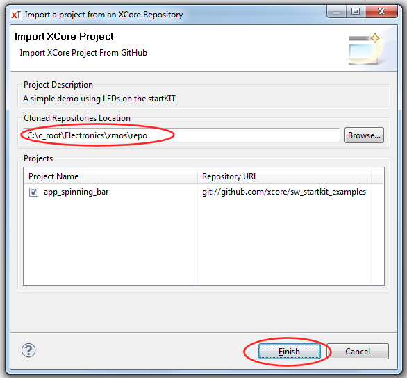

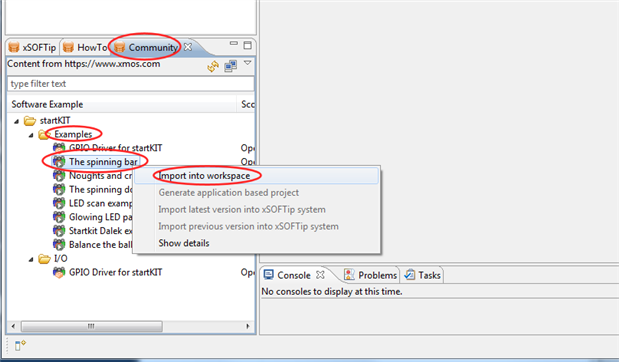

Import an Example Program
As a first step, import an example project. To do this, select ‘Community’ tab as shown here, and then traverse to ‘The spinning bar’, right-click and import into the workspace.
The example is imported from github. This requires a folder for the import. I created and selected a folder as shown here.
Once the project has been imported, you can expand the project hierarchy to view the source code (main.xc file) as shown below.

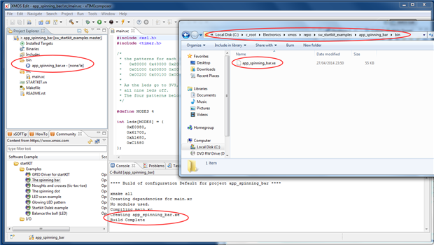

Building the project
To build the project, first select the top level of the project hierarchy (app_spinning_bar) and then click on the hammer icon, or select Project->Build Project.
If all goes well with the build, success is reported at the console at the bottom, as shown below. You’ll also see the built file (app_spinning_bar.xe) in the bin folder in the project hierarchy, and you can view it in Windows Explorer too if desired as shown in the screenshot here.

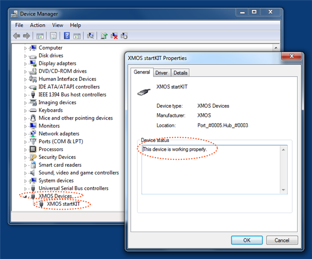

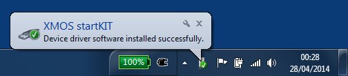

Plugging in the startKIT
Now you can plug in the startKIT into your PC if you’ve not already done so. Note that there is currently a software bug that means that the USB port on the PC must be USB 2.0, not USB 3.0. Some modern laptops have mostly USB 3.0 ports but may have a USB 2.0 port perhaps on the back (e.g. Lenovo does this with some ThinkPads). So, plug the startKIT into a USB 2.0 port and avoid any USB 3.0 ports for now.
When plugged into a port, you’ll see a message appear to indicate that the device is correctly installed.
Windows device manager could also be checked to confirm all is ok:

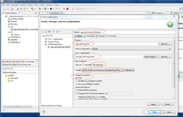

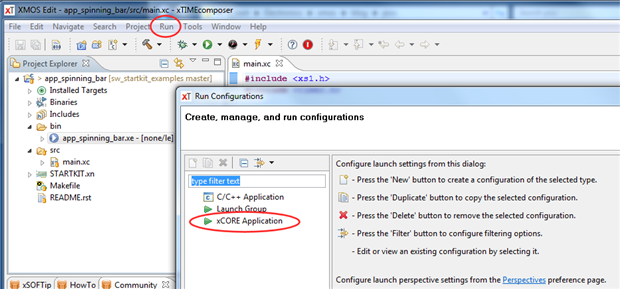

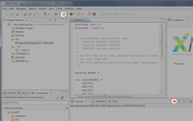

Running a Program
In order to run the code, first select Run->Run Configurations, and then double-click on xCORE Application as shown here.
Once you’ve double-clicked, you should see a display as shown below. You should not have to make any changes here, but just observe to make sure all the highlighted areas look similar. Notice the Target drop-down should say something like “XMOS startKIT connected to …”. If it does not, then click ‘Refresh List’. If that doesn’t work either, then perhaps the startKIT is plugged into a USB 3.0 port by mistake.
When ‘Run’ is clicked, the spinning bar program will get transferred to the startKIT and will begin executing.
From now on, to run or stop the program directly from the main view, you can use the run and stop icons as shown here:

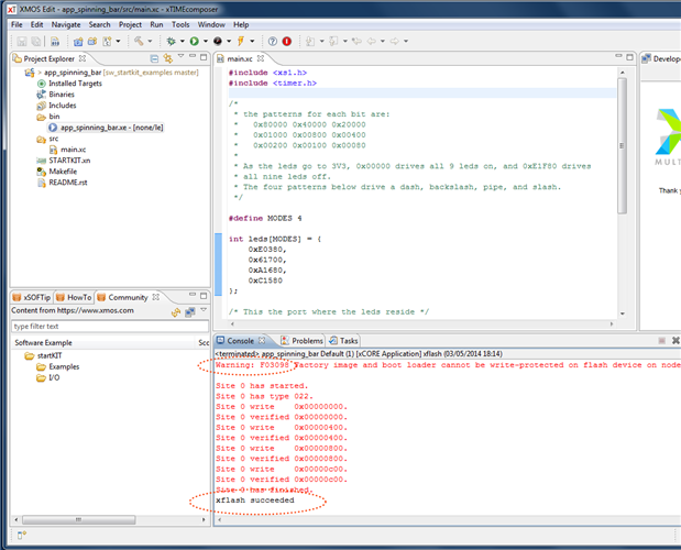

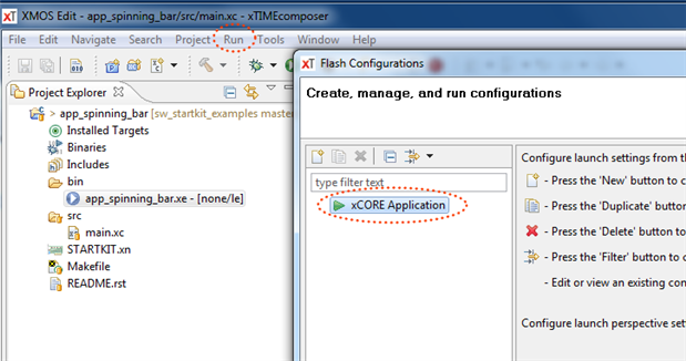

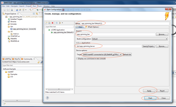

Programming the FLASH
To permanently store the program in FLASH, select Run->Flash Configurations. In the window that appears, double-click on xCORE Application as shown here:
The display should look as shown here, but confirm all the marked items, and then click Apply and then click Flash.
When you clicked Flash, the console displays some text in red. The warning can be ignored:
Once the console says “xflash succeeded” as shown above, the USB cable can be disconnected and reconnected to make the program run.

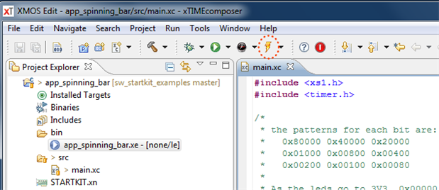

To re-program the FLASH after making any code changes and recompiling, the lightning shaped icon can be used:

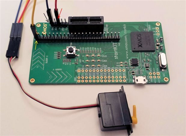

Controlling a Servo
I wrote some quick code to experiment with timing with XMOS. XMOS handles timing quite uniquely, almost hardware test-bench language style. Typically with a microcontroller, a clock is set up to interrupt the microcontroller and execute an interrupt service routine that can then be used to control input/output. For easier control of the exact timing some microcontrollers have dedicated PWM units with quite a bit of flexibility, but nothing like XMOS have implemented.
As an example with XMOS, for servo PWM, it is possible to use these lines in a loop, where width is a variable corresponding to microseconds in this case:
t+=width;        servo @ t <: 0;
t+=20000-width;  servo @ t <: 1;
The code above will set the servo PWM signal low at a period of value ‘width’, and high at a period of value 20000-width.
The entire code is pasted below. To use it, you can connect up a servo to the startKIT as shown in the photo:
I used a small, especially low-power servo. For a larger servo you should use an external power supply, do not rely on the USB supply.
This was the code that was used (note: copying will result in hidden non-text characters in this html content being copied, so either manually type, or use the text file attached to this post):

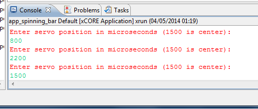

        printf("Enter servo position in microseconds (1500 is center):\n");
        scanf("%d", &width);
        for (i=0; i<200; i++) // loop for a while
    return 0; // warning on this line is ok
The code is designed to be run using the xTIME Composer console, and when run it will prompt the user to enter a value in microseconds. When this is done, the servo will move to the corresponding position. The code is not practical, because when disconnected from the PC there is no console capability. However it is absolutely great for code debugging or for testing out some hardware such as a servo as in this example.
Enter the code into xTIME Composer, build it as before, and then run it. The console will prompt in red text. Click inside the console window, and type an integer value as shown here:
Once the value is entered, the servo will move to an appropriate position.

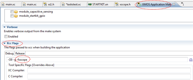

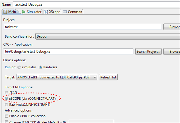

To use XScope, the header file xscope.h needs to be included in the program. Also, double-clock on the Makefile in the Project Explorer, and you should see a “XMOS Application Makefile Editor” appear.
Traverse to the ‘Xcc Flags’ section and append ‘-fxscope’ to the flags list as shown above, and then click File->Save.

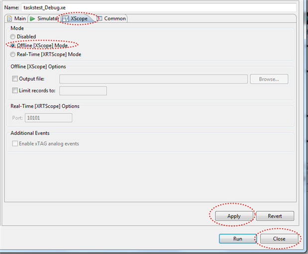

Then, go to Run->Configurations and change the Target I/O options setting from JTAG to xSCOPE.
Next, click on the XScope tab, and change the Mode from ‘Disabled’ to ‘Offline [XScope] Mode’ as shown below. The, click Apply and then Close.

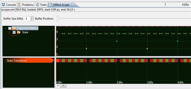

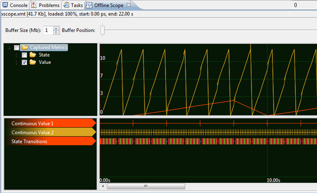

Now the code can be modified to insert the instrumentation. In the main() function, the following line can be added:
xscope_register (1, XSCOPE_STATEMACHINE , " State Transitions ", XSCOPE_UINT, " State ");
Now, whenever there is a state change, the following code can be added, where x is a number that will represent the state.
xscope_probe_data(0, x);
I inserted such a line in the main() function, twice in task1 (after each  delay_milliseconds function) and in task2 to record the LED toggled state.
When the code is compiled and run, a file gets created called xscope.xmt. Click Terminate to stop the program, and you will see the file in the Project Explorer. Double-click the file, and the ‘Offline Scope’ will appear where the console view was. Check the State checkbox. You will see a view similar to the one shown below (you can use the zoom keys to the right of the console view to expand in). This shows the states and the time spent in each state. The states are shown on the vertical axis (marked 0,1, 2, etc). Time is on the horizontal axis.
XScope is capable of a lot more. It can also plot analog values. For example, the xscope_register function can be called as
xscope_register(1, XSCOPE_CONTINUOUS , " Continuous Value 1", XSCOPE_UINT , " Value ");
The same xscope_probe_data command as before will now plot analog values. Multiple sets of data can be captured simultaneously using this syntax:
xscope_register (3, XSCOPE_STATEMACHINE , " State Transitions ", XSCOPE_UINT, " State ",
                        XSCOPE_CONTINUOUS , " Continuous Value 1", XSCOPE_UINT , " Value ",
                        XSCOPE_CONTINUOUS , " Continuous Value 2", XSCOPE_UINT , " Value ");
Here is an example of analog values output:

    Hi Clem! As John says, you'll be able to bring up 16 threads across the two physical cores (aka XMOS tiles) you have available, 8 per tile. In general comms between different threads (regardless of device…
  • Problemchild
    Problemchild over 11 years ago in reply to clem57 +1
    Clem, the number of threads is normally 8 * the number of real cores you have in the package. Each thread is a hardware maintained context thus the limit of 8. You could always implement further Sub threads…
