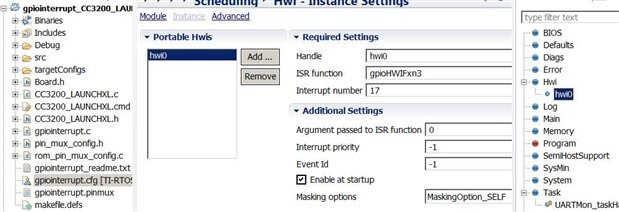

I want to create Hwi, and toggle LED by button SW3 switch, in Hwi context. But the interrupt from SW3 is not responding, no blinking LED.
Know anyone where the error is and has someone an example that works?
Enable interrupt or interrupt “pin number” might be the problem.
If I use callbacks, everything works (for example I adapt gpiointerrupt_CC3200).
I use following code:
My function:
void gpioHWIFxn3(void)
    GPIO_toggle(Board_LED1);                       // LED D6 yellow
Code should be executed in HWI CONTEXT
So I enabled Hwi MODULE in cfg file
instance -> add -> hwi0
that calls
gpioHWIFxn3() function, interrupt number 17 (SW3, GPIO PortA1? )
MaskingOption_?
My main(),
adapt gpiointerrupt_CC3200 from “Project examples – Wireless Connectivity MCU – Driver Examples – GPIO _ Interrupt”
When I use callbacks, everything works correctly, that means pinmux is ok.

    GPIO_setCallback(Board_BUTTON2, gpioButtonFxn0);             //SW2, LED red
    /* Enable interrupts */
    GPIO_enableInt(Board_BUTTON2);
