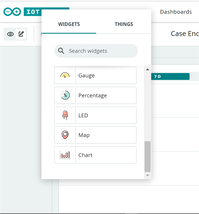

    Hello  ralphjy very interesting inquire.
    I haven't tried it myself ,but there is a Map widget on the Arduino IoT clouds dashboard editor. i have used the IoT cloud for Visualization of telemetry data from Arduino boards. I noticed this widget and placed in the back of my maker mind, as a possible GPS location/visualizer to be included in a future project.
    I had real good luck implementing data visualizers  with several models of Arduino boards. I found it very easy to  implement a design involving data visualization.  There is an Arduino  GPS shield available at https://store-usa.arduino.cc/products/arduino-mkr-gps-shield?selectedStore=us
