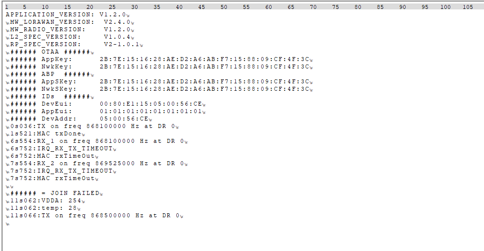

Currently, I am working with an IoT application on the board Nucleo-WL55JC1 with the sensor BME688. The example I am using is LoRaWAN_End_Node downloaded from STM32Cube MX.
What I did: I initialized the the BME688 and set up some configuration after the initialization of MX_LoRaWAN_Init(). I, then, set up some configuration outside the while loop. I "extern"ed the variables below so that I can used them elsewhere:

The problem: as in the code, I set the sensor to work in sequential mode, however, the whole setup stopped working after the first measurement. The same thing happened when I set the sensor to work in parallel mode. Sleep mode worked okay and for Forced mode, I could achieve the first measurement before the sensor turned to sleep mode (correct).
Question: Where should I start tracking the problem or how do I fix this problem?

    I have no idea (it is going to be hard for anyone to respond who has not used the same code as you, which will restrict it to very few people perhaps).
    Just from the debug you've shown, there is a 'join failed' error. Could it be that the join to the LoRaWAN network was not possible, and anything BME related is a red herring until you resolve that? You might need to raise this on a ST forum, if it is their stack.
    If it is unrelated to LoRaWAN, then it could be worth creating a simpler non-LoRaWAN small project just to test out your BME code,  and confirm that is working before adding it to the proper project code. That's how I would go about it all.

    Thank you for your response. First of all, I also had a small project in which I tested the BME688 on the Nucleo board and that project worked well (the project had nothing related to the LoRaWAN_End_Node example). Then I brought the whole code and added to the LoRaWAN_End_Node example and the issue occurred.
    Later, I narrowed the problem down to how to add a task to LoRaWAN_End_Node example. To be specific, I would divide the BME688's operation as tasks and register it to the LoRaWAN_End_Node. I am still stuck at that point.
