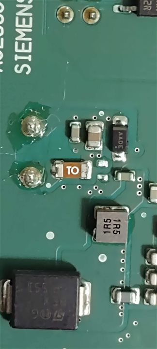

Hello All,
I have a Simatic IOT2020 that I device to start using again yesterday. Unfortunately after getting setup and moving it to where I needed it, I seem to have somehow blown the board. I have tested power to where the connector meets the board. I am getting a full 24V at that point on the board. I was hoping to try track down what component I may have blown, but with out a schematic or knowing what some components are, this is posing to be quite the challenge.
Is there anyone on E14 that may have a schematic for this device or know someone that could help me get a copy (I would happily sign an NDA if needed). Alternatively if there is soe0me one willing to help me troubleshoot the board that has a Simatic IOT2020 that to would be very helpful. My last option would be if anyone could help identify some components so I could at the least look them up to learn what they should be doing and how they should behave under power.
Thankfully
Kas
P.S. I have attached an image of a part of the PCB, I am unsure what the component with the markings "TO" is. Any help would be appreciated. There is a similar part but with a "H" marking.

    The part marked TO looks to me like a resettable PTC polyfuse. If you're seeing a big voltage drop across it, it's probably a downstream component causing over-current tripping the polyfuse. See if anything…
    If you're seeing a big voltage drop across it, it's probably a downstream component causing over-current tripping the polyfuse. See if anything else downstream may be getting hot perhaps?

    I wonder if someone's reverse-polarised it and managed to short out a TVS protection diode. I can't tell the marking, but the big black component at the bottom of the photo looks like it could be a TVS diode? If it is shorted out, perhaps it was designed in a way that the polyfuse will open to prevent the TVS diode from going up in smoke/flames.
    Just a stab-in-the-dark not seeing the rest of the board.

    The part with the marking 'TO' is indeed a SMD PTC resettable fuse. This is an over current and over temperature protection circuit device. In case of any short circuit on board, heavy current flows through the fuse thereby raising the temperature and eventually its resistance (being a PTC fuse). Thereby you see, all the voltage is dropped across the fuse and your circuit is protected.
    One way to troubleshoot the failure is to
    1. Check the voltage drop across the fuse. If it shows voltage drop close to 24V (18V-24V), then it is clear there is some short circuit on the board. Ideally the voltage drop across the fuse should be zero.
    2. Look closely for any burnt marks on the board or components to locate short circuit.
    3. Check the resistance at the input power terminal (24V source). If it shows <100 ohms, then there is something fishy about it. Ideally the resistance value of the input power source should be in the range of KOhms.
    4. Kindly check the VCC and GND resistance of all the components that are powered on 24V supply. It should read in the range of Kohms.
    5. Check for any Voltage regulator IC on board. If yes, then check it's both input and output resistance w.r.t. GND.
    6. If you find any shorting at input or output of voltage regulator IC, then one by one by disconnecting the components those are tied to this voltage regulator's input or output, check if the resistance between its VCC and GND has increased (i.e., from < 100 ohms to KOhms). This way you can identify the faulty component.
    P.S. If you see a voltage drop across the fuse, this means that the fuse is working absolutely fine, and you need not seek its replacement. Instead, there is more trouble going ahead in the circuit. ;-)
