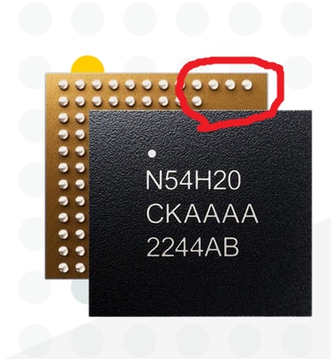

    Some well known Nordic features like cursed footprint remains untouched, so everything is ok.

    Some well known Nordic features like cursed footprint remains untouched, so everything is ok. Slight smile
