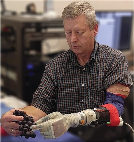

Keven Walgamott plucks a grape from a cluster using a prototype LUKE Arm
(PHOTO CREDIT: University of Utah Center for Neural Interfaces)
Interfacing with the nervous system allows the wearer to control the hand by thought. This connection also allows sensors in the LUKE Arm’s hand to sense touch and pressure then relay that information to the correct nerves in one’s arm creating a sense of touch and feel. These new abilities make tasks such as peeling a banana, or opening a door much easier, and somewhat more intuitive for the wearer.
