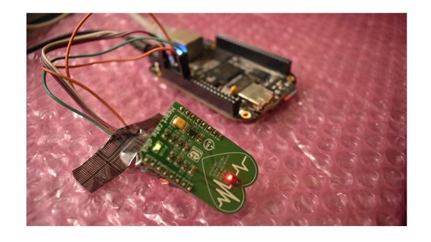

The setup :
  • BeagleBoneBlack Rev 3 (https://beagleboard.org/black)
  • MAX30100 (https://www.maximintegrated.com/en/products/sensors/MAX30100.html)
MAX30100 is a PPG sensor manufactured by Maxim Integrated. The sensor features RED(660nm) and IR(880nm) LEDs , a photo detector  and a processing unit.

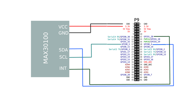

MAX30100 has an IIO driver available for linux(https://github.com/torvalds/linux/blob/master/drivers/iio/health/max30100.c ). This is the reason why I chose Beaglebone black as the processor board. So I wired up the max30100 to my BBB.
MAX30100 uses I2C bus and the module address is 0x57.
Beaglebone black has 3 I2C buses. Unfortunately I2C 0 (The one which is enabled by default )can't be used because an EEPROM with the same address is present at the board.
So enable the I2C1 and register max30100@57

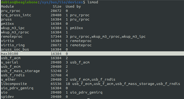

After the reboot IIO device will appear. Confirm it by checking /sys/bus/iio/devices
two devices got listed one is the ADC which is a platform device enabled by default and the new max30100.
use lsmod command to confirm.

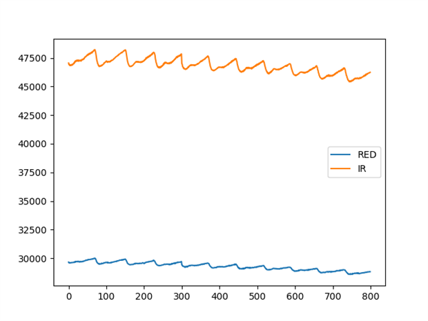

plt.plot(red[200:350])
plt.plot(ir[200:350])
plt.show()
The sample plot are given below.
Both RED and IR signals have two parts an AC component and a DC component.
AC component represents the volumetric flow of blood.
DC component represents the reflected photos from the different tissue levels.

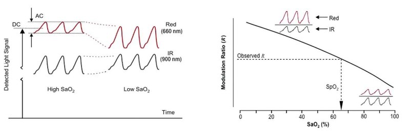

Now lets talk about SpO2
SpO2, also known as oxygen saturation, is a measure of the amount of oxygen-carrying hemoglobin in the blood relative to the amount of hemoglobin not carrying oxygen. (https://www.homecaremag.com/understanding-spo2-and-normal-oxygen-levels )
Oxyhemoglobin(HbO2)absorbs visible and infrared(IR) light differently than deoxyhemoglobin(Hb),and appears bright red as opposed to the darker brownHb. Absorption in the arterial blood is represented by an AC signal which is superimposed on a DC signal representing absorptions in other substances like pigmentation in tissue,venous,capillary,bone,and so forth. (https://www.ti.com/lit/an/slaa655/slaa655.pdf )
The SpO2 is the ratio of ratios AC over DC of RED and IR signals.
R = (AC of Red / DC of Red)/ (AC of IR / DC of IR
% SpO2 = 110 – 25 × R
Note : In the above code I have used maxima - minima to calculate the AC component. You can use RMS of the AC component to get slightly better results.
