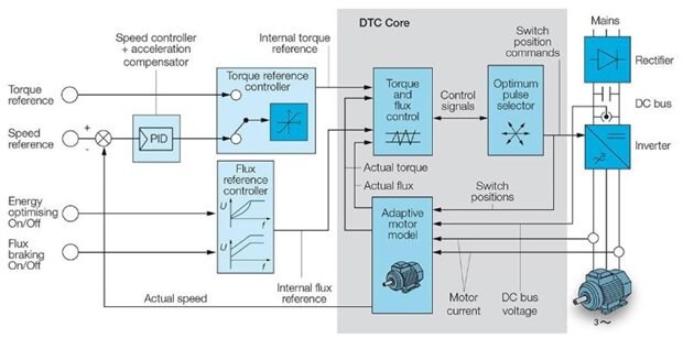

In principle, DTC was already a leading technology back in 1995, but subsequent developments in processor computational power, communication interfaces, application programming, etc., have enabled higher performance, providing premium motor control for a broad range of applications.image
DTC’s core is the torque control loop, where a sophisticated adaptive motor model applies advanced mathematical algorithms to predict motor status. Primary controlled
variables—stator flux and motor torque—are accurately estimated by the motor model using inputs of motor phase currents and DC bus voltage measurements, plus the states of the power-switching transistors in the drive. The motor model also calculates shaft speed. Temperature compensation helps to enhance calculation accuracy without an encoder.
Other Benefits
In a larger view, benefits of DTC extend to software, user interfaces, maintenance, and system-level features. As the name suggests, DTC seeks to control motor flux and torque directly, instead of trying to control these variables indirectly like DC drives and vector-controlled AC drives do. Separate torque and speed control loops make up the full DTC system but work together in an integrated way.
Additional motor parameters are automatically fed to the adaptive model during a motor identification run when the drive is commissioned. In many cases, appropriate model parameter identification can be done without rotating the motor shaft. For fine tuning of the motor model, which is only needed for few high-demand applications, the motor has to be run, but then only for a short time and without load.
Stator resistance (voltage drop) is the only and easily measurable parameter needed for estimating the motor’s magnetic flux. Motor torque can then be calculated as the cross product of estimated stator flux and stator current vectors. While stator resistance is the main source of estimation error, its influence diminishes with increasing motor speed and voltage. Thus, DTC has excellent torque accuracy in a wide speed range. Moreover, DTC includes advanced ways to minimize estimation error at low motor speeds.
Output signals from the motor model — which represent actual stator flux and motor torque — go to a flux comparator and torque comparator, respectively. These separate control units compare their inputs to a flux and torque reference value. Already in mid 1990s the first DTC controlled drives performed these functions every 25 microseconds (µs) using a high-power digital signal processor (DSP). In the latest control generation the interval is reduced down to 12.5 µs, thus further enhancing control performance. Each comparator seeks to hold its respective flux or torque vector magnitude within a narrow hysteresis band around a reference value. DTC’s fast torque response without overshoot comes, in part, from ability to minimize these vector fluctuations.
Exceptional motor response is also due to the DSP control algorithms updating the adaptive motor model at the same high cycle rate. Flux and torque errors — differences between estimated and reference values — and the angular position (or sector) of the stator flux vector are used to calculate flux and torque status in the hysteresis controllers. Then, these status values become inputs to the optimum pulse selector, where the optimum voltage vector is selected from the look-up table. In this way, the most appropriate signal pulses for each control cycle can be sent to power switches in the inverter to obtain or maintain precise motor torque.image
A form of programmable logic — so-called field programmable gate array (FPGA) — assists the DSP with determining inverter switching logic and other tasks. The FPGA allows for control modifications or drive design updates versus an application-specific integrated circuit (ASIC) which, if used, requires locking-in the design. The speed-control loop, which comprises the rest of DTC’s functional blocks.
