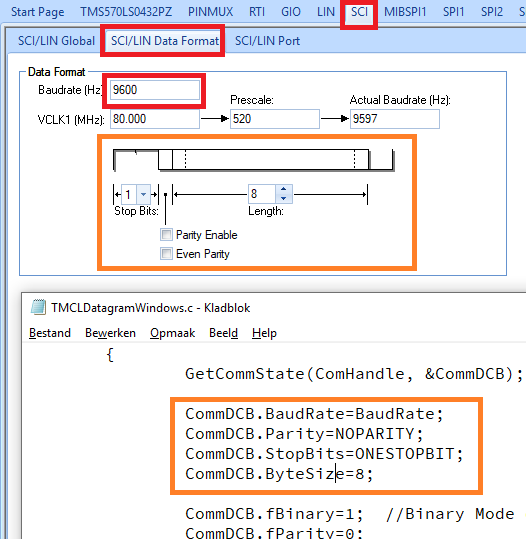

I'm road testing Trinamic TMC2300 EVAL KIT (2-PH Stepper Motor). It's their latest design that targets battery powered devices.
In this post: a custom program to control the driver over UART.
This series of posts is an attempt to use the TMC2300 in a real design. I'm using a Hercules microcontroller in stead of the landungsbrücke to control a motor. Firmware is in C++
Several things are happening at the same time here. I'm splitting it up in chunks to keep it concise.
  • I'm using a Texas Instruments Hercules microcontroller as  host.
  • Communication to the TMC3200 is using UART, and
  • You send and receive 9 byte datagrams - with CRC  (see Trinamic Stepper Motor Controller TMC2300 - UART Interface).
  • I'm using objects to talk to the motor (see Hercules Safety Microcontroller: Use C++ with HALCoGen C Projects)
  • For the raw UART driver code, I use the basic Hercules HALCoGen api, sending byte per byte
The Objects:
  • a main class called CPPMain. It's role is to bridge from the functional style HALCoGen framework to C++, and to run the program.
  • an abstract TMCLDatagram base class, that knows Trinamic's TMC Language definitions, the datagram structure and CRC logic. it does not know anything Hercules (or even the physical layer used).
  • the HerculesTMCLDatagram class, child of the one above. This one knows were using UART, and knows the HALCoGen API.
  • an abstract CommInit class. You pass a child of that class to the init()  function.
  • The HerculesSciInit class, based on the one above, a structure to hold UART config parameters.

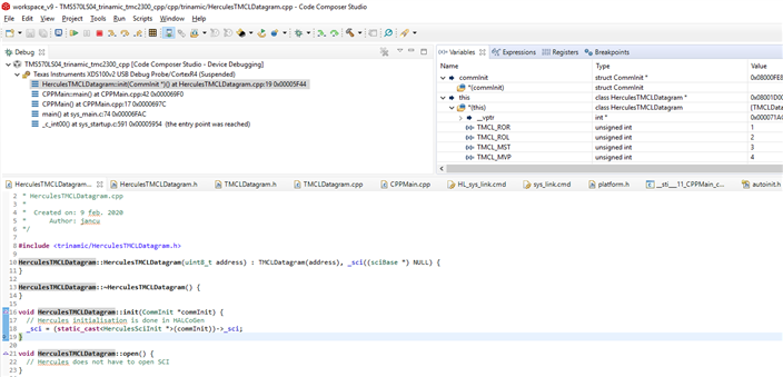

At the begin of the program, a HerculesTMCLDatagram class is instantiated, then initialised and (in a later post) used.

Because the HALCoGen framework is intended for C, and C++ static objects are constructed early, there is a watchout.
It's not adviced to dynamically allocate objects on an automotive microcontroller (unless you include an approach in your Misra strategy), so I'm creating objects statically.
The constructor of these objects are called before the main() function and before the HALCoGen init is complete, so hardware isn't initialised yet.
Don't do anything hardware related in the constructors. Use an init() function for late initialisation.
I've made the HerculesTMCLDatagram class a child of the TMCLDatagram class.
The TMCLDatagram's physicalRead() and physicalWrite() functions are pure virtual, implemented by HerculesTMCLDatagram.
There are other options, such as putting reads and writes in a separate opbject that's passed to TMCLDatagram, or (ducking for cover) multiple inheritance.
Not too happy with the initialisation approach where the base class expects a CommInit object and the derived class a HerculesSciInit. There are pros and cons. Discuss.
... and in this post and the attached project I'm mixing 8 and 32 bit unsigned integers. I'm going to use 8 for those that take a single space n the transmit buffer. It will be updated in the next post.
Hercules Peripherals Configuration
Initialisation and configuration of the peripheral drivers is done in HALCoGen. I did not try to abstract that into objects.
The Code Composer Studio and HALCoGen project are attached.
