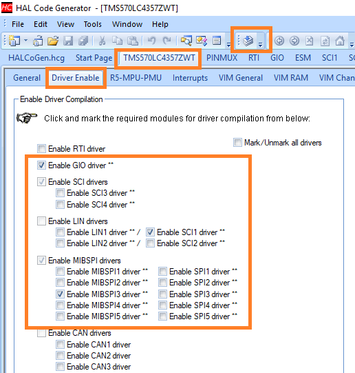

Project Generation with HALCoGen
You don't have to do anything specific. Just use TI's instructions and generate a project according to your needs.
You enable and configure drivers as if you are doing a plain C project.
