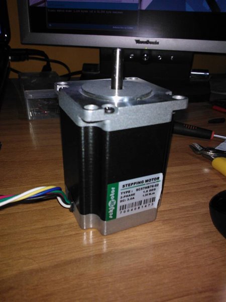

this is a 2-phase stepper motor drive by a chinese company called SCKJMOTOR with the model number SC2680MH
it can be found here in this link http://sckjmotor.com/prodetail.asp?cid=3&scid=6&id=67
i am not much experienced with electronics so i cant figure out how to use it with out an instruction manual and sadly the manual is in chinese image
so i thought maybe i can find some help here on element 14
you can see in the pictures  the driver has lots off ports on it they go like  + , PU, + , DR, + , MF, + ,  TM, +V, -V, +A, -A, +B, -B
here i think the " + " ports might be a 5V input so i guess i must give 5V in them, but why are there so many???? why do i need to give the driver 5V at 4 different ports ???   image
the port " PU " might be pules, i am just guessing, it might be to control the speed of the motor
the port " DR " maybe direction like forward-reverse, another guess
the port " MF " i have no idea, cant even guess this one   image
the ports " +V " and " -V" the driver says on the side " DC24-80V "  so i guess i might have to give it some thing between 24V to 80V
the posts  +A, -A, +B, -B  are clear i guess, i just have to find the right coil pairs of the stepper motor and connect it to these ports  image
there is also some thing called a division setting table and it gives me values  1, 2, 4, 8, 16, 32, 64 and 128 , i think this must be some thing related to the step divisions of the stepper motor, need some help with that as well
please try to help me out with this, i am just starting to take interset in electronice and dont have any experience in this at all, just have some basic electronic knowledge since i am doing engineering and its my 1st year

    i connected this motor to driver
    its a 6 wire stepper motor i found the +A -A +B -B wires and connected it to the driver in those ports
    connected 24V to +V and -V
    first ran the motor in test mode which is D1 on, it runs fine when i keep the division table to 8 or higher ( as you can see in the driver pictures ) that is D6 off D5 off D4 on
    division table set to 8 the motor runs the fastest and runs slower as i go higher that is 16 32 64 128
    what is this division setting exactly  ???
    then i programed an arduino to give an pulse of width 1uS connected it to port PU and gave 5V in the first + port fron the top, it dint run then i gave 5V in the 2nd + port, the motor still does not run, i connected 5V to DR as well then the motor started running  but was very slow ( 1 rev in 6 secs) when the division setting is set to 8
    then i set the division setting to 1 that is D4 on D5 on D6 on , then the motor runs some what fast  ( 5 rotations in 1 sec ) ( D2 is on )

    A stepper motor have has his name said a step. Generally  one step turn the rotor about 1.8° so to do a entire turn you have to send 200 pulse to PU.
    If you put a division, you reduce the angle. so divide by 2 one step will turn the rotor by 0.9° so you have to send 400 pulse to PU to do one rotation.

    If you see the blinking led that the frequency is too low. You have to increase the frequency.
    If for example the frequency is 10Hz, the LED blink every 0.1s, to do 200 pulses you have to wait about 20 seconds. And this without division.
    So you have to increase your pulse frequency, the number of pulse within 1 second to rotate your motor fastly.
    The speed of the motor is the same as the speed you send your pulse.
    More you use division (1,2,4,8,...) more you will be precise but you have to send 1,2,4 times more to do 1 rotation
    Man Long
    0 e14 Contributor over 13 years ago in reply to manlong
    i just realized a small mistake i was making in arduino program *facepalm* that i was taking to be microseconds was millisecond i was giving an on/off signal by the arduino with 1 millisecond delay in between [ delay(1) ], so i found an other command used for making delays in microsecond [ delayMicroseconds(500) ] so i changed the program a little and noticed that the max i can reduce it was 500 Microseconds
    now the on/off signal is with the delay of 500 Microseconds [ 1 sec = 100000 micro sec ]
    so now the motor is running almost 3 times faster  both forward and reverse
    one more thing, i have not made the arduinos and the drivers ground common, i have not used arduinos ground at all i have only taken the pulse from arduino and DR (direction) signal
