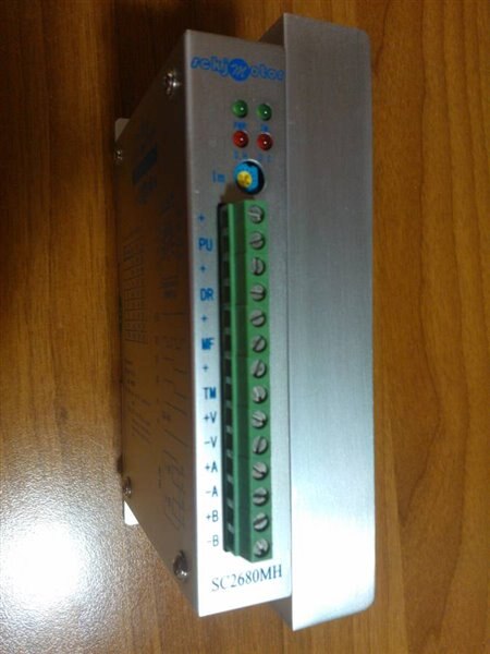

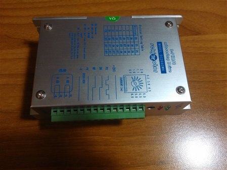

this is a 2-phase stepper motor drive by a chinese company called SCKJMOTOR with the model number SC2680MH
it can be found here in this link http://sckjmotor.com/prodetail.asp?cid=3&scid=6&id=67
i am not much experienced with electronics so i cant figure out how to use it with out an instruction manual and sadly the manual is in chinese image
so i thought maybe i can find some help here on element 14
you can see in the pictures  the driver has lots off ports on it they go like  + , PU, + , DR, + , MF, + ,  TM, +V, -V, +A, -A, +B, -B
here i think the " + " ports might be a 5V input so i guess i must give 5V in them, but why are there so many???? why do i need to give the driver 5V at 4 different ports ???   image
the port " PU " might be pules, i am just guessing, it might be to control the speed of the motor
the port " DR " maybe direction like forward-reverse, another guess
the port " MF " i have no idea, cant even guess this one   image
the ports " +V " and " -V" the driver says on the side " DC24-80V "  so i guess i might have to give it some thing between 24V to 80V

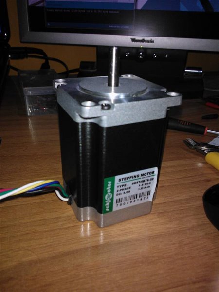

the posts  +A, -A, +B, -B  are clear i guess, i just have to find the right coil pairs of the stepper motor and connect it to these ports  image

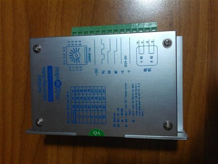

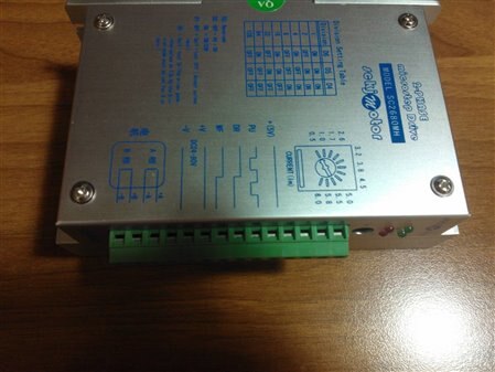

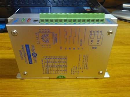

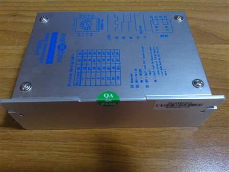

there is also some thing called a division setting table and it gives me values  1, 2, 4, 8, 16, 32, 64 and 128 , i think this must be some thing related to the step divisions of the stepper motor, need some help with that as well
please try to help me out with this, i am just starting to take interset in electronice and dont have any experience in this at all, just have some basic electronic knowledge since i am doing engineering and its my 1st year
thank you

    There are some Cantonese speaking people at work, but I'm on day off today, so it would be tomorrow before I could see if they would translate the datasheet for you.
    Looking at the wiring diagram from the link you posted.
    It does indeed look as though there are three + connections to 5v (perhaps there are 3 internal modules, I don't know). I thought MF might be the 'motor frame' connection, or to you and me, the ground/-v connection, on the other hand there is a timing diagram of a low to high pulse requiring 1uS rise time, so I'm not entirely sure. The wiring diagram has bracketed text underneath that wire, which normally means used or not used under certain conditions.
    As there is a timing diagram attached to the PU and DR, as you surmise the PU might well be the PWM drive pulse active on the high to low edge, my first thought was the same as you for DR, possible direction, but by the looks of the timing diagram it does something by going high to low 2.5uS whilst PU is high and before the PU pulses start, MF needs to be low to high before DR goes low.
    D4,5,6 switches are indeed the pulse step setting. D2 appears to change the way PU and DR relate to each other. D1 looks as though it might either change the PWM frequency or perhaps provides always on, always off and PWM modes of driving a motor. D3 haven't the faintest idea image .
    *******************************EDIT**************************************
    PU = PWM = motor speed.
    DR: Depends on setting of D2 , if D2 is ON it looks as though DR is the direction control by voltage, if D2 is OFF then it appears to require a pulse of some kind, without an actual translation that is just a guess.
    D3 is not used by this module currently.

    OK, just asked someone here and this is what I could make out.
    MF - motor output signal or some form of feedback (Does not need to be connected)
    V+ - DC Power
    V-  - DC Power
    A  - Stepper motor phase A
    B  - Stepper motor phase B
    TM - Zero point (we think)
    Im - Current in coil
    PU - Stepper pulse (D2-on step on rising edge, D2-off step on falling egde) we think
    DR - Direction D2-off direction control signal, D2-on reverse pulse
    Also in teh data sheet were it says asomething then 0 - 0.5V that is the low required, 4-5V that is the high required, 2.5us is the pulse width. The PU/DR + take 5V and if >5V is applied a current limiter is needed.
    I think that should get you somewhat started on the understanding what is what but to get it aculy working it seems liek there is a controller that plugs into PU- and DR- as can be seen in teh picture n ttop right corner of teh data sheet.
    (sorry about spelling, writing this quickly while at work)

    0 kas.lewis over 13 years ago in reply to e14 Contributor
    I would input 5V to PU/DR+ and then connect the other connections as described (or how you understand them to be connected) and then just try diffrent things. I might suggest if you can get an O-scope or use one at the university that would give you better info then connecting to a motor at this point.
    And you do NOT need to connect MF to anything for now.
    I understand what you are saying about PU/DR, but from the schematic it looks like the pos are cennected  5V and neg to the controller (the controller could be used a s a pull down instead of a pull up, I am assuming). If you do this be sure the uC pins are rated at 5V.
    TM we could not fully understand but we understoof something about zero point, what that means we are unsure.
    +V and -V does look like it is connected to 24V
    Hope someone else can help explain teh setup, these are my assumtions from what I understood, maybe someone else can give some input as well.

    0 bodgy over 13 years ago in reply to e14 Contributor
    CW = Clockwise.
    CCW = Counter Clockwise  or if you prefer anti clockwise.
