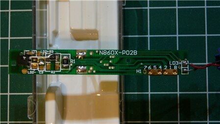

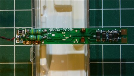

I have a model train locomotive (N-scale, Bachmann Spectrum GE Dash 8-40C) that I am converting from DC to DCC. I'm told by another source to "remove the two chokes (inductors?) from the PCB" and solder the connections from the DCC decoder to the PCB. I'm leery about removing these components as I don't understand what they do and why it would be OK to remove them.
I'm willing to bet money that it's OK, but I want to understand the components and the process better. In an attempt to do that, I thought I would try to replicate the circuit (as much as I can) using Eagle and maybe learn what's going on. The roadblocks I have encountered so far are that I can't find a 15VDC source and I can't find a can motor (or any kind of motor) to insert into the circuit.
The motor circuit is very simple: A 15VDC source, a 4.7uH inductor on each lead going to a DC can motor. (The lighting circuit is more complex with diodes, resistors, capacitors and LEDs - Perhaps I'll deal with that later in another post.)
Top of PCB:
Bottom of PCB:

    Hi Jeff, Those 4.7uH inductors have two functions. The most important function is to prevent RF interference. The arcing in the motor caused by switching coils will produce wideband RF signals that can interfere with radio reception. The tracks will act as an antenna to transmit these signals if no inductors are used. The second function is to prevent the motor to be a load for the RF  lighting circuit. Very often two capacitors are installed inside the motor from the connections to the can. Together with the inductors outside the motor they reduce radio interference. These capacitors will short the RF-power intended for lighting without the inductors. So if you want undisturbed radio and TV reception be possible in your neighborhood and the lighting system on your train working you must leave those inductors in place.
    The second function does not exist anymore when you not longer use the RF lighting system and switch the lamps using the digital control.
