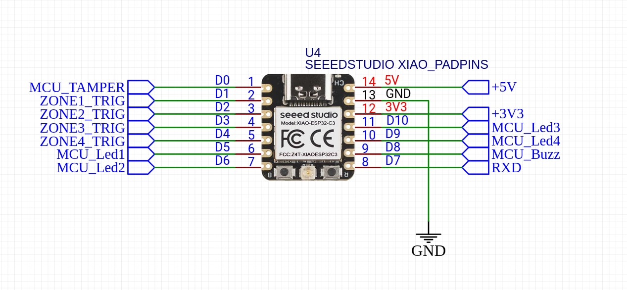

My crude design was largely inspired by the Seeed Studio XIAO series of modules. These tiny boards provide the powerful “brains” (you have a choice of ESP32, nRF and MG24 MCU’s) and offer a wide range of wireless options. They also offer great flexibility thanks to their common pinout. With only minor adjustments, the same board concept could easily be adapted for other microcontroller ecosystems, such as boards using the Feather footprint.
I called it a universal transmitter node because it acts as a hardware bridge between traditional alarm sensors and your home router (for cloud connectivity) or home automation system (take your pick on wireless communications protocol). Almost any dry-contact or open-drain sensor can be connected, along with serial encoded wired data transmission. Instead of producing a simple alarm signal, you can program the node to transmit structured sensor data using whatever wireless protocol you prefer.
The objective was to create a node capable of interfacing with up to four existing hard-wired, open-drain off-the-shelf sensors, such as PIR (passive infrared) motion detectors. The aim was to simply convert open drain to digital logic, apply some “smarts” with MCU algorithms and transmit via a standard wireless protocol. The node essentially provides a clean abstraction layer that can feed almost any smart-home or automation platform.
This design is still very much a work in progress and full of beginner mistakes. It was my first attempt at optimizing a well-trodden circuit for robustness and cost, and there are almost certainly mistakes. By sharing the design early, I'm hoping to draw out alternative ideas and refinements from the community.

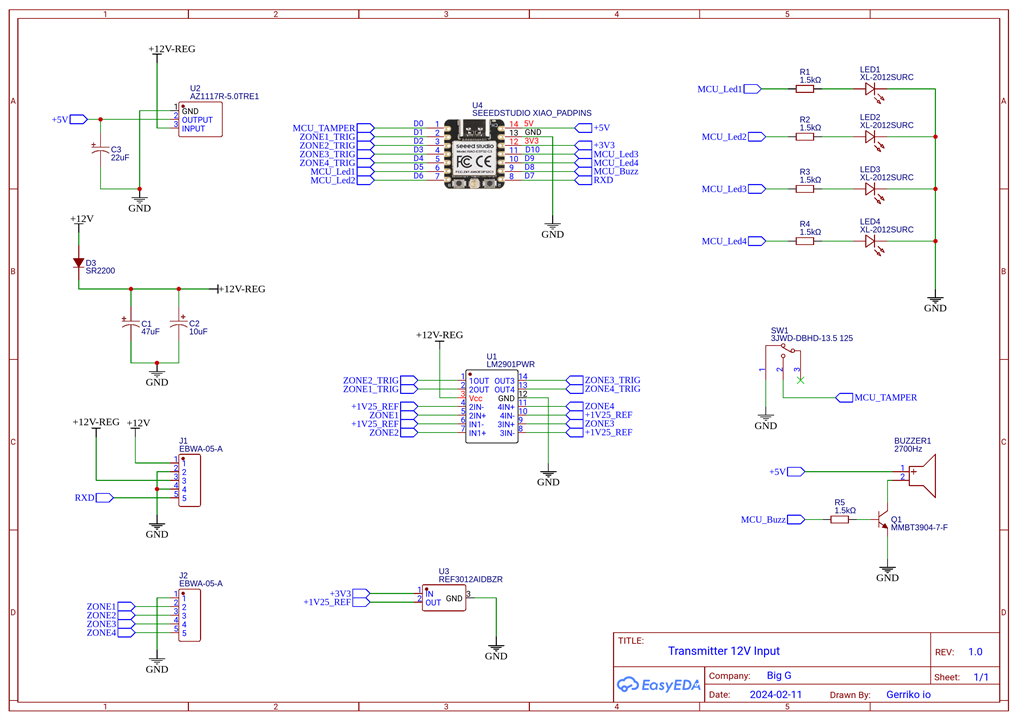

The board is made up of the following features:
  • A 12V to 5V DC-DC Converter - most home security systems work off 12V hence the target input voltage
  • Polarity protection to ensure that the output voltage is also not reversed.
  • Open drain to digital signal conversion
  • Tamper switch to notify if board enclosure opened
  • Buzzer for local audible notification
  • LED’s for local HMI (human-machine interface)
  • Screw terminals for I/O interface
  • Microcontroller - in this case a Seeed Studio Xiao dev-board.
My primary goal was to keep it low cost and to keep it simple. In terms of design decisions these were the key ones I made.
For the 12V to 5V DC-DC power conversion, a common 1117 (“jelly bean”) voltage regulator was selected. It’s been around for awhile and it’s a popular choice - they’re widely used on dev boards such as esp8266’s, esp32’s, and the Arduino UNO and Mega 2560 platforms. These Low-Dropout (LDO) regulators provide 800mA up to 1A, which makes it suitable for modern microcontrollers like those on the Xiao dev boards. What makes this attractive is that at a minimum it only requires two additional capacitors.
Naturally, I acknowledge the existence of more power-efficient and thermally superior alternatives (e.g. TI TPS542025DDCR). Therefore, I would be curious to know what others would have chosen for this design.
The next key design decision was determining how best to convert an open drain output from the sensor/detector to a digital input signal for the MCU.
Here I went for another “jelly bean” low cost component, namely a LM2901 quad channel comparator. This open-collector comparator allows input voltages much higher than its own supply rail, so it potentially could be powered using 5V or 3V3 while the input signal could be 12V. As you can see from the schematic, I powered the LM2901 using a 12V supply too.
In hindsight I think over complicated matters by using a separate voltage reference (1.25V) for the negative input voltage. I should probably have just used a voltage divider instead. What would you do?
As an alternative design, I did consider using a quad opto-isolator, such as the Lite-On LTV-847S (or equivalent) but then got bogged down with all the power and current calculations.
As such, I would be curious to know what others would have chosen for this design.
To help with your evaluation, here is the schematic and PCB design:
{gallery:autoplay=false}Board Design
The obvious mistake I made on this board was with the Tamper switch. The idea was simple. Apply an INPUT_PULLUP on MCU_TAMPER input and measure when it goes to 0V. However, it didn’t work. I am sure you can explain why and I am curious to know what you’d do differently.
I then added a buzzer and LED’s to handle the onboard UI. The active buzzer can be powered with 3V up to 7V DC. It has a built-in driving circuit which produces 80dB output at 2.7kHz resonant frequency, and consumes up to 30mA when active.
There was one oversight on my part. I forgot to add a flyback diode to protect the circuit from the electromagnetic transducer back-EMF spike. Maybe it’s overkill considering I have a MMBT3904 transistor driving the load. What are your opinions on this matter?
Then there is one todo on my part. The RX channel does not include any level shifting, which means that it needs to be at a 3V3 logic level.
There are a number of design choices to consider if I wanted the logic level to be at 12V, for example. But as I have not researched this part as yet, I am open to suggestions.
For example, do I use something like a MAX3232E device, which according to the datasheet, consists of two line drivers, two-line receivers, and a dual charge-pump circuit
with ±15-kV IEC ESD protection pin to pin (serial-port connection pins, including GND). Maybe this option only helps with RS232. Maybe it’s overkill.
Or do I follow Sparkfun's bipolar transistor based design? I have used this before and it worked great.
Or would a bidirectional/unidirectional voltage-level translator work. It’s my assumption that there’s not much available if the logic level voltage is greater than 5.5V and most unidirectional options are TTL to CMOS or CMOS to CMOS only. Thoughts?

Looking at the schematic, we can see that the tamper switch is tied to D0 (Arduino), which is GPIO1 for Zephyr. The four zone inputs are tied to D1 through to D4. The LED outputs are connected to D5, D6, D10 and D9. Finally buzzer is using D8.
To help figure out the Zephyr GPIO’s we could use the xiao_d: connector GPIO mapping as defined in “seeed_xiao_connector.dtsi”, or as I prefer, I use this file as my reference when determine the Zephyr GPIO pin numbers.

    BigG 8 months ago in reply to DAB
    Indeed. The intention is a "a design-thinking warm-up exercise", so can't make it too easy Grin. Anyway, I've learnt over the years that if I ask 100 engineers questions like these I'm very likely to get 100 different opinions Relaxed. Just what I'm hoping to see.
    DAB 8 months ago
    Interesting post.
    Most of the questions you pose do not have simple answers.
    In circuit design, decisions are usually based on the needs of the end product requirements.
