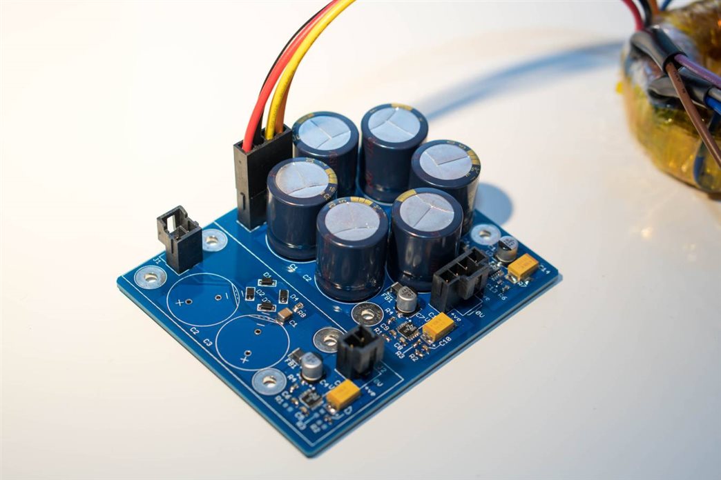

The photo here shows the dual rail portion of the board completed (the single rail part of the board is essentially just a duplicate of half of the dual-rail portion, and is not fully soldered in the photo below). Having three rails could be useful for combined analog/digital projects where (say) a +5V supply is needed for a microcontroller, but also +/-15V is needed for the analog portion. The separate single rail supply is isolated, to help keep any microcontroller noise away from the analog circuitry.

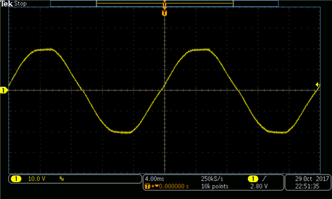

The output from the mains transformer is shown here:
The flattened top and bottom is normal; the mains supply is not always a perfect sine wave, and the transformer may be introducing some harmonics too.

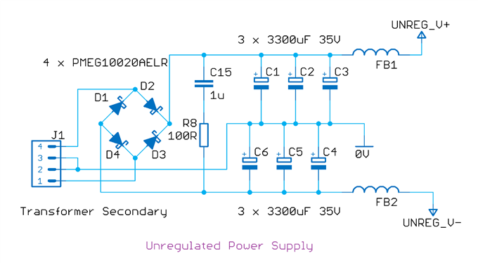

The output from the mains transformer is rectified and then any diode switching noise is filtered and the rectified output is also filtered using the large electrolytic capacitors to leave a DC waveform. Any high frequency noise is reduced using ferrite beads, which present a high resistance to such noise content.

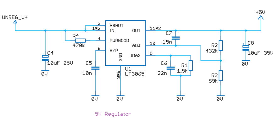

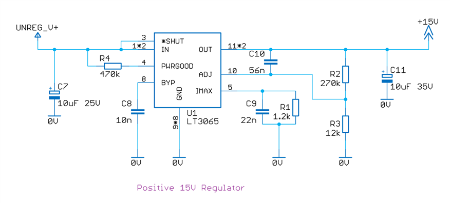

The positive unregulated output from the circuit above goes to the positive linear regulator. This circuit is based around an LT3065 integrated circuit. The datasheet was followed. The voltage is set using a couple of resistors, but if you wish to make changes then please consult the datasheet because some other part values (such as capacitor C10 in the diagram below) also need to be adjusted if the desired voltage is changed.
Note that the output voltage with the values shown is actually 14V, not 15V. The output current is set to 250mA maximum.

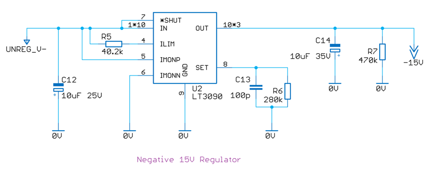

The negative unregulated output from the bridge rectifier is fed to a LT3090 based circuit. Again the datasheet was closely followed. The output is -14V (250mA max) with the values indicated.

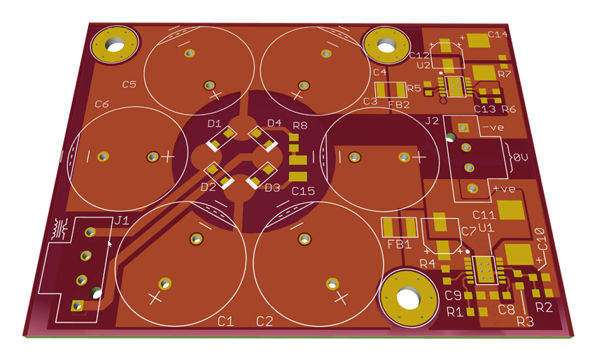

The render here shows what the PCB looks like for the dual rail design. The transformer output is connected on the left side.
The circular arrangement was originally intended to allow screwing directly over the center of the toroidal transformer for a very small footprint supply block, but toward the end of the PCB design layout I decided to just fit it alongside the transformer with screw holes on the corners of the PCB instead. The top half of this design implements the negative supply rail, and the bottom half implements the positive supply rail.
The single rail output PCB design is near-identical to the bottom half of the dual-rail PCB design.
The CAD files are attached to the blog post, they can be sent to any PCB manufacturer. Once the boards arrive, the first task is to solder the linear regulator integrated circuits. They have an exposed pad on the underside; one procedure on how to solder underside pads using a normal soldering iron is shown here.
After they have been soldered, continue soldering the smallest parts and end with the largest, i.e. the electrolytic capacitors and the connectors.

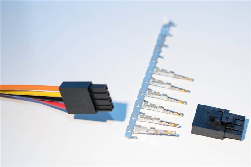

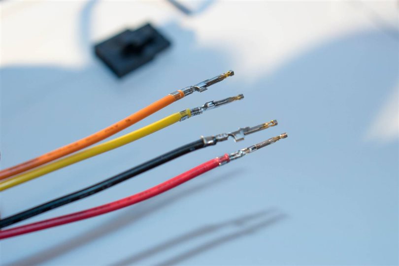

Molex Ultra-Fit connectors were used for the transformer secondary wires. A low-cost PA-09 crimp tool was used.
When inserting the crimped ends into the plastic shell, orient the crimp such that the side of the crimp that was open is facing upwards, if the clip side of the plastic shell is also facing upwards. The photo below shows the correct orientation of the metal crimps in the center of the photo, open side facing upwards, to match the orientation of the plastic shell on the right side of the photo, which has its clip facing upwards.

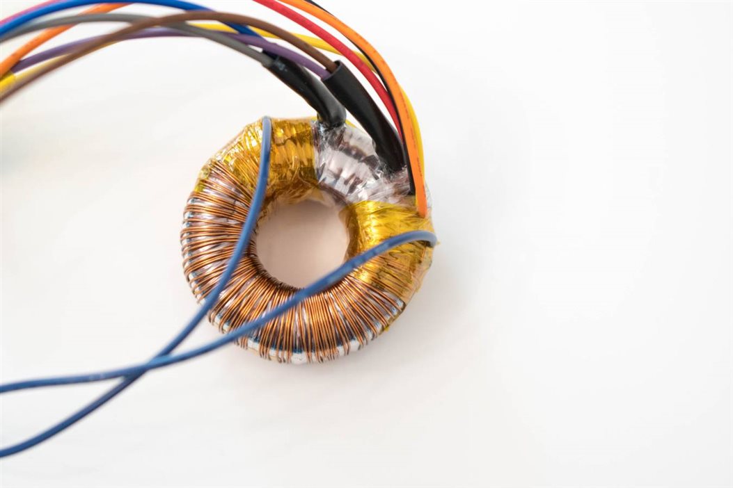

Getting a Third, Isolated Rail
In order to get the third rail to be fully isolated, one could use another transformer. However, it is more practical to use the same transformer and add another winding.
Note: The information in this section is explicitly for the specific 15VA 2x12V transformer15VA 2x12V transformer from Farnell, and is only appropriate if the dual rails set for +/-15V or lower, at up to 250mA on each rail, and if the third rail is set to be at +5V at up to 200mA.
The information will not apply to any other model transformer, even if the ratings appear identical. This also applies to all other materials (such as the wires and tape) mentioned in this section. Only the part numbers specified must be used, and they must come from a traceable source. There is a very high risk of damage or electrocution or fire if this is not followed.
Also, please use responsible mains wiring, not bad mains wiring as often seen.
The steps are extremely simple, there is not much that can go wrong, provided you use the correct, identical materials and follow the procedures. The actual mains wiring and final assembly will not be described in this blog post, it will come in part 2. This blog post will only describe how to obtain the extra supply rail using the transformer.
There are four main steps.

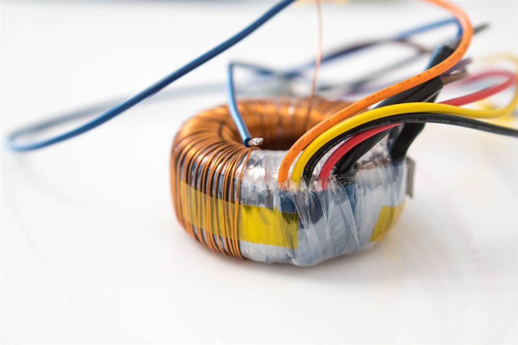

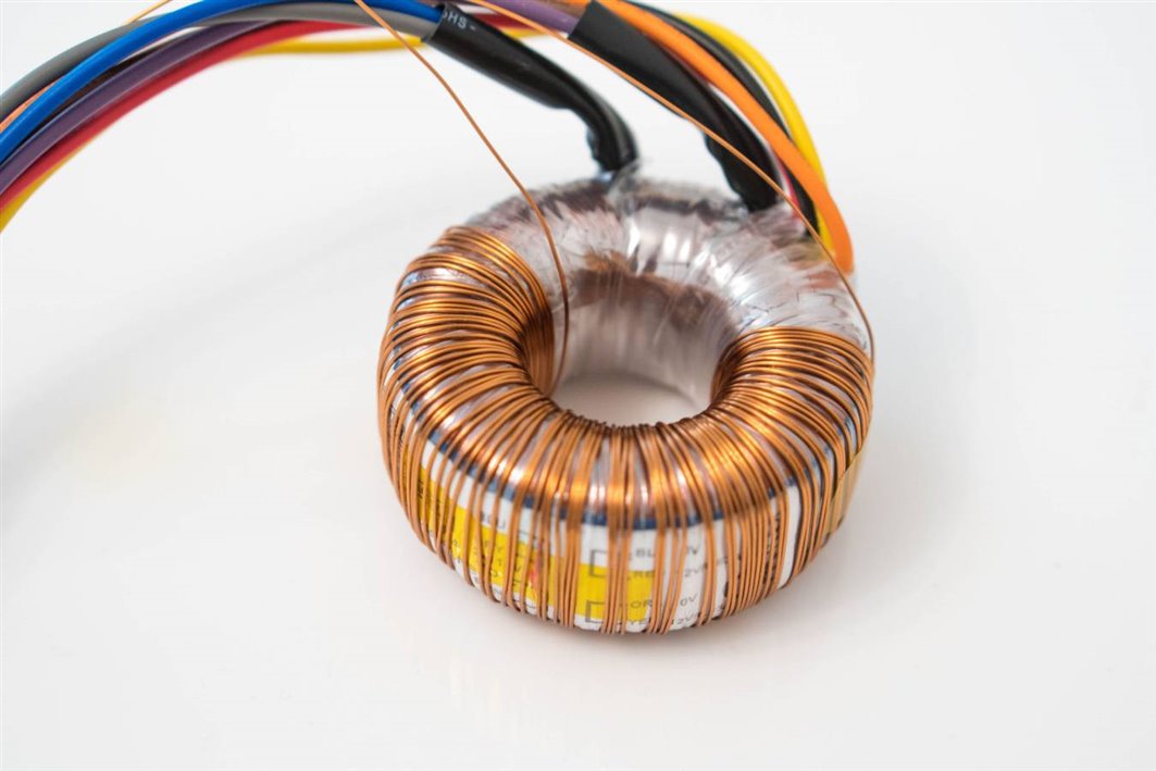

Step 1: Winding the Enamelled Wire
Take a 7 metre length of 180 degrees C rated 24 or 25 AWG enamelled copper wire, and wind 82 turns of it around the transformer. To do this, it is easier to start in the middle, at 3.5 metres into the wire, and wind 41 turns from each 3.5 metre length. One turn is basically one pass through the center of the transformer. Once you’re done, it should look like the photo below:

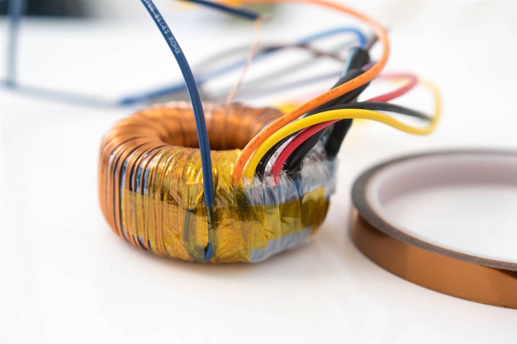

Step 2: Attaching the PVC Wire Leads
Use a small piece of Kapton tape (if you've not used it before, it is a very heat tolerant adhesive tape that can be used as an insulating layer) to hold the first and last windings in place, and then attach PVC insulated wires to the ends. This process will involve scraping off the enamel (use a small piece of sand paper or the edge of a blade). The photo here shows a blue PVC insulated wire soldered onto the enamelled copper wire. The insulated wire must be 22AWG, 105 degrees C rated.
Step 3: Securing the Wire Leads
Bend back the enamelled wire and place some tape across the blue wire, and then fold over the blue wire into a ‘U’ shape and secure it with more Kapton tape, such that there is some strain relief. The Kapton tape is placed across the wire, but also another piece is taped through the transformer, on both sides of the blue wire, so that it is held in place securely. The result of this should look like in the photo below:
Here is the birds eye view of it all so far; you can see the Kapton tape has been wrapped through the transformer, on both sides of the blue wire, for both ends of the winding:

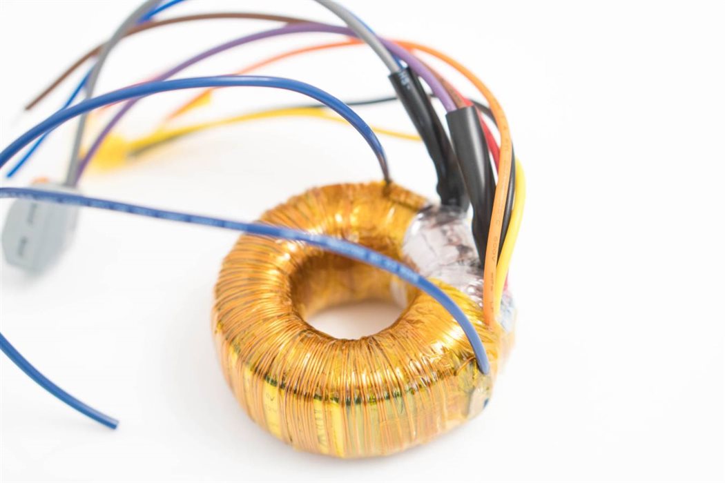

Step 4: Insulating the Winding
Wind Kapton tape around the transformer, to cover all of the enamelled copper wire. This won’t be possible with a single long length of Kapton tape, so you’ll have to do it with shorter (say 30cm) lengths. Start at the other side of the blue wire, so that at least 10mm prior to the enamelled copper wire is covered, and overlap the Kapton tape by half of its width, so that by the time the tape has been wound around to the other end blue wire (and cover a further 10mm), there is effectively a double-layer thickness of Kapton tape everywhere over the 5V winding, due to the overlap. It will look like the photo below:
That’s it! Now you have a transformer with an additional winding suitable for providing the +5V rail.
In summary the modifications listed have made the transformer suitable for providing the +/-15V rails at up to 250mA, and +5V at 200mA. This capability should be sufficient for many of the projects mentioned in the introduction!

R1 1.2k 0603 Resistor(sets the current limit to 250mA  CR0603-FX-1201ELFCR0603-FX-1201ELF Farnell 2333528
R2 270k  1% 0603 Resistor (sets the output voltage to 14V) ERJ3EKF2703V Farnell 2303262
R3 12k   1% 0603 Resistor (sets the output voltage to 14V) CR0603-FX-1202ELF Farnell 2333583
R4 470k 0603 Resistor  CR0603-FX-4703ELFCR0603-FX-4703ELF Farnell 2333613
U1 LT3065EMSE or LT3065IMSE  Farnell 2396654 LDO Positive Voltage Regulator

  • michaelkellett
    michaelkellett over 8 years ago
    Hello Shabaz,
    Thanks for going to th trouble of posting all this.
    I have two questions,
    1) what is R8, C15 path for ?
    2) why schottky diodes in the rectifier, I've always felt that they are less rugged than simple low speed rectifier diodes and more likely to cause hf problems - although now I think about it I haven't got any hard evidence to prove it.
