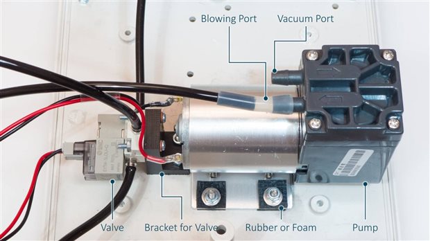

The pump has two ports, one for suction (vacuum) and the other for blowing. Such pumps are likely also used for aerating small fish tanks so that could be an option too although I didn’t open one to confirm. Both the suction and blowing ports are used in this project. Diaphragm pumps make a noise but could be placed under the desk (with a remote LCD screen) if it got irritating at ear level. Some attempts were made to minimise vibration being transmitted in the mounting of the pump, and the sound was significantly reduced but more could be done in this area. It makes far less noise than my hot air tool but this tool needs to be used for hours on end. The noise is diminished immensely by placing it on a rug, so I need to spend more time investigating pump mounting methods.
If two users sitting nearby required vacuum tweezers (i.e. to assemble PCBs simultaneously) then the cost and the overall noise level can be further reduced by using a ‘double head’ pump rather than constructing two units. I went with a single head pump for now but the project could be extended into a double unit if later desired.

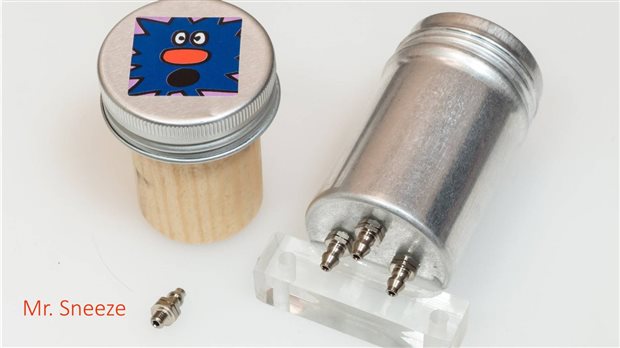

To control the air flow a valve was used; this has three ports and much like a single pole double throw (SPDT) switch the valve will connect one of two tubing connections to a third connection under control of an electrical signal. The particular valve used will block the first tubing connection when the valve is activated.
In theory this sounds straightforward but in practice the blowing port on the pump won’t have any air flow when the vacuum port is blocked. For the vacuum pen attachment, we want to be able to switch from ‘suck’ to ‘blow’. A sustained blow operation is unwanted, since that would blow away the components. Instead what was tried was a short controlled burst of air. To achieve that, a small reservoir was constructed which gets pumped up (i.e. increasing pressure) during the component picking vacuum (suck) cycle. It was named Mr. Sneeze. When the valve switches to blow mode, the pressure built up in Mr. Sneeze is used to eject the component from the end of the vacuum tweezers.
Without doing calculations I resorted to trial-and-error to establish the reservoir size. I accidentally over-sized it (by about 500%!) by using the nearest container at hand (an aluminium can with airtight screw-cap) which was about the size of a C sized battery and so I then filled the inside with a piece of wood dowel (painted in PVA to prevent wood fibre getting inside the pneumatics) to resize to an appropriate reservoir air volume; this was easier than scrapping it and finding a smaller container. If I was building it again I would just use a smaller container.
To control the pressure a regulator is used. Even without the regulator anything bad is unlikely to happen (the low cost pump will probably leak and the tubing will pop off if there was any extreme pressure build-up) but the regulator is inexpensive to add and provides more control over the behaviour when releasing components from the vacuum.

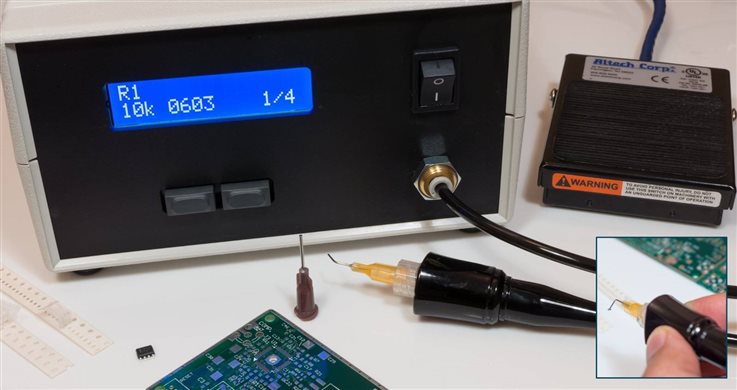

To operate the valve a foot-switch is used. The switch is wired to a FRDM-KL25ZFRDM-KL25Z board so the microcontroller has ultimate control The  FRDM-KL25ZFRDM-KL25Z has an on-board USB interface Software was written so that whenever the switch is double or triple pressed a message is sent over the USB interface(the  FRDM-KL25ZFRDM-KL25Z looks like a USB UART to the connected PC
When a double- or triple-press message event occurs, appropriate PC software will then send the ASCII encoded text to display on the on-board LCD. The reason for this is to increase user efficiency; the conveniently-placed LCD display can be used to indicate the component reference and value for the next part that needs to be picked and placed. Once the part has been placed the user can perform a double-press on the foot-switch to advance the display onto the next component that needs to be placed.

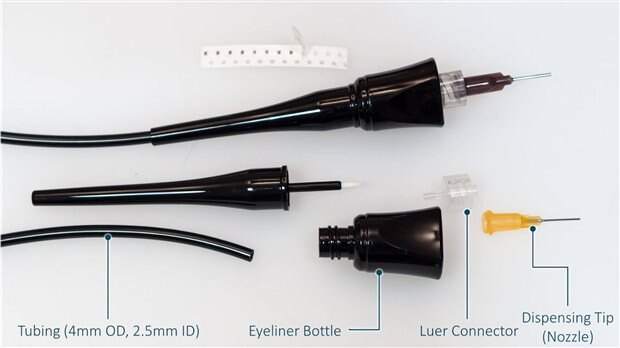

The vacuum tweezer end of the design was based around easy-to-obtain syringe dispensing tips (nozzles). They come in different colour-coded diameters. The brown one is perfect for 0603 sized parts and larger, but the yellow one is great with 0402 and 0603 parts and even some ICs. The yellow one will therefore be used the most. The tips can be swapped out quickly because they are twist-on/twist-off.
Vacuum Pen Assembly
To make the vacuum pen a plastic bottle intended for eyeliner was used. I liked it because it has two flattened sides so that if the handle is placed down and then subsequently picked up, it can very quickly be held in the same exact orientation as before, which is critical when the dispensing tip has been bent at an angle in the desire for good ergonomics. The brush end was removed with pliers and the stem was found to be hollow so all that was required was to chop the end off for the tubing to pass through. Throughout the design of this project thin 4mm tubing was used (2.5mm inside diameter).
Another benefit of the plastic bottle method is that there can be lots of room so it would be quite easy in a future upgrade to build a version with a white LED inside it (and run thin wires inside the tubing) to supply illumination. It was considered a nice-to-have feature but not essential to this first vacuum pen prototype.
An alternative approach to creating a vacuum pen could be to 3D-print it based on any custom design.
As mentioned the nozzle part of the design was based around syringe dispensing tips with a standard fitting known as a Luer fit. A Luer connector adapter was used to connect the tubing (it is a push-fit into the tubing). One end takes the tubing, and the other end allows for a Luer-compatible dispensing tip to twist on.

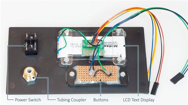

Front Panel
The front panel has the display and a few buttons. They were mounted such that they could be easily unscrewed for adjustments/repositioning. A tubing coupler was also fitted so that the vacuum tweezer pen assembly can be disconnected easily.

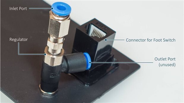

Rear Panel

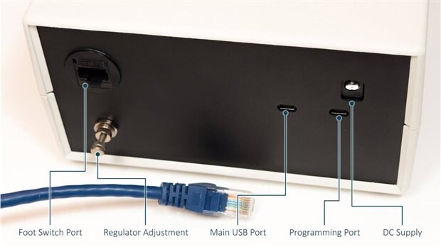

The rear panel hosts the connection to the foot switch and the adjustment screw for the pressure regulator. During first use the regulator is adjusted until the components can be easily released without flying off, and then the locking screw is used to fix the setting.
When assembled the micro-USB interfaces from the FRDM board are accessible from the rear panel.

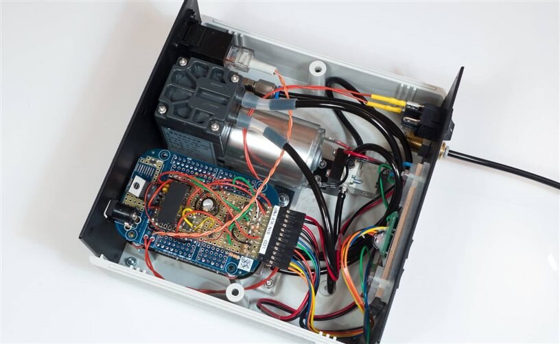

The three main components, the pump, the valve and Mr. Sneeze are screwed down to the base. For the pump, some thin foam pads were used and they helped reduce the sound. Rubber feet on the underside of the case helped too.

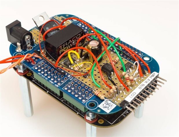

Building the circuit

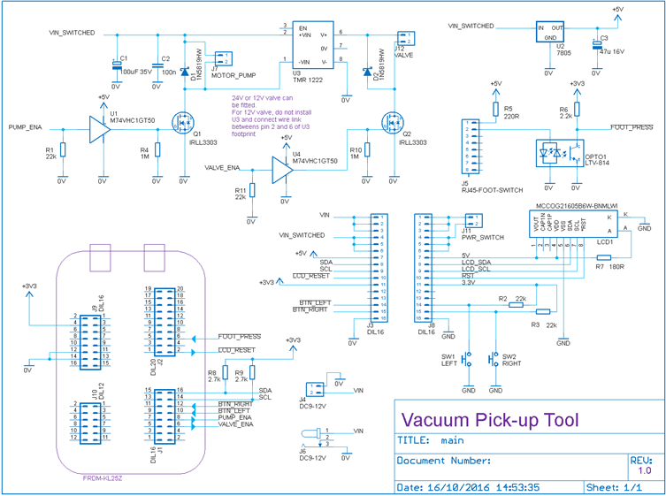

As mentioned earlier the heart of the control system is the FRDM board. Using such an off-the-shelf board simplifies the construction. The remainder circuitry was fitted onto a small shield PCB and mounted with long spacers above Mr. Sneeze to pack everything into the case easily.
For a bit of noise immunity, the design uses an optocoupler as part of the interface circuitry to the foot switch. This isn’t mandatory but I had the part and and it was convenient to use in the design.
There is also a bit of flexibility in the circuit to cater for different voltage pumps and valves to allow experimentation. The valve uses less power than the pump so I chose to use a DC-DC converter (marked U3 in the schematic) to power the valve if the voltage to the pump is lower than the valve requires. If you know precisely which pump you wish to use then the DC-DC converter is not needed (it can be replaced with a wire link) and the valve can be chosen to match the voltage of the pump.

    This is a beautiful project and well thought out. I particularly thought that Mr. Sneeze was an excellent solution to quickly equalize the negative pressure in your handpiece line. In some dental equipment I have seen high vibration motors and pumps suspended on rubber straps. Think of a small bread pan with rubber bands connected to the sides and the pump suspended inside the pan on the rubber bands. I have also seen high vibration motors suspended on coil springs with grommets and guide pins to keep the motor platform properly positioned over the springs. You may also need to go to a silicone vacuum line from the pump so that vibration isn't transferred as much through the pneumatic lines. Great build!

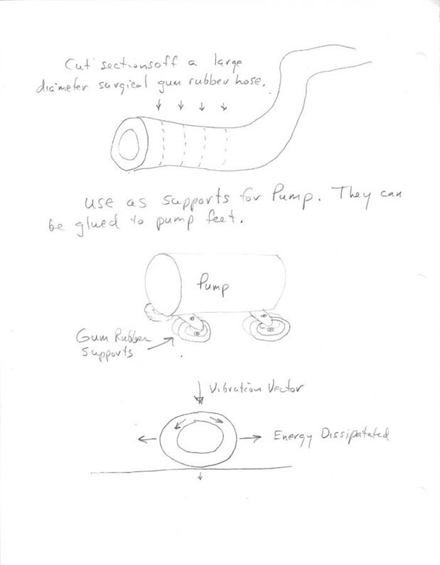

    Here is another idea for pump mounts that I have seen used that is quite effective:
    The pump's vibration is absorbed in the soft material of the gum rubber and dissipates with very little vibration being transferred into the case.

    shabaz over 9 years ago in reply to jw0752
    Hi John,
    This is such a nice idea. I've been looking around, and have some chemistry-lab-type tubing that could work. I like that I can vary the width in order to optimize it for the weight of the pump!
