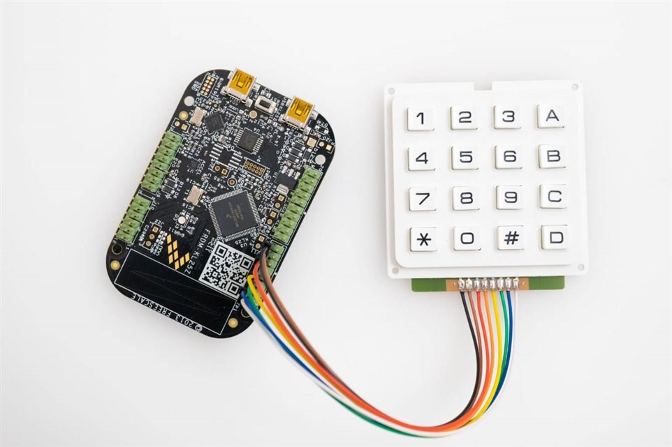

So, I took one of my favourite boards, the FRDM-KL25ZFRDM-KL25Z and set to work. This blog post will be really short because this is a very trivial project, only eight wires need soldering. This project is suitable for complete beginners.
With a small amount of DIY effort, perhaps 3D printing, I'm hoping the final result could look just as good or better than an off-the-shelf USB keypad
The project uses a 4x4 keypad4x4 keypad but it could be replaced with any switches/buttons if desired.

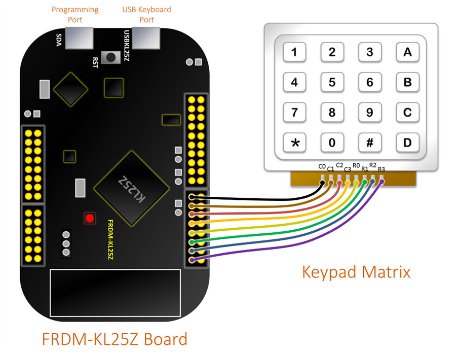

There is very little to do. I soldered some header pins onto the FRDM-KL25Z, and then wired a 4x4 keypad matrix board to the I/O pins. That’s it!
The FRDM-KL25Z board is very thin (less than 7mm) without header pins, so for a slim keypad the wires could be soldered on directly without using header pins, and the board could be mounted underneath the keypad.

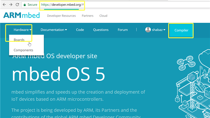

Go to developer.mbed.org and set up an account, and then in the top menu select Hardware->Boards and find the NXP FRDM-KL25Z board. Click on it to bring up an entire page about the board and then look on the right side about half-way down the web page for an orange button with the text ‘Add to your mbed Compiler’ and click on that too.

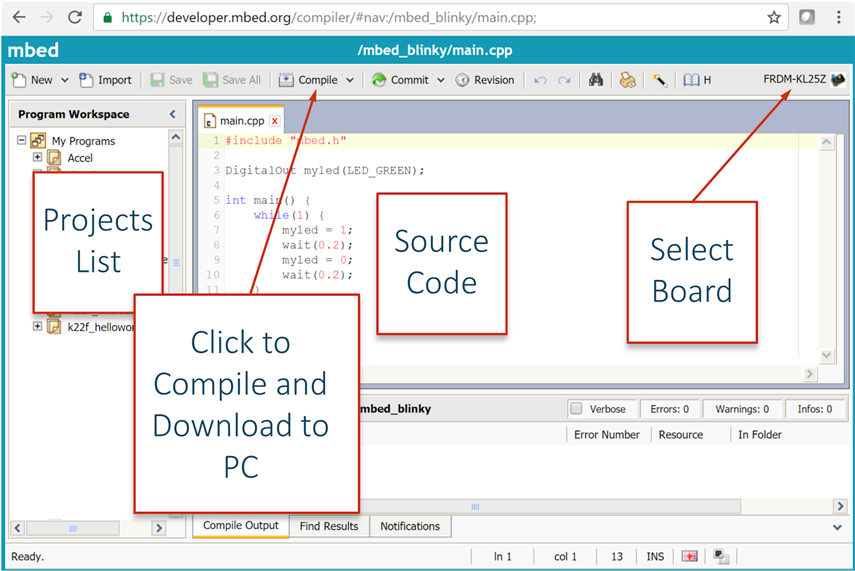

Next in the top menu select ‘Compiler’ to bring up a complete development environment in your web browser.
The development environment looks like this:
To create a new program, click on New and in the New Program pop-up window select the FRDM-KL25Z board to be the platform, leave the Template at the default (‘Blinky LED Hello World”) and change the Program Name to (say) my_usb_keyboard.
In the source code pane you’ll see a main.cpp file. Double-click on it to open it, and there will be a short program there that blinks an LED. If you click on Compile then the software will be built and automatically downloaded to your PC file system as a file called mbed_my_usb_keyboard_KL25Z.bin.
You can test it by dragging it over the USB memory if the FRDM board is plugged in. After a few seconds the software will be transferred and will automatically start running on the FRDM board. This demo program will make the RGB LED on the board blink red. The code is now in Flash memory and so unplugging and re-plugging the board into the PC will retain the code and the LED will continue to flash. Changing the program on the board is simple, just drag another file onto the USB memory file system.

Open up a text editor (e.g. Notepad on Windows) and click in it so that it has focus. Unplug the programmed FRDM board and now plug it in using the other USB socket on the board, marked USBKL25Z on the board silkscreen. This USB connector is directly connected to the programmed microcontroller, and will look like a USB keyboard to the PC when it is plugged in.
Press any button on the keypad and you should see the appropriate character appear in the text editor!
