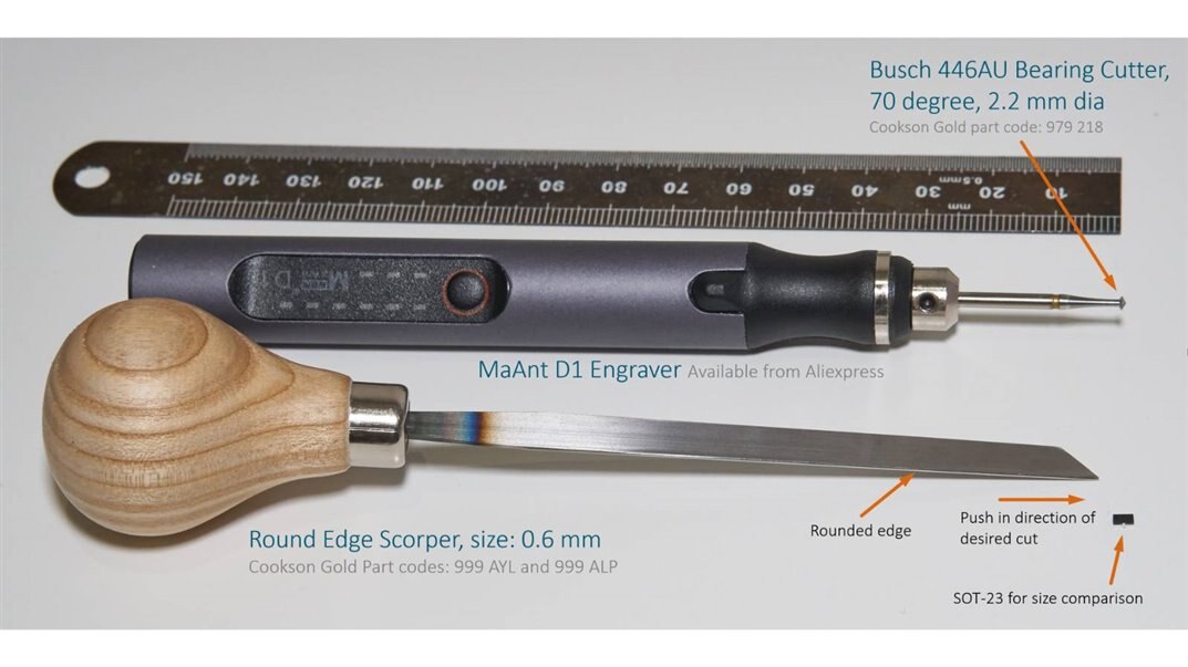

Following on from a Project14 discussion DIY 100kHz VCO - Build & Test  on copper-clad board techniques for prototyping, I was curious to know how I could improve my current method of using a craft knife to cut channels for creating isolated pads and islands on the boards. navadeepganeshu  suggested using a Perspex cutter, which I have yet to try. I also attempted to use a scriber with a ground-out channel.
I posed the question on a DIY group channel I'm part of with a few old school friends. They suggested I try an electric engraver, or a 'scorper' or 'graver' tool (these tools are used by jewellers for cutting lines and channels in metal).
So, I gave it a shot, using the tools below.
I was really surprised at the quality of the engraver - it was under $20, and seems well made. I don't know if it will last, my main concern was that the grub screws that hold the shaft of the cutter are quite small and I didn't want to over-tighten them in case the screw thread gets torn. Maybe I'm over-worrying, but I will try to find slightly longer grub screws. Aside from that, it all seems like a very neat tool.
However I think I may end up using the second tool, the scorper, a lot more, simply because it won't generate dust as the engraver will.
The 4-minute video below shows the tools in use.
Any other suggestions or ways to improve these techniques would be great to hear!
    shabaz over 3 years ago
    It's been more than a year, I figured I'd write a short update.
    The motorized tool, plus the "bearing cutter" bit have proved invaluable. The bit is extremely tiny, and it comes in handy for cutting fine traces on PCBs. The motorized tool functions really well with it. I think that was a great purchase. However, I don't use it for the original purpose, which was to cut longer lengths for prototyping.
    The scorper tool was another purchase I'm happy with. I use it with cheap FR2 board, so it is unlikely to get blunt any time soon.  I have not found any need to sharpen it, I'm using it as-is, the long length of it suits the way I hold it; still, I might ask a jeweler to grind it for me at some point (I don't trust that I will do a good job) just to see the difference.

    After your post I ordered a cheap engraver set from Amazon but it did not have the type of point that I needed. The handle however looked like what I was looking for in a handle. I found the tool steel point in my lathe cutter bin and then I used the grinder to shape the tip. I wanted to use tool steel or harder so that I wouldn't need to continually sharpen it. The most difficult part was filing the round hole of the holder to accommodate the square shape of the tool steel.
