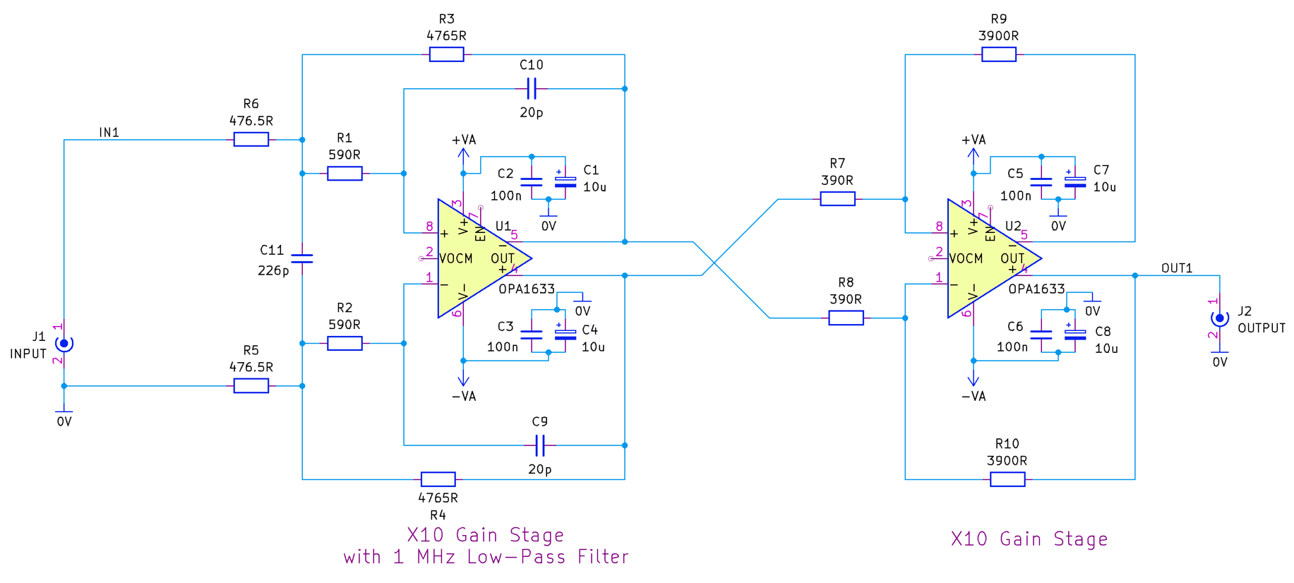

Create the Schematic
The schematic for simulation is created just as if you were creating a schematic for PCB design. You use the same component symbols. Nothing is different. Here’s my circuit (it’s actually more of a sub-circuit because I have not completed it! This is just the gain stage sub-circuit for a larger project, which will be a measurement amplifier):
As you can see, it looks like any other schematic. I used regular component symbols. A key thing is to label your inputs and outputs (press the L key to add labels). It will work without labels, but adding labels will make the signals easier to locate in the end simulation results.

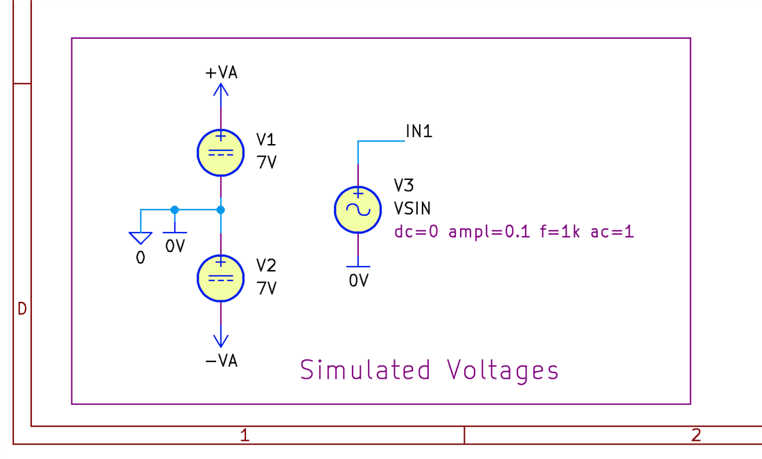

Adding Simulation Voltages
The schematic requires simulated voltages for power supplies and for stimulus. These are added into the schematic using the normal add component dialog (i.e. press ‘A’ to add a component), and using the Simulation_SPICE library.
I used the component called VDC to simulate the DC power supply. My circuit needs two power rails, so there are two VDC components, set to 7V. You’ll also need a GND component from that same library, you can see in the screenshot below how I attached it to my 0V rail.
The circuit is an amplifier, and I wanted to test with a sine wave. That requires a VSIN component.
You’ll need to set the amplitude and frequency. This is achieved by editing a string as shown below. This is a bit clunky (because it has its roots in SPICE, but deserves a proper menu). Anyway, as you can see, I’ve set an amplitude of 0.1 V, and a frequency of 1 kHz.

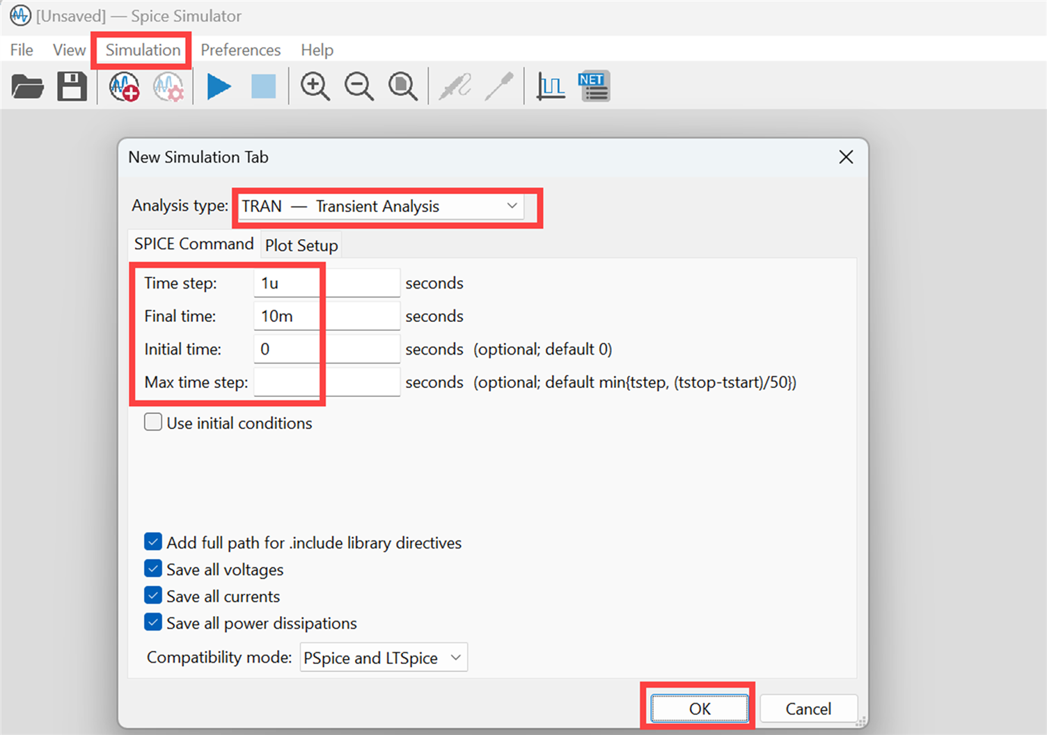

Running a Simulation
From the Schematic Editor, click on Inspect->Simulator. Next, click on Simulation->New Analysis Tab (or just press the triangular Run icon). A New Simulation window appears. The most common/basic simulation is probably Transient Analysis, TRAN, which shows an output that looks like an oscilloscope view. The screenshot below shows how it is configured. I decided that I wanted SPICE to compute an output every microsecond, for a total of 10 msec.

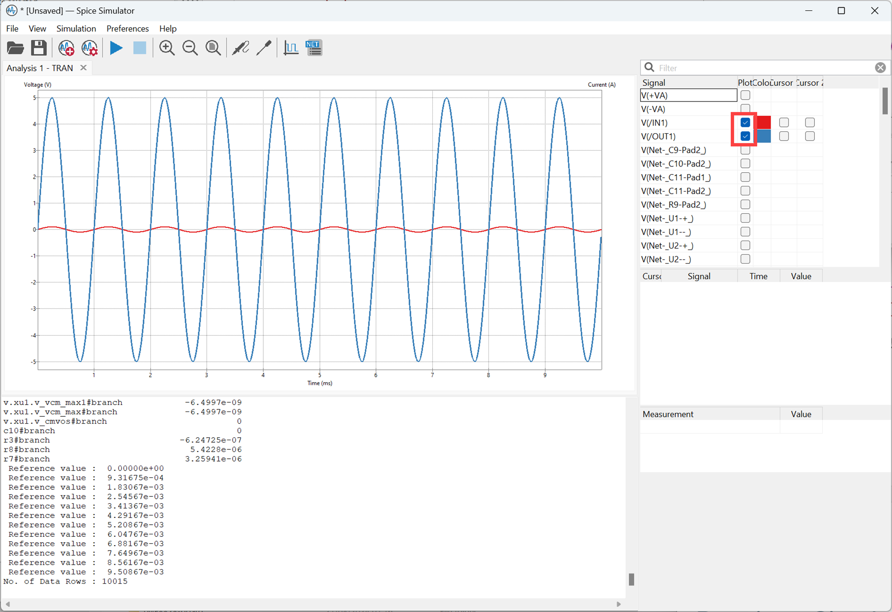

When you click on OK, the simulation will run, and a blank chart area will appear. Signals will be listed on the right. Locate in the list, the signal names corresponding to the labels that were in the schematic (I called them IN1 and IN2), they should be near the top of the list, and click in the adjacent boxes to enable the plotted output!
To improve the display, click on View->Dark Mode Plots to disable it, to make the background white (if it was originally black). Also, click on View->Show Legend to display a color key legend on the chart. The text is all quite tiny, I don’t know of a way to increase the size within KiCad.
I also don’t know of a way to enable cursors on the chart. Fortunately, it is possible to save the output in CSV format (click on File->Export Current Plot as CSV) and examine the data using other tools (such as Matlab or Python).

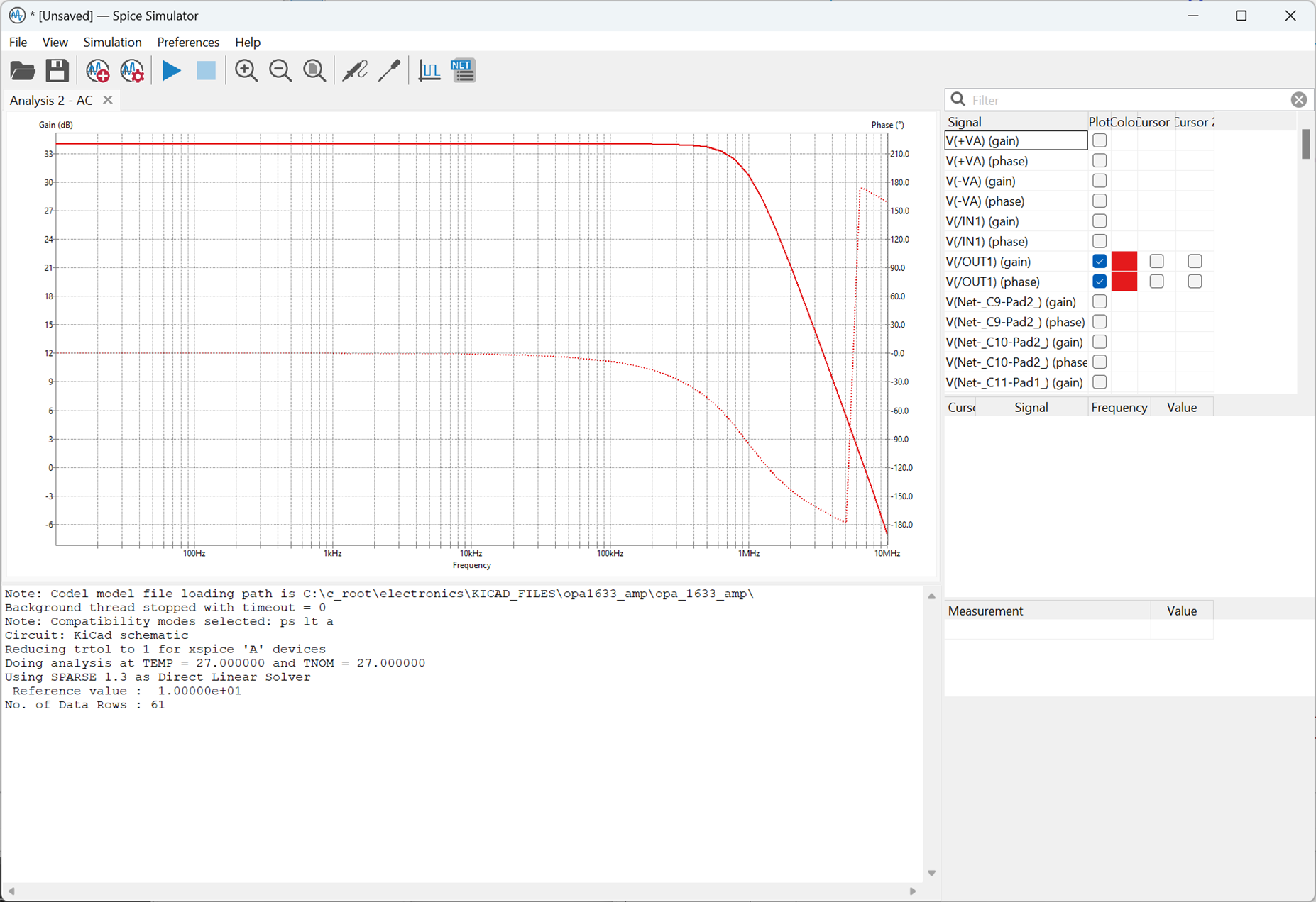

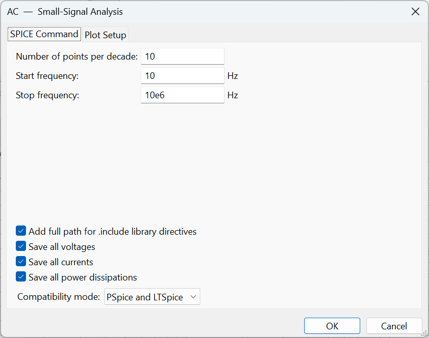

Plotting Frequency Response
The frequency response can be plotted by running a different simulation. As before, in the simulation window, click on Simulation->New Analysis Tab and this time choose AC instead of TRAN. Populate the boxes with sensible values (in the screenshot below, you can see that I was interested in the frequency response between 10 Hz and 10 MHz.
Click OK, and then click on the Run Simulation triangle. Then, select the signal of interest in the list on the right. A chart should appear!
