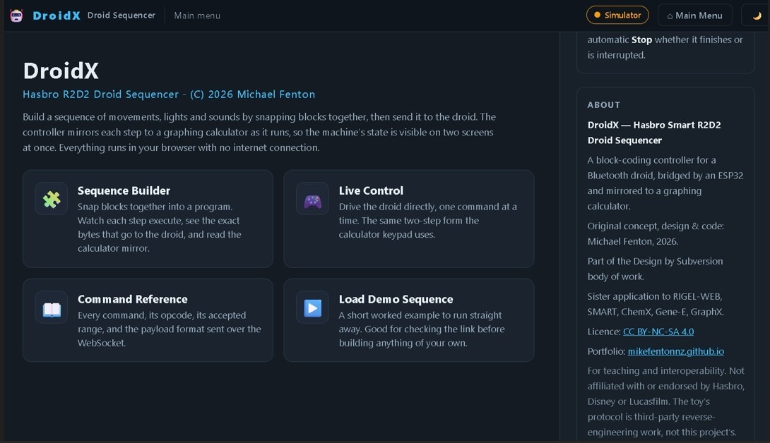

This project puts a Casio FX-9750 graphing calculator in charge of it, through the same 2.5 mm serial port and the same four-component interface circuit as every other build in this family of projects by the author. It then adds DroidX, a block-coding web page served by the ESP32 itself, so a phone or tablet can drive the droid with no app, no install, and no internet connection.

Restore phone control of your Hasbro Smart R2D2 The Casio remains a teaching tool connecting to R2D2 AT THE SAME TIME as the ESP32 serves an app to your phone, tablet or laptop webbrowser.
The calculator sends the commands. The ESP32 translates them into Bluetooth. The droid moves. And the calculator screen shows what the droid is actually doing, read back from the robot rather than assumed.
The calculator is the interesting control surface, but it is not the only one. Because the ESP32 has WiFi, it can run as its own access point and serve a page. A phone will not find the Hasbro R2D2 droid in its Bluetooth list, but it will find the ESP32 in its WiFi list. Join it, open a browser, and the controller appears.
DroidX is that page: snap blocks together into a sequence, press Run, and watch the droid execute it while the calculator mirrors each step. There is no app to install, no store, no account, and no internet connection anywhere in the chain.
[ Phone / tablet browser ]  --WiFi WebSocket-->  [ ESP32 ]  --serial-->  [ Casio screen ]
        DroidX block UI                              |
                                                     +--Bluetooth LE-->  [ droid ]
