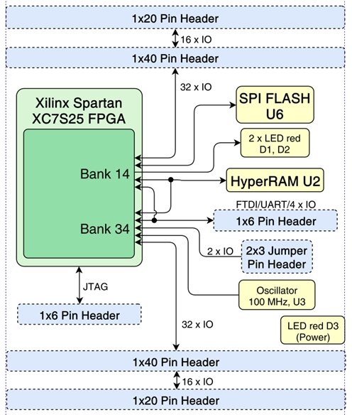

Lets take a look to the board key features:
  • Xilinx Spartan-7 XC7S25-1FTGB196C FPGA
  • Dimension: 2.7 x 5.2 cm
  • Fully Open-Source Spartan-7 Module
  • 7S25 target with 23K logic cells, 29K flops, 45 36Kb BRAMs, 80 mults.
  • Footprint compatible with 7S6, 7S15, 7S50 FTGB-196 devices
  • Devices fully supported by free "Web Pack" Vivado for Synthesis, Place + Route
  • Dual-pinout DIP-40 or 50mil 80 pin connectors for 32 or 64 FPGA 3.3V I/Os
  • 64 MBit Config PROM for dual-boot and/or SW code storage
  • 64 MBit HyperRAM DRAM (may be used as video frame buffer)
  • Standard 1x6 FTDI cable serial interface to Host-PCs
  • Standard 1x6 Digilent HS2 JTAG header for initial PROM programming
  • 5V supply input (4.0V-5.5V per PAM2305 spec)
