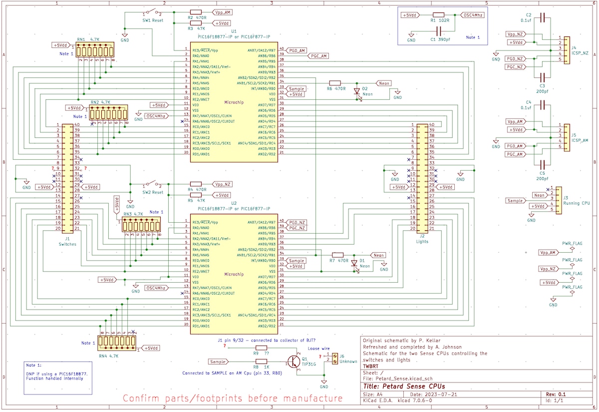

    Great video Shabaz, good tips.  I presume the bus has to be continuous, i.e. I couldn't draw a bus around my driver and then a bus elsewhere on the schematic by the LCD - the buses have to be joined?
    I'm sure a bus or two would help declutter this:

    Hi Andrew,
    The layout looks great, even without buses! Really nicely organized!
    It's possible to have the same bus name drawn as a separate segment, e.g. if you need to reuse the bus on different locations of the sheet, and it will still connect the signals.
