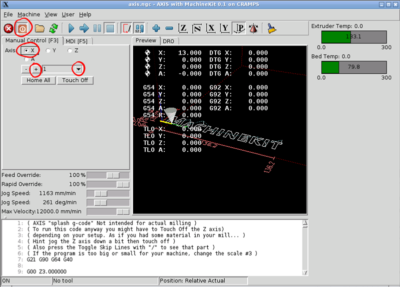

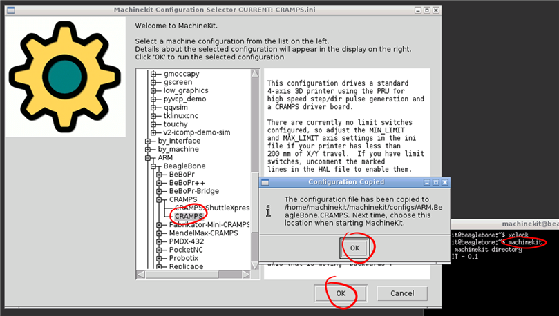

To control the interface cards, PCs have a wider choice of software, and popular choices are Mach 3 and LinuxCNC. For the BBB, the software all the boards seem to use is called Machinekit, which is a fork of LinuxCNC.
Using it for BBB is not documented well unfortunately. When I first started looking a while back, it was hard to tell which information works, and which information is old. I wanted to automate a simple XY table I'd bought.
However, there is a fairly recent blog article with useful pointers.  It too discusses that information is spread out.

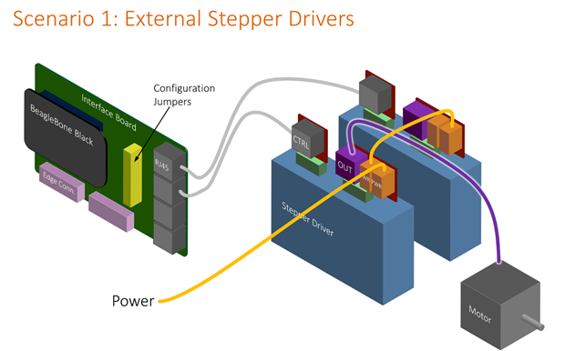

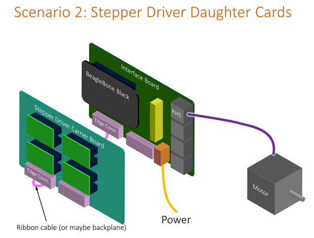

After some initial thinking, these sketches were a couple of ideas: They are based around the thought that the BBB could be a plug-on daughter card on a larger interface board, that uses something like RJ45-style connectors (because it would be nice to use off-the-shelf cables where possible, to reduce wiring effort, otherwise there are a lot of wires to connect).
After some further discussions with balearicdynamics, it was suggested that scenario 1 could be more practical since it can handle more motors (low power and high power). I too like that idea, since it is one less board to make.
Edge connectors or some other connection location could still be left on the board, for those who do want to have a custom board for add-ons (e.g. to control a 3D printer instead, where they may need outputs for say a heater).

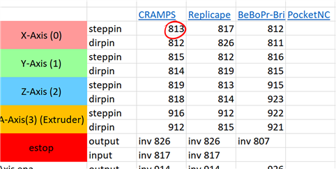

More input to any of this, including the practicality of it all, and board design (physical as well as functionality), and connector choices, is welcome. Meanwhile, I've been looking at the existing boards that are supported by Machinekit, to see what pins they use of the BBB, and why. I'll have to install Machinekit to better understand it. So far, I've looked at boards (or Machinekit configs) called CRAMPS, Replicape, and BeBoPr-Bridge and all use different pin mappings. I need to figure out which of these configs are using the PRU, and if so, which pins to allocate for that. I like the CRAMPS pin mapping so far, because it avoids eMMC and HDMI clashes (the BBB has these brought out to its connectors, and some interface boards tend to use these, which rules out using eMMC or HDMI as a result).
The pin mappings are in text files, but not easy to compare, so I've put them in a spreadsheet, I'll attach that as soon as it is complete.
The pin mapping text files are: CRAMPS.hal,  replicape.hal, BeBoPr-Bridge.hal  (I'll look at a few more too, and put them in the spreadsheet).
The mappings are numbers like 817, which means header P8 on the BBB, pin number 17.

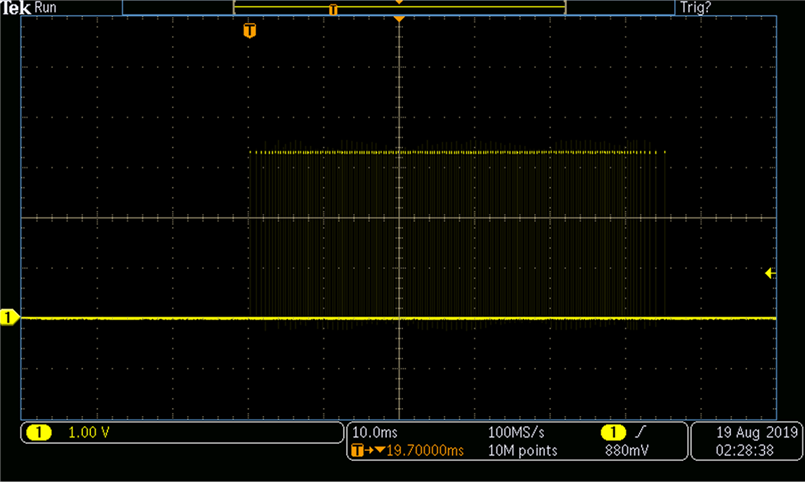

    ... some programmable real-time units (PRU) internally, and they can override some GPIO pins, for direct control without needing to go through the Linux system. So, the Linux system can push code to execute on the PRU, and the PRU will control the pins. This means high speeds, and no unexpected delays or jitter, since the PRUs are simpler devices that do not run an operating system that could have a task preempted.
    It works. I just did a proof of concept where one of the PRUs controls the motor and the only burden on Linux is to tell the PRU how many steps the motor should take, in what direction.
    BeagleBone Control Stepper Motors with PRU - Part 5: It Works
    Command buffering is part of the default functionality. You can send a number of commands and the PRU will handle them one by one.

    genebren over 7 years ago
    I would agree that scenario 1 does make the most sense.  Running lower current signal from the interface board, out to the driver, is a good idea.  That could make it possible to locate the drive closer to the motor (including the possibility of mounting it directly to the motor), thus limiting the IR losses between the driver and motor.  I also like the ability to have a common driver interface (signaling), so that different drivers could be used to match the motor being used (stepper, DC, etc).
    As far as connectors go, I do like the possibility to use RJ45 style connectors, given the ease of making cables (inexpensive connectors, mass termination, etc.).  For wiring between the motor and driver, I would like a high current option.  I have used, with good results, Phoenix Contact connectors, on some of the products that I have worked on.  They can be a bit pricey, but they are easy and quick when making connections.  Here is one of the styles that I am currently using (listed for 8A):
    The power distribution, direct to each motor, does make a lot of sense.  With the motors (and drivers?) potentially being place throughout an assembly (i.e. not necessary grouped together), the daisy chain power might be more difficult and could create excess cable length.  Direct connection also tends to be a little less noisy.

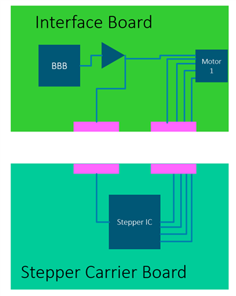

    shabaz over 7 years ago in reply to Jan Cumps
    The scenario 2 board "stepper driver carrier board" was for things along the lines of off-the-shelf stepper controller IC boards, but could be any custom board design. Especially for the reason you say, that it could be fun for some people to develop that if they preferred that over the scenario 1 individual driver modules. It will be nice to have interest and challenge areas for those who want that - and also it is hard to predict all scenarios, so a second board could be used to offload things for the future too. I'll put some ribbon cable socket on the "Interface board", to allow passing the signals to a potential second board, and another ribbon cable (or the same one) to pass the outputs back onto the Interface board, so that the output connectors are only needed on the one board basically.
    Something like this (the diagram is only showing one motor):
    In other words, the "Motor 1" connector in the diagram, optionally serves double-duty. In scenario 1, it carries low-level signals to the external individual driver modules. In scenario 2, it is directly connected to the stepper motors. But even that could be optional, i.e. if the Stepper Carrier Board is designed for higher current than 1.5A per pin (i.e. 3A if I can double them up for bipolar motors) then the stepper carrier board could use its own connectors, e.g. screw terminals.

    Just an update: Last night I tried to locate a ready-made Machinekit micro SD card image (apparently that exists) but it proved hard to find! The information sources out there are really bad.
    Then I tried to follow a blog and build my own, but the preparatory steps were not appropriate. They suggested using PREEMPT RT kernel version for real-time linux but I didn't know if it was good or not. So scouring the web there was another website that described a test to run called cyclictest (it can be installed on linux by typing apt-get install rt-tests ) , to see how much latency is being caused by the kernel. I tested that, and worst case latency (I let it run for only a few minutes, so not a thorough test) was about 350usec, which seems really long.
    Apparently 'Xenomai' is much better, allowing ten-fold improvement on BBB. That entails building the kernel, so I tried that, but I need to work on it some more, to confirm the precise kernel version and to integrate the Xenomai patches in it. If that works, then I'll install Machinekit, and see what PRU code already exists as part of it, and what pinouts are needed for that.
