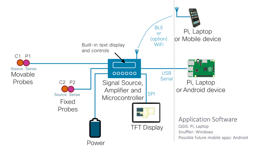

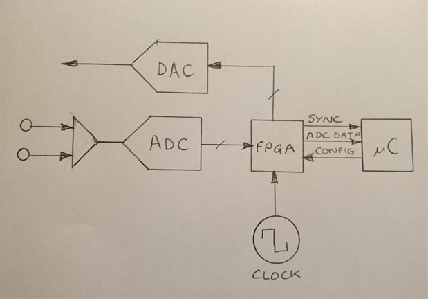

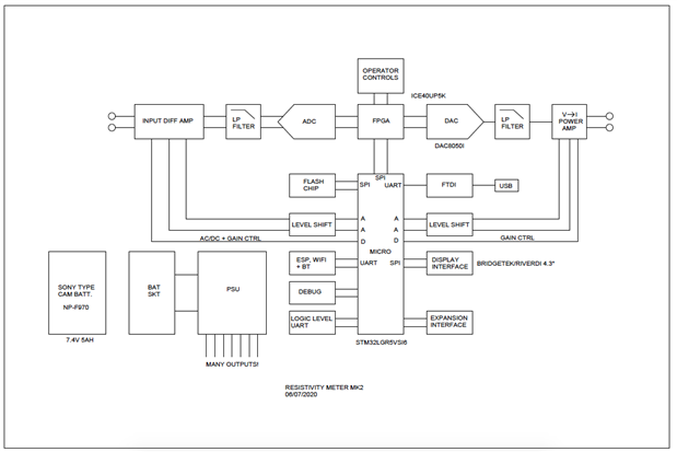

Hi I'm looking for ideas on an update to a resistivity meter for archaeology. The only published designs for diy were in 2 magazines. One was published in 1997 and the other in 2003. I have copies of both articles available. The reason behind this is the current high cost of available equipment, usually well beyond the reach of most archaeological groups. I've attached a basic block diagram. In the first magazine article the meter is very basic. It relied on the operators to write down the reading given as the survey was taken. Given that a normal survey grid is 20m x 20m and 1 reading is taken on every sq mtr there would be 400 readings to write down and then input into a program used to interpret the results. The later article is really an update to the first where a PIC has been added to record the readings. This again is prone to error, because eadings are taken manually by pressing a button.
I'm sure given the advances in electronics there must be better ways.

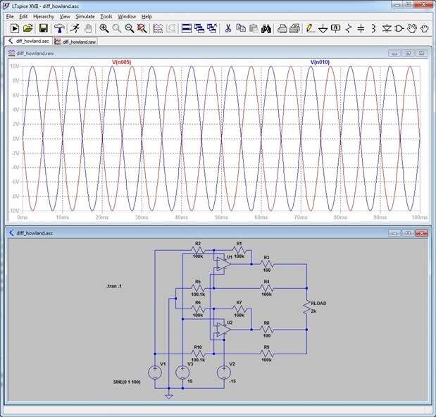

    michaelkellett over 6 years ago in reply to shabaz +7
    I can't live with that - I have to have symmetry The problem is that the Howland current pump doesn't constrain the voltage on the load at all when perfectly balanced - and my LTSpice model is unrealistically…

    AS promised - now for the phase sensitive detector. I couldn't easily model this in LTSpice, which is no great surprise because it needs multiplication and square roots. I used Simulink in MATLAB - which…

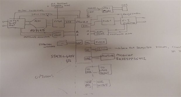

    genebren over 6 years ago
    Interesting ideas so far.  I meant to chime in earlier, but things have been pretty busy for me lately (building a deck and entertaining my Grandchildren again).
    Several years ago, I was asked to sit in with some friends of my sister that work at a geotech company.  They were looking to build impedance measurement devices for soil surveys.  I came across this amazing looking chip from Analog Devices that looked like a great way to measure impedance (including a complex component).
    Here is a snippet from the specification:
    The AD5934 is a high precision impedance converter system solution that combines an on-board frequency generator with a 12-bit, 250 kSPS, analog-to-digital converter (ADC). The frequency generator allows an external complex impedance to be excited with a known frequency. The response signal from the impedance is sampled by the on-board ADC and a discrete Fourier transform (DFT) is processed by an on-board DSP engine. The DFT algorithm returns a real (R) and imaginary (I) data-word at each output frequency.Once calibrated, the magnitude of the impedance and relative phase of the impedance at each frequency point along the sweep is easily calculated using the following two equations:Magnitude = 22IR+Phase = tan−1(I/R) A similar device, available from Analog Devices, Inc., is the AD5933, which is a 2.7 V to 5.5 V, 1 MSPS, 12-bit impedance converter, with an internal temperature sensor, available in a  16-lead SSOP.
    This might be of some help in your planning.
    Good luck and let me know if you need any help on this project.
    shabaz over 6 years ago in reply to genebren
    Hi Gene,
    It's a super-interesting chip, I was keen to use it a few years ago for plant soil purposes, and for hydroponics - to try to see if the soil or liquid has nutrients. The idea being to have a signature of known good soil or water by sweeping through the spectrum. I never got to try it though sadly, the project moved on to something else.
    It was felt that it could have had a lot of merit because then you could publish the signature, so others could try to replicate a yield (it wasn't going to be for farmers, more for home use), and to not waste nutrient. But, I have no idea in practice if the result would have been usable, or too inconsistent/variable.
    I wish I'd done some work on it at the time, since it could have been useful for other purposes too.

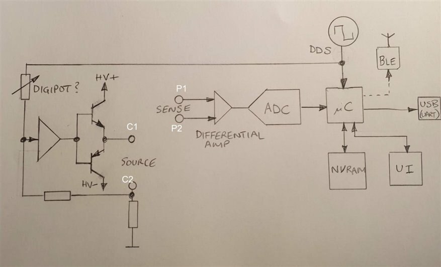

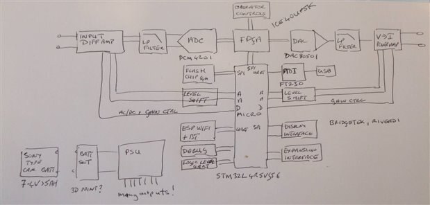

    The proposed design so far is one half of the impedance measuring system, but with digital processing. In theory it could be converted to an impedance measuring system with no additional hardware change, just a software upgrade, since the frequency will be know, and there will be some sync pulse from the FPGA, we just need to internally multiply with a 90 degree out of phase signal from that sync pulse too.

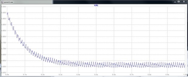

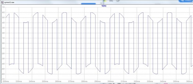

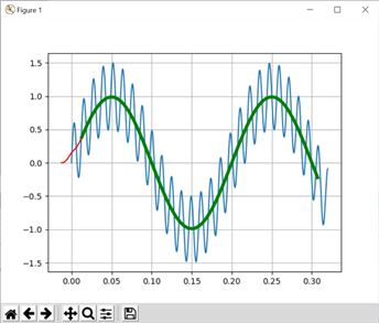

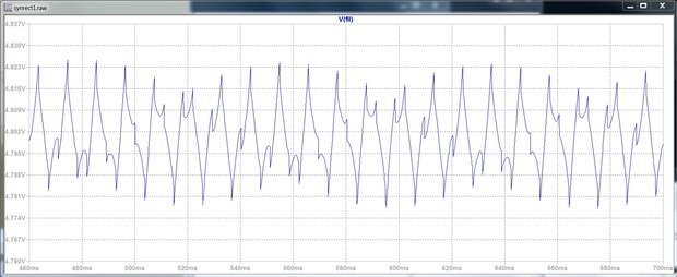

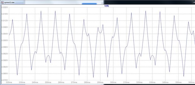

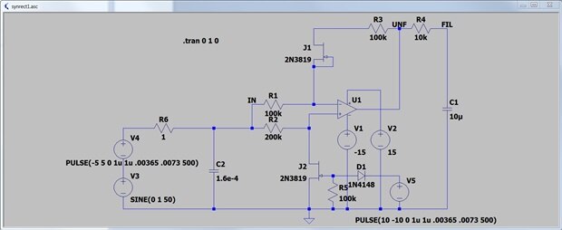

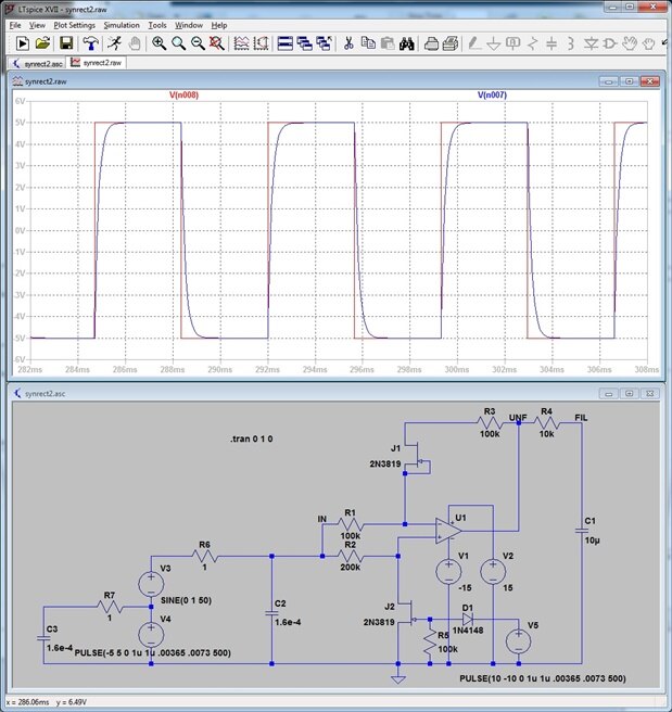

    I thought it might be helpful to followers of this thread to walk through the operation of the synchronous detector concept used in the Robert Beck design.
    This can be done with the aid of LTSpice (which is a free download from www.analog.com).
    I'll follow it up with a similar modelling of a phase sensitive detector -  which works on sine waves, and explain why any differences in results are all to the good of the PSD.

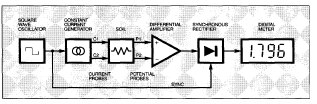

    As every one seems to agree: we are using AC because of electrolysis problems with DC, and we have to have some way of removing interference signals
    which are commonly at mains frequency and harmonics.

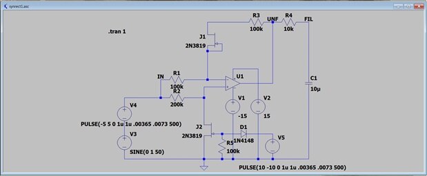

    This is a reasonable model of the key parts of the synchronous rectifier in the Beck design.
    I've given it a nice friendly input of a 1V pk sine wave at 50Hz (to represent interference) and a +/- 5V
    square wave for the signal. The signal frequency is not quite 137Hz. The node on the schematic is
    labelled IN

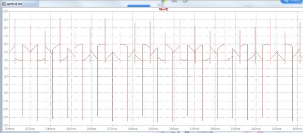

    This is the signal at UNF (for unfiltered) and is what you get once the modulator has done its work. The
    spikes are caused by the finite switching speed of the FETs and amplifier. (We'll come back to them later.)
    And final the output of the filter - on the Beck design this goes to a digital DC voltmeter and you record the reading
    by hand. Note the different scale.
    The filter has made a good job of getting rid of the AC components and the output is very close to what we would hope.
    There are some important points to note:
    1) the unfiltered signal never 'settles' because it has chopped up bits of the 50Hz interference added to it.
    2) in real life the interference signal may be larger than the wanted signal
    Synchronous detectors like this using square wave modulation work by assuming that the detector and input signal are perfectly in phase.
    What happens if the are not ?
    I added a delay of 73uS, equivalent to 3.6degrees phase error to the input signal, the output has changed by about 4%.
    The point is not that this amount of variation in timing is likely or not but that this kind of detector is sensitive to edge timing.
    Square wave signals have worse problems than that - as we know a square wave is composed of s series of sinewaves, the fundamental
    and an infinite series of odd harmonics, amplitude decreasing with frequency. The 7th harmonic has an amplitude of 14.3% of the fundamental.
    Lets put a low pass filter on the input:
    R6/C2 cuts the frequency response by 3dB at 1kHz and 6dB/octave thereafter.
    And makes for an error of nearly 10% in the output.
    I need my sleep so there isn't time to model a phase sensitive detector tonight - I'll try tomorrow but I
    may have to use MATLAB because LTSpice isn't good at maths.
    SO you can run your own experiments here's the model:

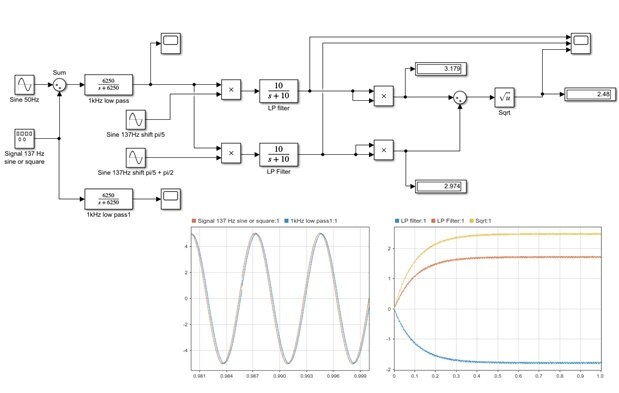

    michaelkellett over 6 years ago in reply to michaelkellett

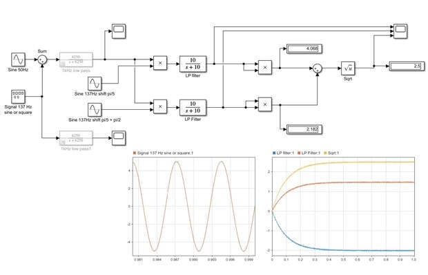

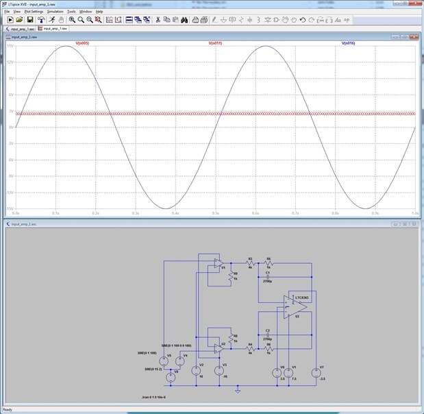

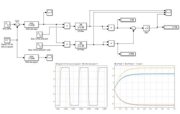

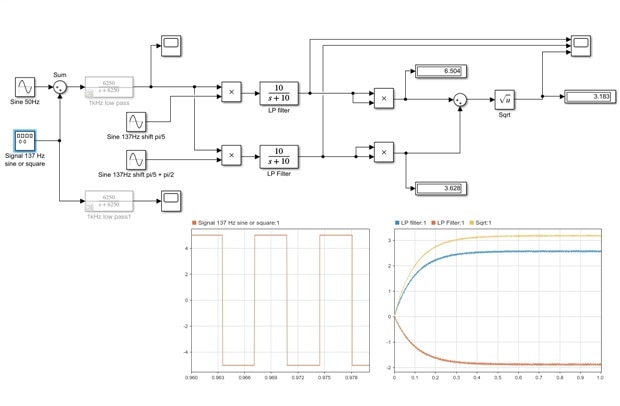

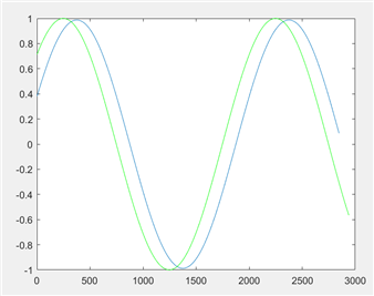

    I used Simulink in MATLAB - which is very much a paid for tool (although they do offer very good discounts to home users.)
    The model is fairly self explanatory:
    The left hand plot shows the input signal without interference added.
    The input low pass filter is disconnected.
    I've added some phase shift (pi/5 radians).
    The amplitude of the output is 3.183V
    With the filter engaged you can see that its doesn't have a huge visual effect on the signal.
    The output voltage is 3.158 so the change is 0.0785%
    This is a sine wave input with no filter, the output is 2.500 V
    This is the sine wave input with the filter, you can see that it introduces a discernible phase change.
    The output is 2.48 V so the change is 0.08%.
    So we've demonstrated that the phase sensitive detector is not affected by changes in the system bandwidth
    (except where they affect the gain at the tuned frequency).
    And it makes no difference if the excitation is a sine wave or a square wave.
    (You may be wondering why the sine wave amplitude is 2.50V and the square wave 3.183V, that's because both
    are 5V pk but the first harmonic in a square wave has an amplitude of 4/pi  * pk = 1.273,
    and 2.500 * 1.273 = 3.183
    But we saw in the previous series of simulations of the simple synchronous detector that the introduction of
    the 1kHz filter cause a 10% error in the reading.
    In the filtered square wave simulation in this post you can compare the square wave with its filtered version.
    I've added a bit the the LTSpice model of the simple synchronous detector so you can do the same thing.
    I'm hoping that by now I've convinced you that the phase sensitive detector really does work a great deal better
    being much less susceptible to out of band interference or response changes.
    To put it another way the simple detector is sensitive to the impedance of the earth up to at least 10x the nominal frequency.
    Since the PSD only detects the fundamental frequency of the excitation it is obviously a waste of power to transmit the harmonics
    it will ignore.
    So sine wave excitation and a PSD detector, all other things being equal, is less susceptible to interference, less susceptible
    to out of band changes in earth impedance and uses less power.
    What's not to like image
    MK

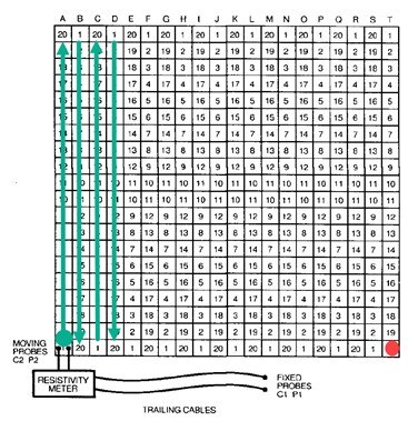

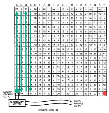

    Archaeological 'resistance' or 'resistivity' measurements are taken with fundamentally a four-probe setup. This is to reduce the effect of contact resistance (which can be up to maybe 40k and vary significantly between successive sample points) and the 'signal' which can vary by perhaps only single-digit of ohms or fractions of an ohm.
    To achieve this, there are effectively two completely electrically independent circuits. One, which injects a constant-current between two probes or electrodes (C1 and C2) which may well be >50 metres apart (in some instruments it is a constant voltage rather than constant current injected). There is then a high-input-impedance voltage measurement between probes P1 and P2.
    In a typical twin-probe archaeological survey, P1 and C1 are located in a fixed location (at least for the duration of a grid) and mobile probes (P2 and C2) affixed to a frame are traversed by the operator to take readings at known points within a grid. The spacing between the probes P2 and C2 on the frame is chosen with an eye to the likely depth of feature expected on the site; the fixed probes P1 and C1 should be at a similar distance apart. As current flows through approximately a hemisphere with C1 and C2 points on the circumference, to avoid distortion due to the changing volume beneath the measurements, it is normal that the fixed probes P1C1 are at least 30x the probe separation distant from the grid edge.
    The constant DC current is injected via a single wire core from the source in the instrument to remote injection C1, then flows via the earth (in bulk, not a skin effect) back to mobile C2 and then back to the source in the instrument box. The voltage gradient around the C probes is influenced by the underlying geology and man-made pertubation, and these changes in voltage measured at successive points (between fixed P1 and mobile P2 on the frame, via a second wire core) are what are plotted and can in due course hint at what lays beneath the soil.
    The only connection necessary between the current injection 'C' circuitry and the voltage measuring 'P' circuitry is that in some instruments the start of measurements is held-off by a pre-programmed delay from the edge of the current pulse. The DC constant current is reversed periodically to avoid polarising the material around the C probes.
    Readings start when the mobile probes complete the circuit, but care is needed as electrical contact can be made with, say, grass as the frame probes are plunged into the earth, therefore successive readings are taken, across multiple reversals, until they are sufficiently settled.
    Dave
  • michaelkellett
    michaelkellett over 6 years ago in reply to davemartin
    Well Dave, the whole point of this open source design malarky is to talk about stuff.
    There is nothing unusual or special about 4 wire measurements - any decent DMM does them.
    Our plan has addressed that from the start.
    Beck's design does not work accoridng to the general scheme you describe, we know that for sure because the ciruit is in the public domain.
    The Geoscan RM85 uses a phase sensitive detector.
    As far as I can tell all the instruments available use AC excitation, primarily to avoid electrolysis effects. A soon as you use AC
    the system is susceptible to AC interference so you need, in some way or other, a bandpass filter to allow only the excitation
    frequency to be measured.
    There are many ways this can be achieved, but two that are common are the synchronous detector (like Beck), which is fairly easy
    to implement entirely in hardware, and a sin/cos type of phase sensitive detector which is extemely difficult to implement
    in hardware but presents no problems to a hybrid design.
    The 'delay from an edge to a single sample' method that you describe offers no discrimination against interference at all. This is
    clearly shown in the second plot of my anaysis of the Beck design. If you were to average many readings taken in this way
    it would behave like a bad implementation of the classical synchronous detector but would be even more susceptible to out of band
    noise.
    However, the proposed design is flexible, so it could be programmed to operate as you suggest. If we should get to the stage of
    testing prototypes we could try it.
    In passing I should point out that neither the synchronous detector nor the phase sesnitive detector offer any suppresion of interference
    over a single cycle. They both rely on frequency shifting the inteference and using a low pass filter to remove it. The band width of the
    detector is inversely proportional  to the cut off frequency of the low pass filter, the response time of the detector is inversely proprtional to
    the band width.
    It is common with PSDs to average over a fixed number of cycles, there is a Schlumberger paper with some nice graphs of
    selectivity compared with number of samples averaged. Sorry I don't have a link to hand.
    A filter implemented in software can easily change gear, using a fast response and wider bandwidth to detect ground contact and
    then using a narrower bandwidth to take readings at the maximum accuracy.
    One of the many advantages of the sine wave excited PSD technique is that all the signal power is used, both in transmission and
    recpetion and that each reading represents the averageing together of hundreds or thousands of ADC samples thus allowing
    a very large dynamic range and low noise.
