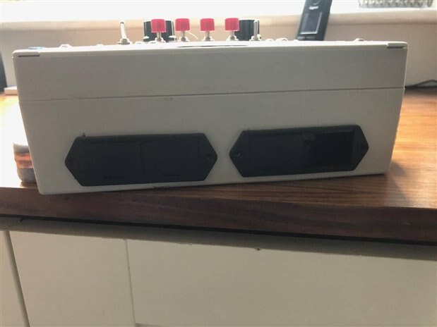

    Yes that box looks ok, just wondering if we would need to remove the batteries for charging. Is it possible to have a socket on the unit that you use for charging.
    shabaz over 6 years ago in reply to kltm
    Hi Ken,
    I think that would be a major project (maybe better as a separate project to build a charger board that accepts a power supply with plug/socket). The camera batteries are better charged with off-the-shelf external chargers, they are not expensive, and they should be safe. Otherwise, fast charging such a large battery in a sealed enclosure will have heat implications, and could be risky. There's a few other reasons too, can elaborate if needed.
    Besides, the battery will take a long time to charge (3 hours or more) so swapping out the battery is quicker (dual external chargers exist).

    michaelkellett over 6 years ago in reply to shabaz
    Certainly I think we should be able to remove the battery (or batteries), for the reasons Shabaz has suggested but also because if you run out in the field you need an instant fix.
    A charger could be added but I doubt if you would want it on the same board and it's quite a big project on it's own. I've designed a product with a single cell (1/6 of these camera things)
    and that took a lot of work to be sure of safety and performance.
    I've just discovered that no one seems to stock the ABS box (after I ordered the last one from Rapid image) but you can get the poly-carbonate one.
    I still like the idea because it gives you an openable box without a lot of work - but if we design the things sensibly people can pretty much
    use whatever box they like.

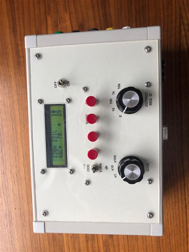

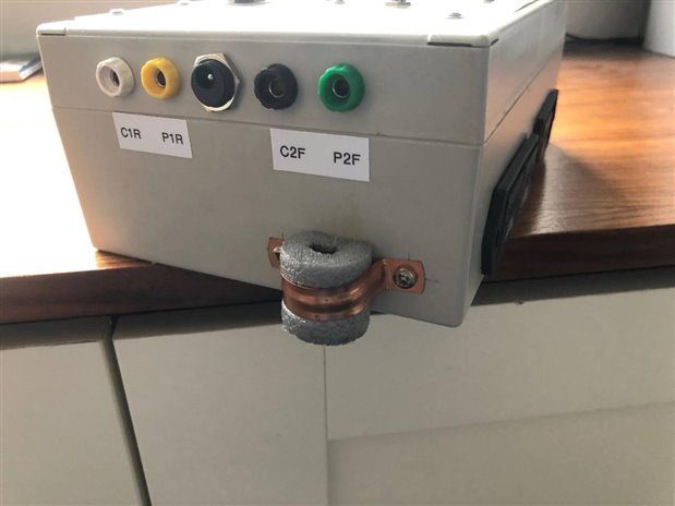

    The pic just posted is my 'home made' resistivity meter based on the magazine article. it's in a Camdenboss box 8.5" x 5.5" x 3". The rear of the box contains 4 battery drawers for rechargeable 9v batteries. On the side is the mountings to attach it. It basically slides over two pegs on a tray that is mounted on the top of the frame.imageimage

    This box is CAMDENBOSS
    CRDCG0009CRDCG0009
    It's held together with 4 screws. If you look at it online it has a seal between the lid and the box. Seems Farnell no longer stock it, but CPC do. They have 8 in stock at £9.17 in 5's.
