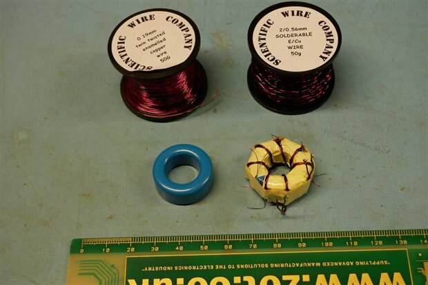

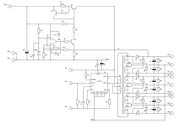

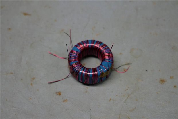

    I had some odd moments and a burst of enthusiasm to make transformers so I've done a quick test design using the LT3439 with a torroidal transformer with three secondaries and one primary (all bifilar so 8 windings altogether.)
    I've added a linear regulator with feedback from the output to control the +/- 25V supply, the others (+/12-15 and +/- 6 ish) will need their own regulators.
    I've ordered a prototype board an I'll post some results when I try it.
    36,24 and 9 turns
    6 turns
    Should have boards by Wednesday, so might have some test results next weekend.
    This is only part of the supply but I want to test it before making  a much more complex psu board with everything on.
    MK

    6 turns
    7? I'm counting every pass of the wire through the kernel. Aren't that 7 windings.
    • Vote Up +5 Vote Down
    shabaz over 6 years ago in reply to michaelkellett
    Hi Michael,
    Nice!! This is exciting. What toroid is it?
    By coincidence I was winding one today too, although tiny ones for a low-power filter in my case.
    I still get a fascination seeing the theory meet the practical result so it's nice seeing projects with custom hand-made parts like wound components : )
  • michaelkellett
    michaelkellett over 6 years ago in reply to shabaz
    It's a 26734052673405 from Farnell.
    MK
