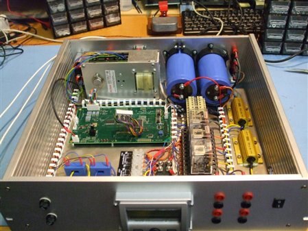

I delivered a product of mine to a customer, and they harshly critiqued my wiring of the interface box for my device. Actually the customers comments made the whole meeting uncomfortable. He wanted to return the whole system, being local, I decided to pick it up personally.
The interface box have a collection of different control boards. Each board has a ports on all 4 sides. Also, I have elaborate AC wiring in the box. I did the best to make it look good, heat-shrink tube, spiral wrap, short wires.
What are some good methods of making a pro looking wiring box? One more caviet, it has to be inexpensive.

    It's always miserable when a customer brings you up short like that - bad luck.
    It's very hard to comment without a picture - could you post one ?

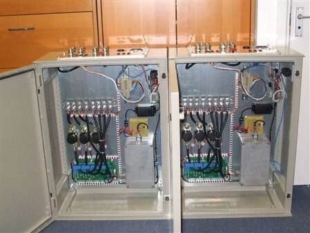

    The way most biggish one off pro-equipment is wired to look neat is by using trunking, din rail terminals where appropriate etc.
    Here are two of mine - the neat one is finished and the less neat one is being debugged so some wires have been pulled out of the trunking.
    You can buy the trunking from Farnell !

    12.5mm x 12.5mm self adhesive trunking from Farnell:
    Manufacturer:
    HELLERMANN TYTON
    Order Code:
    3178500
    Manufacturer Part No:
    B905
    I look forward to seeing your pictures.

    If your time is worth nothing or the retro look is chargeable then lacing is a reasonable solution and can look very neat and is reliable. The advantage of trunking is the ease with which additions or changes may be made later and the low skill level needed for an acceptable result. The Hellerman stuff is about £3 per meter but you can get alternatives for much less. In boxes like the two I posted the pictures of then £10 for trunking is lost in the noise - the relays in the big boxes were about £100 each, I think the total BOM cost was over £1000.
