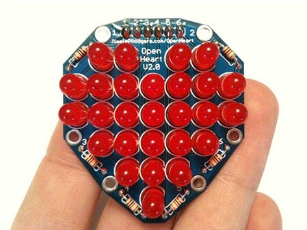

I just finished building the Open Heart kit by Jimmie Rodgers:
http://jimmieprodgers.com/kits/openheart/

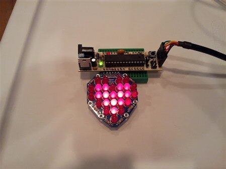

Charlieplexing is cleverly applied so that 27 LEDs are driven by just 6 pins.  The heart-shaped LED matrix could be used with any microcontroller platform.  For those partial to Arduino, Jimmie offers source code for displaying patterns.  I easily hooked up the Open Heart to an Arduino-clone from Adafruit, the DC Boarduino:

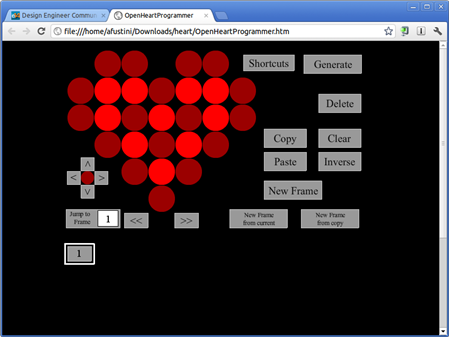

In the source code download, there is also a nifty web-based graphical editor which allows easy creation of new patterns and animations:
Here's a quick video of my Open Heart running the default animations in the example sketch:
The video captures some of the unintended LED illumination during a couple animations.  I believe this is just a consequence of charlieplexing, and it is not very noticeable to the naked eye.

    I've added a Polar chest strap receiver chip, so the Open Heart now beats along with my heart:
    http://www.element14.com/community/blogs/pdp7/2012/02/06/setting-the-open-heart-a-flutter
