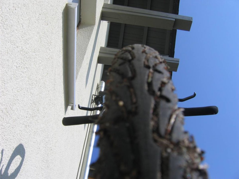

    0 e14 Contributor over 15 years ago in reply to trike
    Completely wrong, you have to remember that tyres for two wheeled devices have a completely different profile to those for 4 wheeled devices (cars).....the tread actually is rounded for bikes (of ANY sort) and therefore you cannot start wearing the sidewalls. Car tyres are generally very flat treaded........
    Go and look at any motorbike or pushbike tyre, as they are designed to go round corners (laying over) with full grip!!! Many have almost two "flats" at an angle with a small high center to allow more tread to touch the road when cornering than when riding in a straight line.
    Many bike users would say that their tyres have more technology and knowhow put into them than any car or truck tyre.....
    You sound like a car driver who has never had a bike of any sort, or you would not have posted in such a manner and so wrongly.......
    To aid your understanding of the technology, I made a quick (bad quality sorry) photo of my (dirty) bike tyre for you, I think that it alone shows the princples of how bike tyres are made, just look how rounded it is:-
    You can see just how much the tyre is curved around, to wear the sidewall, you would need to be almost lying flat on the road to even start doing the damage you are imagining....
    I found a good source of infosand pictures for you here:- http://en.wikipedia.org/wiki/Bicycle_tire
    Looking at motor bike tyres shows a similar design curve. How would you wear the sidewall on such a tyre as this for example (though motorbike tyres are seldom used on wheel chairs! But some specialist bike tyres are basically smaller, thinner versions of this:-
    I hope this helps you to understand that your perceived problem is not a problem at all and will never be as few Wheel chair users have car tyres on their chair!!
    Tyre wear when using the "sides" is less than when a bike is riding upright in many cases, being able to wear one side and then the other does in fact dramatically increase the wear usage of the tyres....
    I am sorry that the picture quality is not great, but I am sure you get the idea, but if not, just ask, I and many others here will do our best to help you further.
