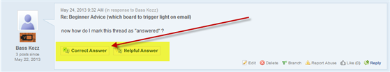

    0 e14 Contributor over 13 years ago
    now how do I mark this thread as "answered" ?
  • nlarson
    0 nlarson over 13 years ago in reply to e14 Contributor
    Hi Bass - you should be able to mark one of these as the "Correct Answer" which should change the status from unanswered to answered (see screen shot below).  Also, as an admin, I'd be happy to mark it as resolved, but thought you'd probably like a chance to award your fellow members with some points for helping you out image
    0 e14 Contributor over 13 years ago in reply to nlarson
    I don't see those same buttons that you do?
  • nlarson
    image Very strange, Bass - you should be able to see those options as the original poster of this question.  I've asked my team to look into it - hope you don't mind, but they may reach out to you to help troubleshoot.  Gifting points to helpful members is one of my favorite things to see on the Community, so hope to get it fixed ASAP!  image  Thanks for letting us know about this!
