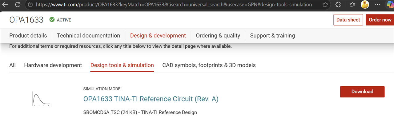

Does anyone have the spice simulation model? TI for the opamp does not have the Tina-TI schematic file (.tsc suffix).

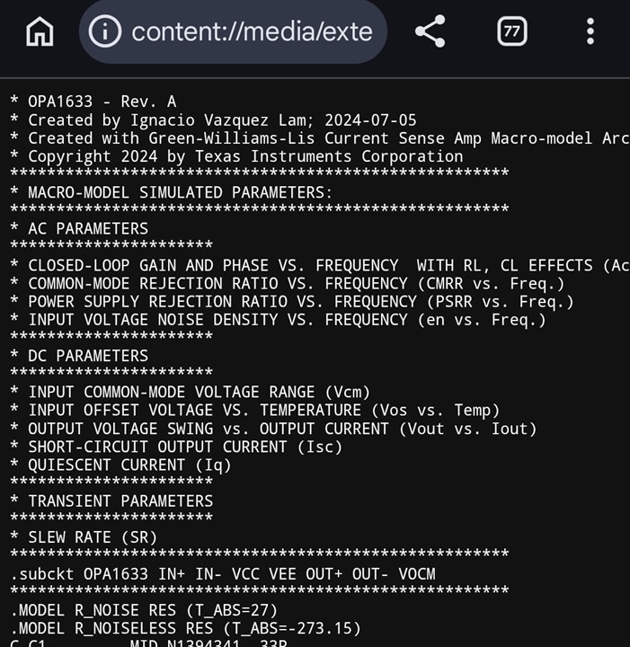

    Looks like you've solved it. That lib file inside the zip file is indeed the SPICE model (snippet screenshot below).

    The .tsc file is a Tina TI format file for a schematic that uses that OPA part. It will have the SPICE model embedded in it. I have not used Tina TI in ages (and don't have it installed currently) so I…

    hi yes that's what i have.  But there is alot of character symbols which has nothing to do with the spice model contents.   I just noticed you say in the instructions "Within the Tina-TI software".   FYI, I have macs and no windows machines. Do I need to install Tina-TI to get the proper Spice model file?
    thankx you for replying
    shabaz 5 months ago in reply to ronyd
    The .tsc file is a Tina TI format file for a schematic that uses that OPA part. It will have the SPICE model embedded in it. I have not used Tina TI in ages (and don't have it installed currently) so I cannot check if you can export or copy the model from there, but I believe Tina TI is free simulation software to build basic schematics up to a small component limit.

    This post on a TI forum contains a zip file of a PSpice model for this op amp. https://e2e.ti.com/support/audio-group/audio/f/audio-forum/1484989/opa1633-opa1633dgnr?tisearch=e2e-sitesearch&keymatch=OPA1633%20ltspice#
    You can open that zip file and use the .lib file within it to import into LTSpice - there seems to be plenty of info on the net to do that, but I haven't tried it myself.  At the very least, it is a human readable file which may be of some use.
    shabaz 5 months ago in reply to Andrew J
