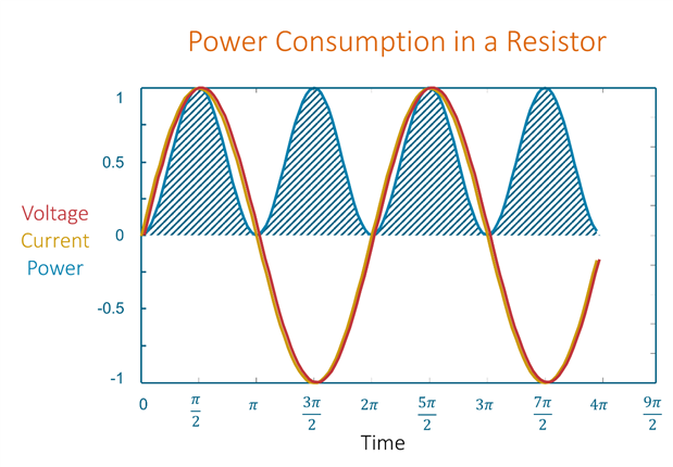

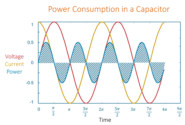

The 90 degree phase is significant because it means there is no power loss like a pure resistor. That’s easy to see by looking at the power consumed by a resistor. The power is equal to voltage multiplied by current. Since the voltage and current are in phase, the values multiply to give the blue power waveform, and the average of it is a positive value (the actual values in the example chart are arbitrary). The value is always positive despite the AC voltage and current quantities having an average value of zero, because multiplying two negative numbers (on the lower half cycles of the sine waves) results in a positive number. The shaded area can be summed and represents the total energy consumed over time and is again a positive value.
The situation is different with a capacitor. The voltage and current are 90 degrees out of phase, and multiplying voltage by current results in the blue power waveform which has an average value of zero. This is because for each half cycle, energy is either stored in the capacitor, or released by the capacitor, resulting in overall energy consumption of zero too.

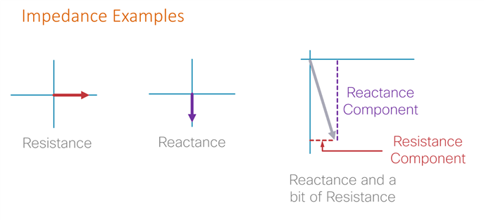

Reactance and resistance can more generally be called impedance (indicated as Z in formulas) which is a vector quantity with the 90 degree phase shifted reactance being on the vertical axis. In contrast for a real resistor, since there is no phase shift, its resistance is represented along the horizontal axis.
In a nutshell, a pure capacitor has reactance, and a pure resistor has resistance, and either of these can be drawn as a vector and called impedance. If we see a vertical line on the impedance vector then we know it is reactance, and if it is a horizontal line then we know it is resistance.
A quantity or vector which has some direction in both axes (e.g. a diagonal path) would represent a circuit or component that has some reactance and some resistance. Resistances cause heat to be generated – as anyone who has connected a resistor to a battery has found out!

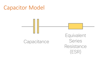

In real life, a capacitor isn’t a perfect capacitor, but instead internally behaves like a capacitor in series with a resistor (this is just a first-level approximation; more complex models are possible). Z is no longer a vertical vector. Instead, it has some diagonal-ness, and has the X component, but also a small resistive component too.
The BA6010 is a device that can measure the impedance of batteries, but as far as it is concerned, it cannot tell the difference between a capacitor and a battery. It doesn’t know what a user has connected to it. So, we are kind of exploiting that to measure capacitor impedance. A real capacitance meter (often available in the form of an LCR or Inductance-Capacitance-Resistance meter) also measures impedance.
Just to recap, impedance, Z, is a vector value with real and imaginary parts (known as R and X respectively), and impedance (also called vector impedance) measuring devices can present this impedance (Z) information in different ways, but it all boils down to determining the real and imaginary parts of the impedance, and then applying a formula to do any conversion.
Rearranging the previous formula means that the capacitance can be derived by using this formula (where f is the frequency that the instrument measures at, and X is what the instrument determined was the magnitude of a measurement that was at 90 degrees to the applied stimulus):
The capacitor Equivalent Series Resistance (ESR) is what the real part of the measurement is known as, and capacitor datasheets will usually specify a maximum ESR at a particular frequency. Sometimes the datasheets do not specify ESR, but do mention Dissipation Factor (DF) which can be converted into an ESR value (see further below).

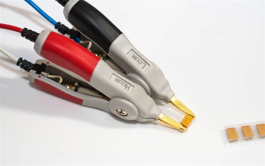

The BA6010 cannot easily replace a true LCR meter, because it only measures at one frequency which isn’t the one always specified in capacitor datasheets.  It also has a more limited range of measurements, perfect for measuring batteries but only usable with a subset of capacitors that engineers will encounter.
The BA6010 is also not as accurate as a dedicated LCR meter for that use-case. Furthermore I was concerned of reverse-biasing polarized capacitors, because the BA6010 applies an AC waveform.
However, although the AC signal that the BA6010 applies to the device under test can reach several volts, this is open circuit. As soon as a practical capacitor is applied, the voltage reduces to a few tens of millivolts or even lower.
According to a tantalum capacitor manufacturer, AVX, they state in a PDF tantalum reverse voltage behavior document that some tantalum capacitors can briefly withstand a few percent of their rated voltage in the reverse direction. Tens of millivolts would be comfortably below this. So, this provided me with the confidence to try subjecting some more capacitors to it than I did for the main review.

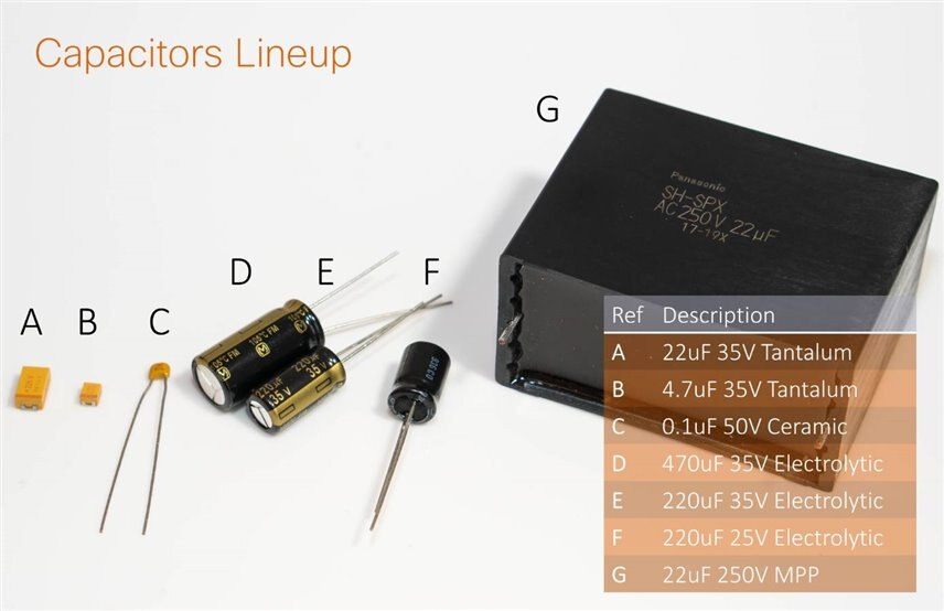

In the end, I used the BA6010 to measure some tantalum, ceramic and electrolytic capacitors shown in the table here:
IdentifierValue (uF)RatingTypeMnfr and Part Number
A2235TantalumAVX TPSD226K035R0200TPSD226K035R0200
B4.735TantalumAVX TPSB475K035R1500TPSB475K035R1500
C0.150CeramicVishay K104K15X7RF53L2K104K15X7RF53L2
D47035ElectrolyticPanasonic EEUFM1V471EEUFM1V471
E22035ElectrolyticPanasonic EEUFM1V221LEEUFM1V221L
F22025ElectrolyticJamicon SK series
G22250Metallized Polypropylene FilmPanasonic EZPQ25226LTAEZPQ25226LTA

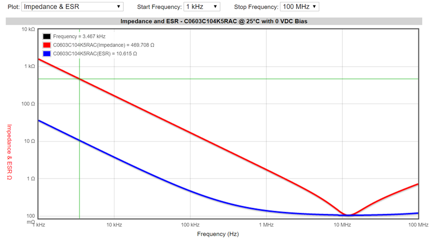

Kemet has an excellent online capacitor tool that provides a plot of ESR versus frequency, when parameters are entered.

The measured values appeared to be in the correct ballpark. I explored the results based on capacitor technology:
Tantalum Results
Capacitors A and B were the tantalum caps, they were from the AVX TPS series, which has low (for tantalums) ESR. The TPS series is extremely mature (it has been around for more than two decades) and I like it a lot because the fairly granular ESR specifications in the range are very helpful when building power supply circuits where specific ranges of ESR may be recommended by the voltage regulator manufacturer. Kemet has an excellent Tantalum Application Note PDF doc which has charts of typical ESR versus frequency of operation. The tantalums that have a higher voltage rating have lower ESR generally. Farnell/Newark has a nice AVX TPS kitAVX TPS kit (and also a low ESR kitlow ESR kit) that are worth getting, the first one at least is low cost.
Ceramic Capacitor Results
Capacitor C was the wire-ended ceramic capacitor (I keep these ones around since they are handy for breadboard prototyping). The lowest ESR is not achieved at 1kHz for ceramic capacitors; this can also be seen by using the online tool at the Kemet website which can plot it out for similar-ish sized ceramic capacitors. The chart here shows in blue how the ESR changes massively (by more than 100 times) at 1kHz compared to 10MHz. A 35 ohm ESR at 1kHz could still mean the capacitor has an ESR of just 0.1 ohms at 10MHz.
Another thing worth mentioning is that the capacitance can dramatically decrease depending on the applied DC voltage on a ceramic capacitor. That wasn't explored here, but is always important to bear in mind when working with ceramic capacitors. One thing to reduce the effect can be to use a physically larger capacitor than necessary.
Electrolytic Capacitor Results
Capacitors D and E are Panasonic’s low ESR electrolytics from their FM series. The measured ESR value was close to the datasheet value, although again the datasheet specifies it at 100kHz.
Capacitor F was another electrolytic, but from Jamicon’s far lower-cost SK series. The ESR was significantly higher, and the measured capacitance was also far lower than the marked capacitance.
Incidentally there is a good technical overview of electrolytic capacitors in a Nichicon Electrolytic Capacitors Description PDF document.
Metallized Polypropylene Film Capacitor
Capacitor G is a (physically) huge plastic capacitor (Polypropylene dielectric). It is used for mains filtering or inverter circuits, although I purchased it for audio use. It had extremely low measured ESR at 1kHz! Although the datasheet didn’t specify a value, similar-sized polypropylene capacitors tend to have ESR of the order of 10 milliohms, so again the measured value was certainly in the correct ballpark.
