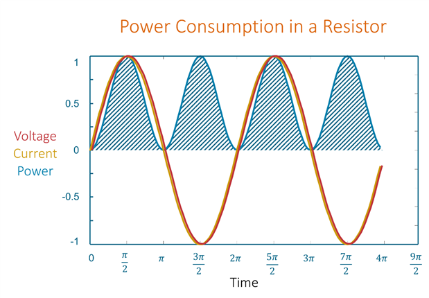

Resistors (perfect theoretical ones) have a resistance that doesn’t change regardless of AC or DC voltages applied to it. Perfect capacitors have a type of ‘resistance’ that changes depending on the applied frequency. Whatever frequency signal is applied to a capacitor, the current is at 90 degrees phase shift to the applied voltage. This is an important property so it is actually called reactance to differentiate from resistance which always has current and voltage in phase.
At low frequencies the reactance is high. At high frequencies, the reactance is low.

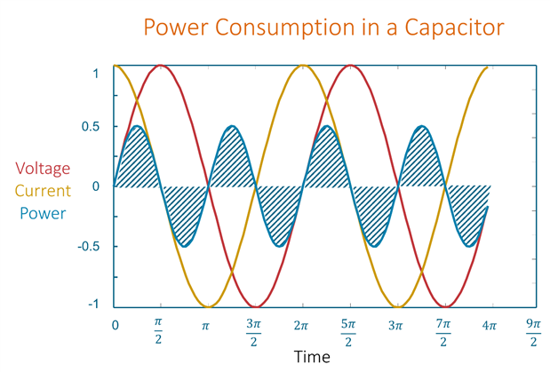

The 90 degree phase is significant because it means there is no power loss like a pure resistor. That’s easy to see by looking at the power consumed by a resistor. The power is equal to voltage multiplied by current. Since the voltage and current are in phase, the values multiply to give the blue power waveform, and the average of it is a positive value (the actual values in the example chart are arbitrary). The value is always positive despite the AC voltage and current quantities having an average value of zero, because multiplying two negative numbers (on the lower half cycles of the sine waves) results in a positive number. The shaded area can be summed and represents the total energy consumed over time and is again a positive value.
The situation is different with a capacitor. The voltage and current are 90 degrees out of phase, and multiplying voltage by current results in the blue power waveform which has an average value of zero. This is because for each half cycle, energy is either stored in the capacitor, or released by the capacitor, resulting in overall energy consumption of zero too.

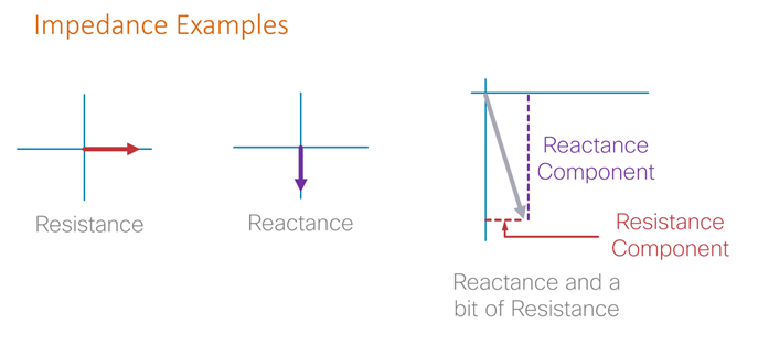

Reactance and resistance can more generally be called impedance (indicated as Z in formulas) which is a vector quantity with the 90 degree phase shifted reactance being on the vertical axis. In contrast for a real resistor, since there is no phase shift, its resistance is represented along the horizontal axis.
In a nutshell, a pure capacitor has reactance, and a pure resistor has resistance, and either of these can be drawn as a vector and called impedance. If we see a vertical line on the impedance vector then we know it is reactance, and if it is a horizontal line then we know it is resistance.
A quantity or vector which has some direction in both axes (e.g. a diagonal path) would represent a circuit or component that has some reactance and some resistance. Resistances cause heat to be generated – as anyone who has connected a resistor to a battery has found out!
The formula to work out the reactance at the frequency of interest, for the perfect capacitor, is simply
where X is the magnitude of the vertical component of Z (for a perfect capacitor, Z is actually equal to X).

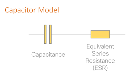

In real life, a capacitor isn’t a perfect capacitor, but instead internally behaves like a capacitor in series with a resistor (this is just a first-level approximation; more complex models are possible). Z is no longer a vertical vector. Instead, it has some diagonal-ness, and has the X component, but also a small resistive component too.
The BA6010 is a device that can measure the impedance of batteries, but as far as it is concerned, it cannot tell the difference between a capacitor and a battery. It doesn’t know what a user has connected to it. So, we are kind of exploiting that to measure capacitor impedance. A real capacitance meter (often available in the form of an LCR or Inductance-Capacitance-Resistance meter) also measures impedance.
Just to recap, impedance, Z, is a vector value with real and imaginary parts (known as R and X respectively), and impedance (also called vector impedance) measuring devices can present this impedance (Z) information in different ways, but it all boils down to determining the real and imaginary parts of the impedance, and then applying a formula to do any conversion.
Rearranging the previous formula means that the capacitance can be derived by using this formula (where f is the frequency that the instrument measures at, and X is what the instrument determined was the magnitude of a measurement that was at 90 degrees to the applied stimulus):
The capacitor Equivalent Series Resistance (ESR) is what the real part of the measurement is known as, and capacitor datasheets will usually specify a maximum ESR at a particular frequency. Sometimes the datasheets do not specify ESR, but do mention Dissipation Factor (DF) which can be converted into an ESR value (see further below).

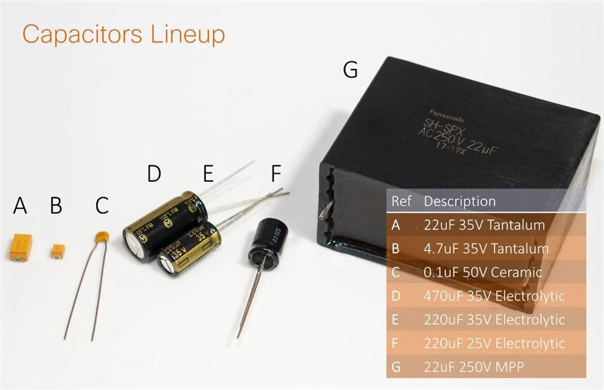

Capacitors and Specifications

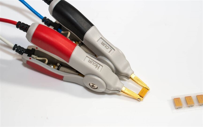

In the end, I used the BA6010 to measure some tantalum, ceramic and electrolytic capacitors shown in the table here:
IdentifierValue (uF)RatingTypeMnfr and Part Number
A2235TantalumAVX TPSD226K035R0200TPSD226K035R0200
B4.735TantalumAVX TPSB475K035R1500TPSB475K035R1500
C0.150CeramicVishay K104K15X7RF53L2K104K15X7RF53L2
D47035ElectrolyticPanasonic EEUFM1V471EEUFM1V471
E22035ElectrolyticPanasonic EEUFM1V221LEEUFM1V221L
F22025ElectrolyticJamicon SK series
G22250Metallized Polypropylene FilmPanasonic EZPQ25226LTAEZPQ25226LTA
The datasheets sometimes show the ESR in different ways. It depends on what the capacitor is intended for. Sometimes the ESR is indicated at a spot frequency of 100kHz. This was the case for the tantalum capacitors and the high-end electrolytic capacitors I tried.
Sometimes the ESR is not directly stated in the datasheet, but a dissipation factor value is presented, either as a ratio, or as a percentage. The dissipation factor can always be converted to ESR using this formula (where DF is a ratio, f is the frequency, C is the capacitance, and ESR is in ohms):
The frequency selected for ESR could be 100kHz as mentioned above, but could also be at 120Hz for capacitors that are perhaps intended for mains-derived voltage smoothing. Wire-ended capacitors also sometimes specify the ESR at 1kHz, since they are maybe more likely to be used at lower frequencies.
The BA6010 can only measure at 1kHz, because this is the frequency used by battery manufacturers and the related specifications.
When measuring capacitor ESR at 1kHz, the value might not match the datasheet specification since that could be at 100kHz or 120Hz for instance. However, in that ballpark frequency range, the ESR of a capacitor tends to reduce as the measurement frequency is increased. So, if a measurement is taken at 1kHz, it would not be unusual to see that the measured ESR is higher than the datasheet ESR limit measured at 100kHz.

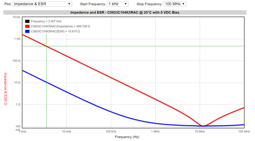

Kemet has an excellent online capacitor tool that provides a plot of ESR versus frequency, when parameters are entered.

Capacitor C was the wire-ended ceramic capacitor (I keep these ones around since they are handy for breadboard prototyping). The lowest ESR is not achieved at 1kHz for ceramic capacitors; this can also be seen by using the online tool at the Kemet website which can plot it out for similar-ish sized ceramic capacitors. The chart here shows in blue how the ESR changes massively (by more than 100 times) at 1kHz compared to 10MHz. A 35 ohm ESR at 1kHz could still mean the capacitor has an ESR of just 0.1 ohms at 10MHz.
Another thing worth mentioning is that the capacitance can dramatically decrease depending on the applied DC voltage on a ceramic capacitor. That wasn't explored here, but is always important to bear in mind when working with ceramic capacitors. One thing to reduce the effect can be to use a physically larger capacitor than necessary.
