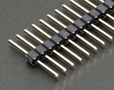

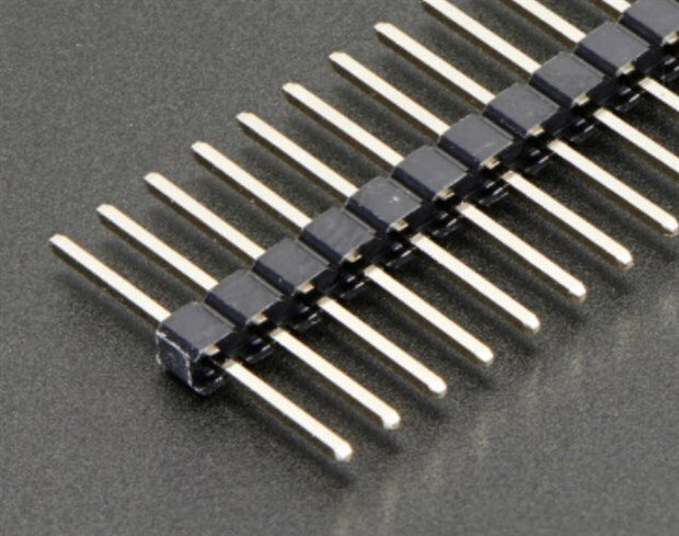

I'm trying to find some pin converters, by which I mean something which will change a male pin into a female socket. This is primarily for stacking shield boards on top of a microcontroller board when I've got the wrong sense pins soldered in and don't want to change them. For example, I have two boards which I want to stack, both have male pins, so how do I connect them? I've looked around a lot of sites trying to find these but haven't succeeded yet and when I was thinking of where I could ask element14 seemed like the logical choice.

    • For female-to-female connections use break-away headers

    These are quite hard to find : ) I've wanted to get some for ages, but never found the magic search term! I thought they may be for wire-wrap, but not seen them on Farnell/Newark site. I had a couple of 40-way lengths of these but used it up over the past few years : (
    Sometimes I'll use the smaller ones and try to push the plastic portion into the center.

    I tried few times and yes they are really hard to find with a good price (also the colored ones). I do get them from Pololu, Adafruit, Sparkfun, etc which usually get these kind specific parts from not so popular manufacturers but the thing with these providers is that they do their QC homework and do sell quality parts, so they have good coatings, LEDs will be all the same brightness, leads won't rust over time, etc.
    Try "double sided male headers", "equal length pin header" or "extra-long ping header" I found many results with these terms and maybe few of those will be based in the UK.
    Luis
    shabaz over 6 years ago in reply to luislabmo
    Thanks! I've just seen them:

    jw0752 over 6 years ago in reply to luislabmo
    Thanks Luis,
    I too have been searching for the double male headers for a long time. I had actually given up but your post identifying the vendor Pololu allowed me to find some. I have placed my order and I am happy.
