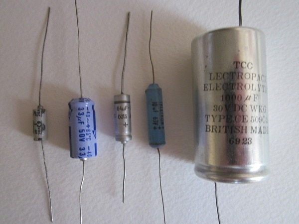

In my quiet times I like to salvage old electronic circuits. As I sort through the parts I often take the time to check the capacitance of the electrolytics. Of course there are many that show signs of leakage and test low against their rated capacity. These get tossed. There are however a surprising number that look fine but test well above their rated values.
Here we have a typical old electrolytic with a rating of 330 uF at 16 Volts. However when I measure it with a couple different meters I get a capacitance of 460 uF. This is 40% above the rated value. What I am hoping someone can explain to me is the physical mechanism by which this capacitance has increased with age.
As a continuation of this experiment I have put 16 volts on this capacitor and charged it and discharged it several times. While I could not document this it appeared to take more current on the first charge. I understand that the dielectric layer between the metal and the electrolyte can be damaged and then repaired by the correct polarity being applied. Perhaps this explains the apparent extra leakage on the first charge. Now that I have processed the capacitor through several charge and discharge cycles and left it at full voltage for several minutes I have retested the capacitance. The capacitance has come down to 455 uF which doesn't indicate any significant change that might have been related to the healing of the dielectric layer.
It is probably a simple physical change that has occurred with the passing of time but it has gotten me curious. The other explanation, of course , is that the capacitors just had wildly bad tolerances years ago and I am just imagining this conspiracy to increase in value with time.

    It's not unusual for a capacitor to have a tolerance of plus 50%. Do a parametric search from a distributor and you'll see for aluminum electrolytics that -10% to 50% is a common tolerance.

    I did find this about pre-conditioning here https://en.wikipedia.org/wiki/Electrolytic_capacitor
    For antique radio equipment or for electrolytics built in the 1970s or earlier, "pre-conditioning" may be appropriate. For this purpose, the rated voltage is applied to the capacitor via a series resistance of approximately 1 kΩ for one hour. Applying a voltage via a safety resistor repairs the oxide layer by self-healing. Capacitors that fail leakage current requirements after preconditioning, may have experienced mechanical damage.[91]
    It also talks about leakage current v time.
    Sadly the markings are buried in a standard ... you know the one where someone wants you to pay for soemthing that should be free.
    IEC/EN 60384-1 - Fixed capacitors for use in electronic equipment
    My guess is that it will be 20% tolerance which only gets you to 396 uF ....

    Interesting measurement! Agree, it could be tolerance related, also it might be very leaky, and if the capacitor meter is charging it, and waiting for the voltage across it to reach a certain value, it will take longer, so the meter could think it has a higher capacitance. Also interesting that the value that was measured changed after the first time. I wonder if fresh/new electrolytics do the same thing... plastic caps have dielectric relaxation effects, but I don't know if this applies to electrolytics too.

    I think you will find that the material separating the two plates of the capacitor has changed over time.
    I suspect that the increased capacitance value was caused by the material shrinking slightly bringing the two plates closer together.
    Please be careful with these capacitors because the increased capacitance also means that the electrolytic breakdown voltage has been reduced, so you can expect these capacitors to fail at lower than rated voltages.

    Thank you for the insight. I had thought about the possibility of the metal crystalizing or fracturing thus increasing the surface area but I had not considered the distance between the plates decreasing. I will have to study a little more about the structure of electrolytics as I believe that the electrolyte itself serves as one plate and the metal the other with the insulating oxide layer as the dielectric. This would mean that the oxide layer itself may have devreased.

    When the electrolyte evaporates it can leave salt deposits on the two plates. These salt crystals can for conductive paths which greatly reduce the capacitance and voltage tolerance.
    There has to be two conductive plates in every capacitor. The electrolyte is just a buffer fluid used to balance the insulating material to maintain a constant value of capacitance over the plate area.

    I've just had a look around and found some old electrolytics.
    From left to right (marked/measured)
    1uF 2.034uF
    33uF 46.08uF
    64uF 90.39uF
    10uF 23.26uF
    1000uF 1198uF
    So they all read consistantly high. The only one with a date code is the one on the right which dates from 1969. Curiously, that's the
    most accurate, with a value that is almost certainly still within the original tolerance.

    This is exactly the trend I have noticed. The readings on your first three capacitors are what motivated me to ask this question. Unfortunately there is no way to go back to see what the original values were so we do not really know if the original real values have gone up over the years or not. If we can determine a physical mechanism for this trend towards being much higher than nominal then we can understand it and capacitors better. Thanks for adding some weight to my observation.
