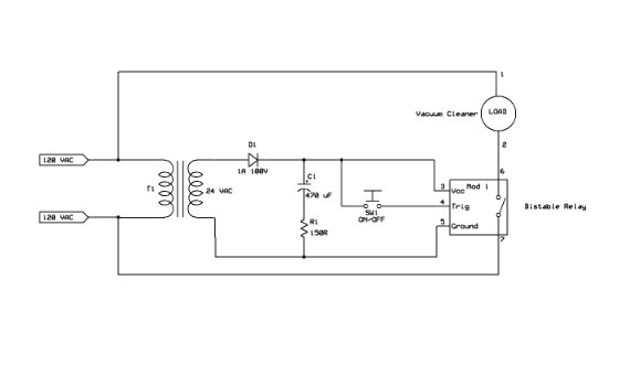

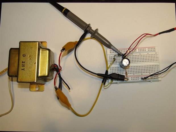

This last weekend I had to repair a simple circuit that was designed to turn a vacuum system on and off with the alternate push of a SPST momentary switch. Here is the circuit that I worked on.
The problem turned out to be that the manufacturer had the C1 capacitor installed reversed polarity. Removal of the capacitor and replacement with  a new one in the proper polarity solved the problem.
My question concerns the 150 Ohm R! resistor as I have never seen a power supply with the negative lead of the filter capacitor held above ground. Can someone give me some information on what the designer's reason for the inclusion of R1 in this circuit might have been?
Thanks John
    dougw over 7 years ago +6 suggested
    Perhaps it is to limit inrush current and avoid stressing the diode or upstream fuses? It could also be to limit discharge current when power is removed (to avoid stressing the module's protection diodes…

    Here is perhaps a better image of the schematic: John
    shabaz over 7 years ago in reply to jw0752 +5 suggested
    Hi John! I'm not sure, but maybe the transformer is very small and as Doug says, it could be to reduce high current draw briefly. Those types of relays are very cool.. I think they maybe referred as step…

    Hi John,
    I think the meaning of R1 is to reduce the power consumption of the relay once the contacts are triggered closed. The relay coil will have a defined operating current, needed to switch it to close, but once the contacts are closed, the current required by the coil to keep the relay contacts closed is normally sensibly lower than the operating current. Adding R1 will reduce the current flowing into the coil, thus reducing power consumption.
    There is a drawback though, but in your case I think can be ignored: adding R1 in series to C1 will make the capacitor time constant longer, hence limiting the switching speed of the relay.

    Hi John,
    I agree with the others. R1 would limit the initial current draw caused by the capacitor.
    Depending upon the type of capacitor, some electrolytic insulators break down during high current changes over small periods of time.
    It also might prevent parasitic oscillations between the transformer and the capacitor.

    Thanks for all the good ideas. I am sorry that I can't give much better detail particularly with respect to the relay module. I looked like a regular solid state relay module but in one corner there was a small mechanical relay mounted so it is some sort of hybrid. I have bread boarded the circuit and hooked up the scope and variable load so I could look at the effect of a range of loads on the quality of the DC voltage produced.
    The transformer in this test is about the same size as the one I saw in the piece of equipment and so it should be at least an adequate power source for up to 250 mA  at 35 volts from my experience.

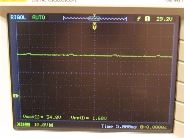

    This first picture is of the output Vcc to ground with no load. We are seeing a 1.6 volt ripple on 34.8 volts DC.

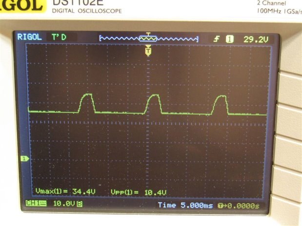

    In this picture we are looking at the same probe points but with a 10 mA load. Even a 10 mA load has degenerated the quality of the DC so that now we have 10.4 volts of ripple on the 34.4 Volt max.

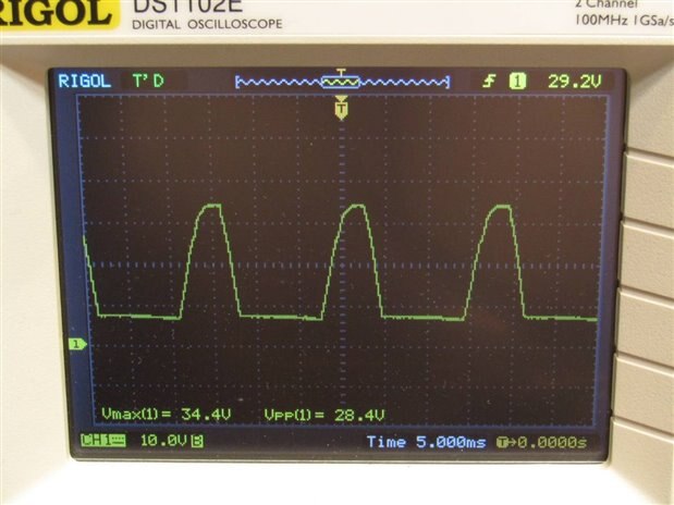

    This is the situation when there is a 50 mA load on the power supply. I suspect that the actual relay module draws no more than this current when it is active and holding the relay in. The power supply design at this load is only able to maintain a 6 volt DC offset.

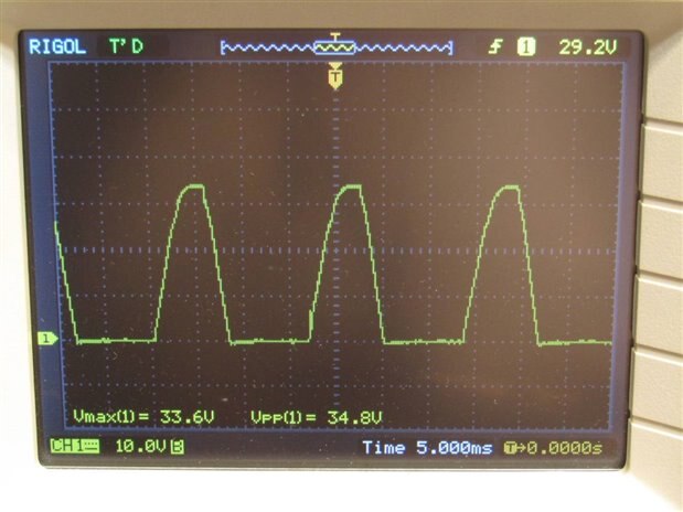

    Here we are looking at a 100 mA load and we see that the capacitor is making basically no contribution to supplying a DC voltage between cycles.

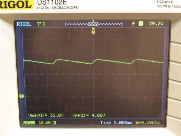

    In this shot I have left the load at 100 mA and shorted out the 150 ohm resistor.
    From these tests it seems the best effect of the 150 Ohm resistor is to ruin the effectiveness of the capacitor to remove the ripple. From my experience with the type of relay module used in this unit there is no need or advantage to a poor quality DC supply but then I know very little in the big scheme of things. Based on the fact that the manufacturer assembled this unit with a reversed polarity capacitor it is entirely possible that the use of the resistor in this manner is also just a mistake. The unit is currently working as expected and my son doesn't want me to experiment with it now that it is working so I won't be able to take the experiment any further with the actual equipment.
    If anyone has experience with relay modules that work better with a poor quality DC supply it would be interesting to know why.

    I'd side with inrush current limiting as the main reason - but maybe because the bistable relay may have some requirement regarding power-on rise time. A filter capacitor sitting over a halfwave rectifier would act like a dead short until it started charging, which would slow down the rise of Vcc when power is applied. The resistor will reduce inrush, reducing the rate at which the capacitor can charge and consequently discharge ... but also in turn would ensure Vcc rises faster although less stably.
    Otherwise, it could be because of some other behaviour regarding the bistable relay - perhaps upon power down or switching, it could result in a current spike that shortens the coil lifetime.
