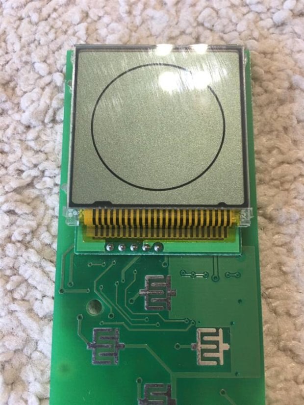

    Thank you John for putting this post up, also thank you everyone for any help and great recommendations, the display looses the segments of the numbers and within time all the segments go away, i have…

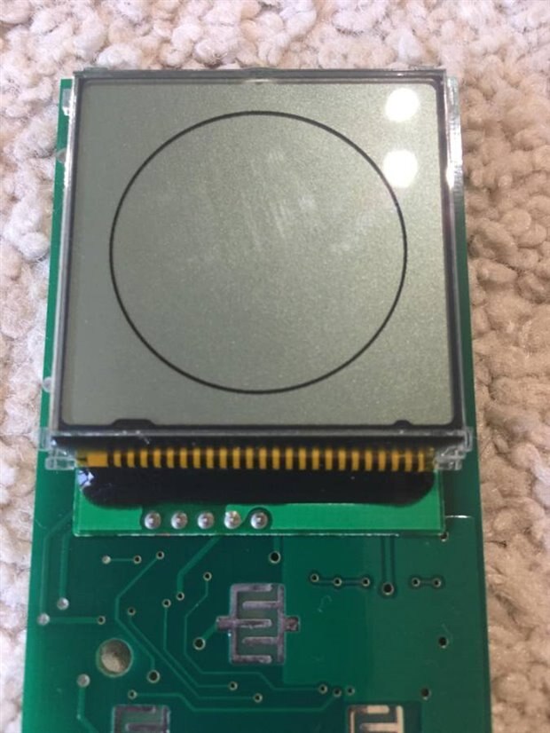

    andriu011 over 6 years ago in reply to beacon_dave +4 suggested
    Yes, the end attached to the glass seem attached strongly, i am heating and press pressure to the end cable that is attached to PCB. Here is another picture with same remote but something black stuff added…

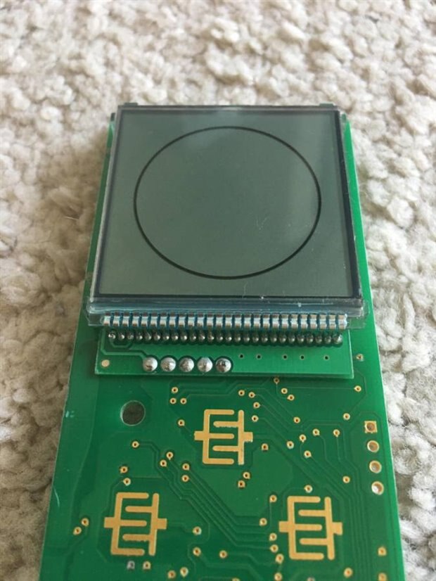

    0 andriu011 over 6 years ago in reply to beacon_dave
    Yes, the end attached to the glass seem attached strongly, i am heating and press pressure to the end cable that is attached to PCB. Here is another picture with same remote but something black stuff added but still has the same issues. Have also attached a picture of what the company came up with and fixed the display issue for good ( the pins are metal ).

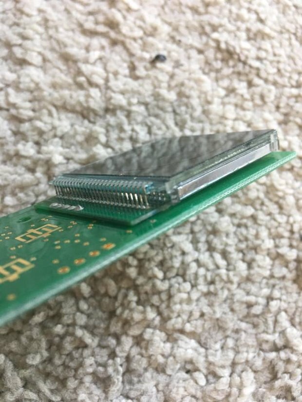

    0 shabaz over 6 years ago in reply to andriu011
    Hi Andrei,
    The black material is likely epoxy resin glue. The metal pins are called 'lead frame pins' and are quite common on LCDs, but usually come pre-attached (and often glued, sometimes with a transparent glue and sometimes with opaque) as part of the display, from the LCD manufacturer.
    Converting an LCD from the flat flex to the lead frame pins might be manually possible, but you'd need a PCB with the holes in it. I think if the lead frame pins is the option you're aiming toward, then it would be better to purchase the LCD with the lead frame pins pre-attached if this is an option (assuming that the interface board with the holes is also available), otherwise there is the difficulty in trying to source the correct lead frame pins for the thickness of the glass on the LCD, and finding a suitable adhesive etc.

  • beacon_dave
    0 beacon_dave over 6 years ago in reply to andriu011
    Are the 5 solder pins to the left the only obstructions under the board in the area of the ribbon ?
    i.e. could you slide a thin spring clip onto that lower edge of the PCB such that it pressed the ribbon firmly against the PCB.
    By this stage, there may be some oxidisation of the contacts, which is making conductivity poor with the adhesive alone. May need to lift it, clean it and try some of that conductive tape Shabaz mentioned, then fit a clip.

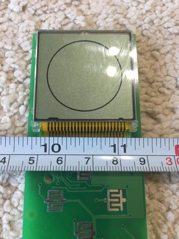

    0 shabaz over 6 years ago in reply to beacon_dave
    Good point, maybe a C-shaped clip could work (like the type used sometimes on the edge of paper for filing) maybe with a 3D printer possibly.
  • andriu011
    0 andriu011 over 6 years ago in reply to shabaz
    The 5 solder pins is holding the display PCB to main PCB, there is very little tiny space in between, maybe a half size of bank card.
