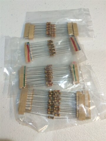

  • GET A BUDDY TO HELP ME - Preferably a buddy who is also not colorblind, but while a buddy might be able to help me sort a new collection of resistors into bins, he isn't going to be attached to my hip when I need a resistor identified on a project that I'm working on at 3AM.image

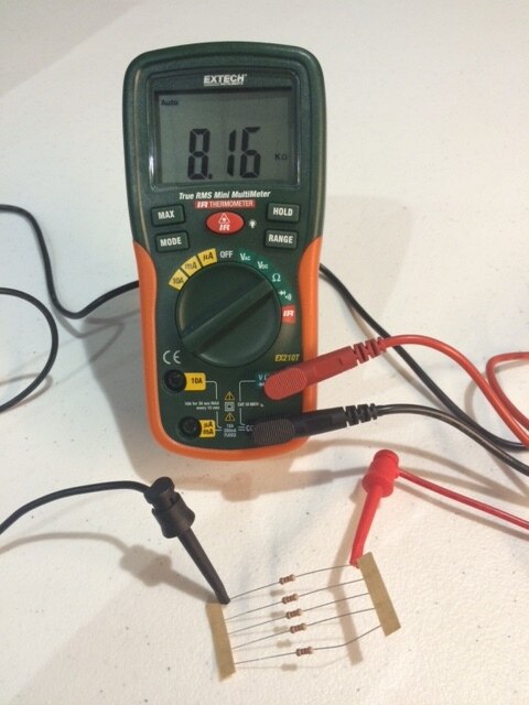

  • MEASURE THE RESISTOR USING A MULTIMETER - This may work to identify a resistor outside of a circuit, but it also does not take into account any tolerances of the resistor, which I also cannot discern.  I do not want to de-solder a leg on each resistor I need to measure on a PCB, either.

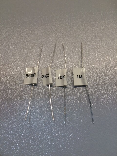

  • LABEL THE RESISTORS - This will work if I buy resistors that are in label pre-packaged bags and I am able to label them right away.  I probably would look to label them according to either European or SMT standards in order to keep the labels as small as possible.  This method takes a considerable amount if time, and I will probably only use it for prototyping.

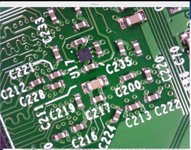

  • PREMARKED RESISTORS - Some resistors like SMT resistors have their values printed on them.  These I can figure out.

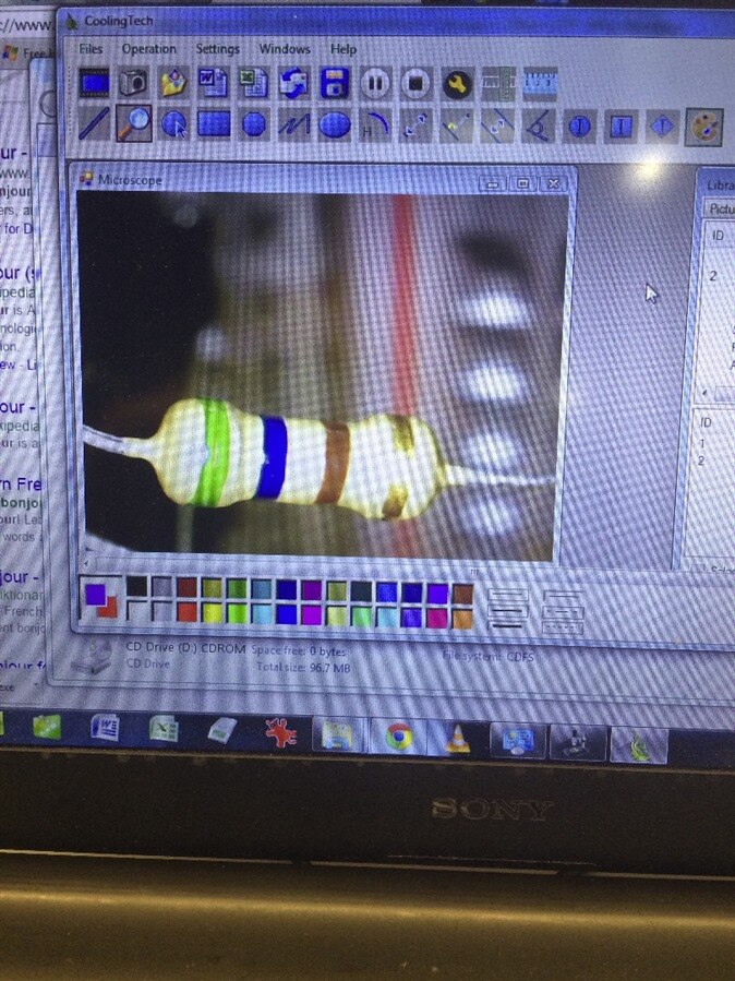

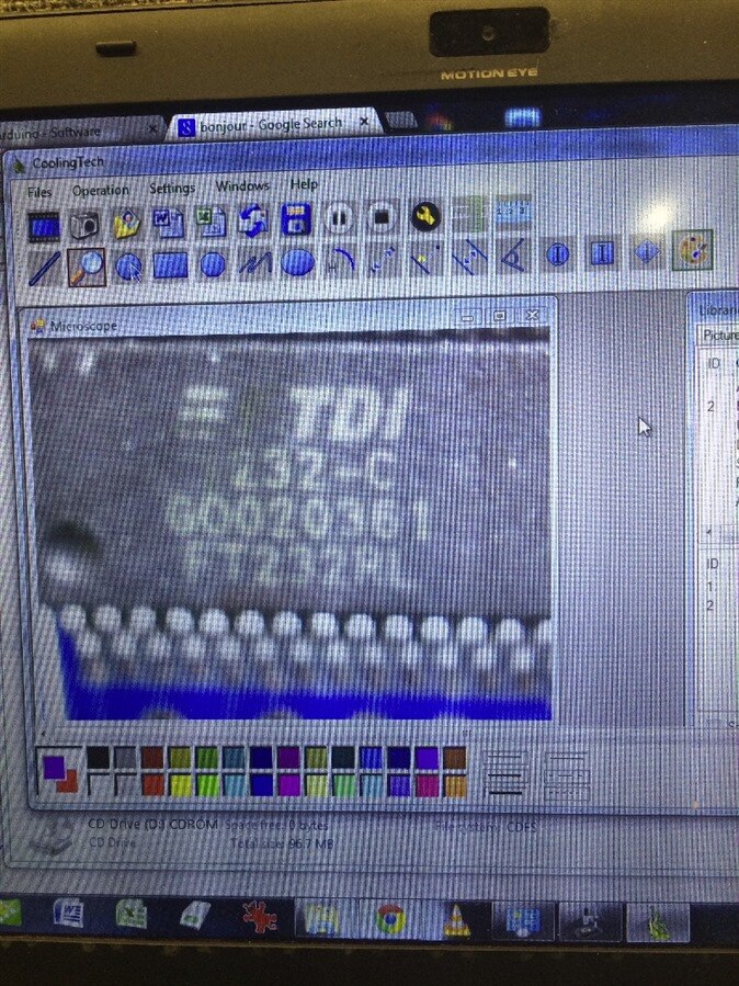

  • VISUAL COMPUTER AIDED ANALYSIS - Another idea that I had was to use either a camera, or a USB microscope to "scan" the resistor.  The image could then be dropped into a computer program that would orient the resistor and scan the color bands displaying a value in Ohms and providing me the tolerance.  I have no experience with any program that can automatic manipulation and color matching, so I'm stuck there.

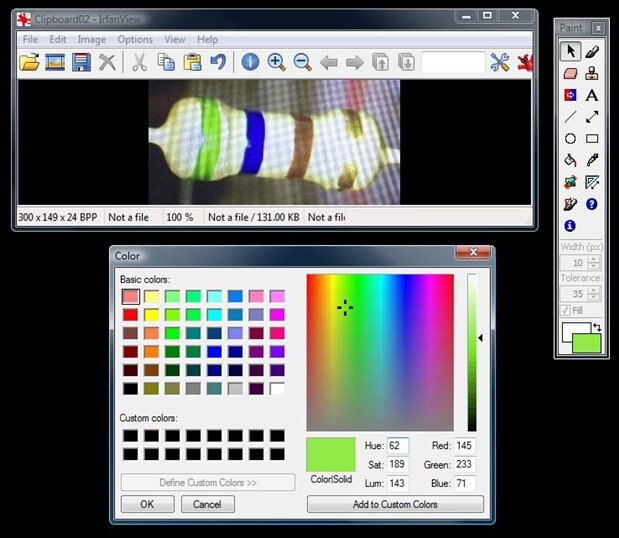

    dougw over 11 years ago in reply to 4ringfan +4
    Hi Mike, I'm currently immersed in some pretty heavy projects, so I don't have much time to devote to this, but I just wrote a quick program in VB6 that will show the color of any pixel on the screen …

    The best long-term approach to your situation IMHO would be to explore the visual computer aided analysis you mentioned. Not only does it sound like a really cool idea, it would no doubt help others.
    Luckily, somebody has taken a very similar approach already, you can read more about it here: http://armageddon421.de/?p=279

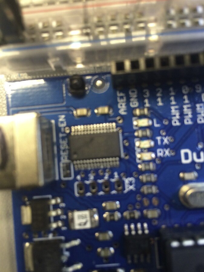

    SMT
    You're right they label them, but only the larger size ... I have some grains of sand that are apparently reistors. image

    ResCan looks like it would do what I want it to according to that video.  Now I just need to figure out HOW to actually make the software work. image

    Good Post Mike, BTW if you know the % tolerance a range of resistors in your pot or dustbin are then measuring them does tell you what they should be as they choose the range values to allow you to make up any value you want to with in that 1-5% or what ever. Any way even if they are at their full tolerance they should be closer to the value they should be than to any other value in the series.
    Anyway the resistance you measure is the resistance you have so maybe that's more important than the stripes ...not that most designs are that ultimately fussy any road  image
