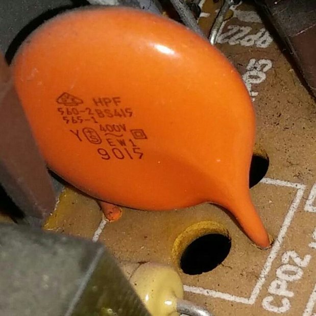

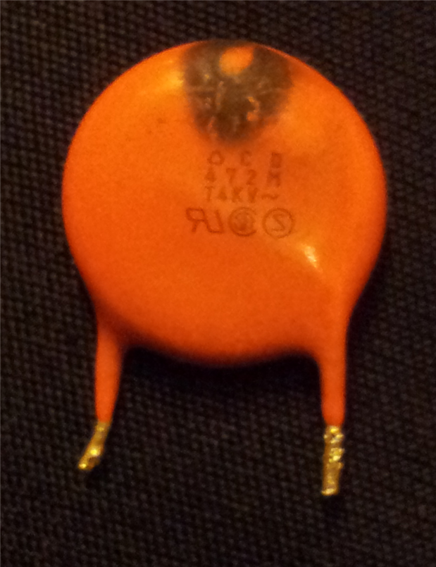

I have never seen a capacitor like this one (yep, I'm a noob) so I searched online for some info and I though I could read it's value...the problem is that when I desoldered it from the board I noticed that on the other side it had other things written that, to my little knowledge, suggest a different value. Here are the pictures:
From this one I read that the precision is B, and the value is 4.1 uF with max 400v. The rest of the letters I have no idea what they mean.
From this one I read that it is a 4,7 pF capacitor and the precision is M. The rest I do not understand.
What I would really like to know is what the actual value of the capacitor is and if possible, what the various things on both sides mean so that in the future I will be able to read them.

    Typing 472M into google gives you 26,700 replies or thereabouts. http://www.csgnetwork.com/capcodeinfo.html Your out by a long way ... Why are you thinking that is the problem.? I'd be looking more at…

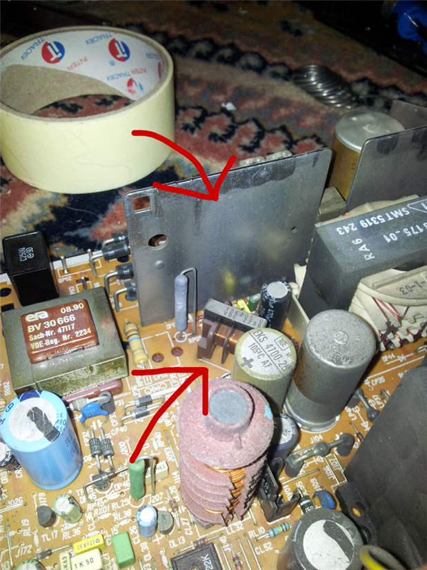

    This is the main board from a 1970's/1980's tv...the power supply should be ok as it is a separate unit and I got it fixed a few months ago. The problem is that a few days ago the tv made a noise (like…
    I'd be looking more at the component behind it, as it looks like either a scorch mark, or heat from a resistor.

    Ok, thank you very much! I though that was the problem because it is the only component that has any marks of damage, but it was right in front of a resistor so as you said it could probably be the heat from the resistor that made that mark. Do you suggest replacing both the resistor and the capacitor at this point?
