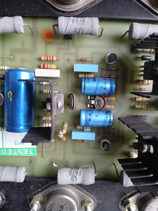

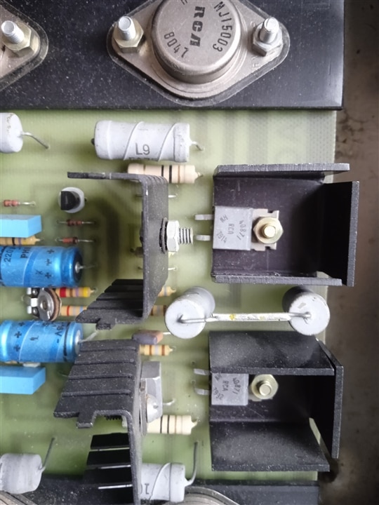

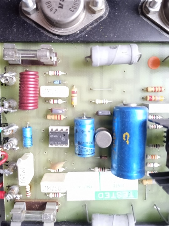

Can someone help identifying what this are? I reckon it is an old diod. Need something to replace it with
kardan
kardan over 3 years ago

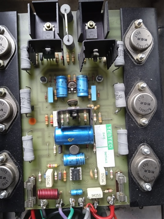

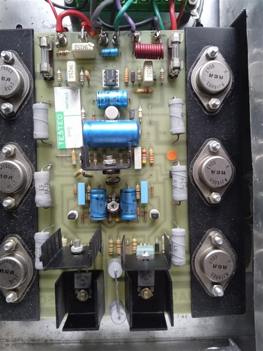

imageimageimageTUAC TD500-C1 mono amplifier
TUAC TD500-C1 amplifier boardimage

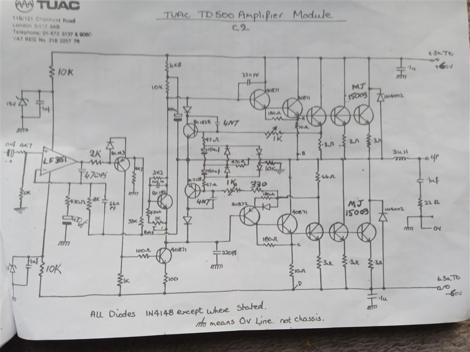

The simple markings on photo does not have the Anode and Cathode marked.
Please reload the page as I have updated the last image.

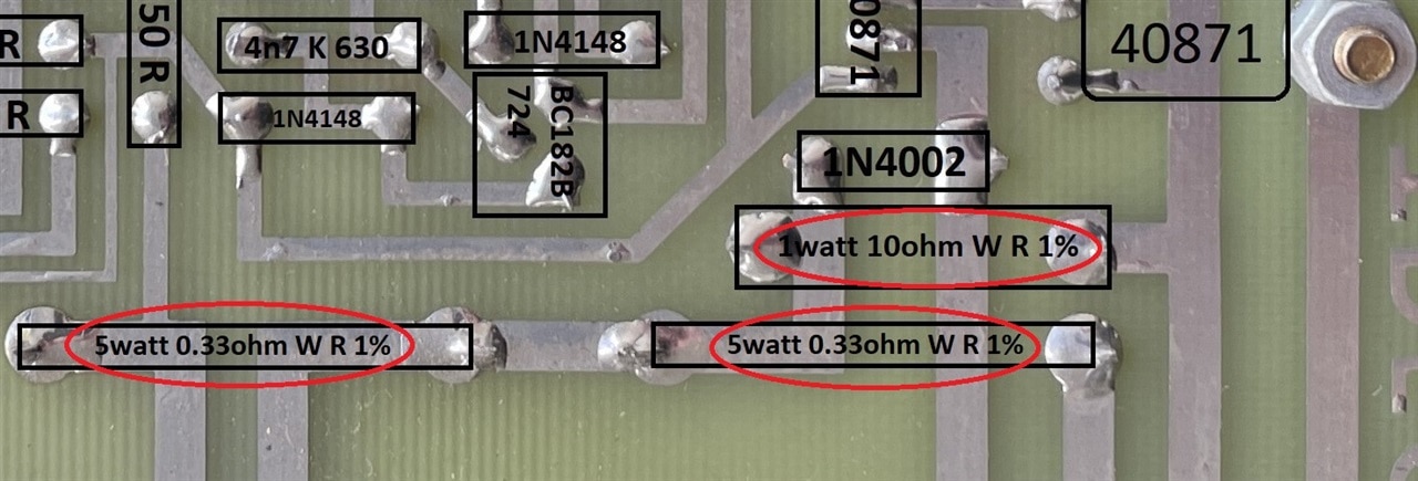

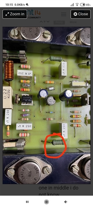

    shabaz over 3 years ago in reply to anniel747 +2
    Could be.. I thought maybe the color code was brown-yellow-gray, 148, i.e. maybe 1N4148, but I've not seen that before. Anyway, hopefully photo(s) can make it clearer, or some context.

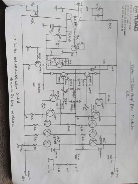

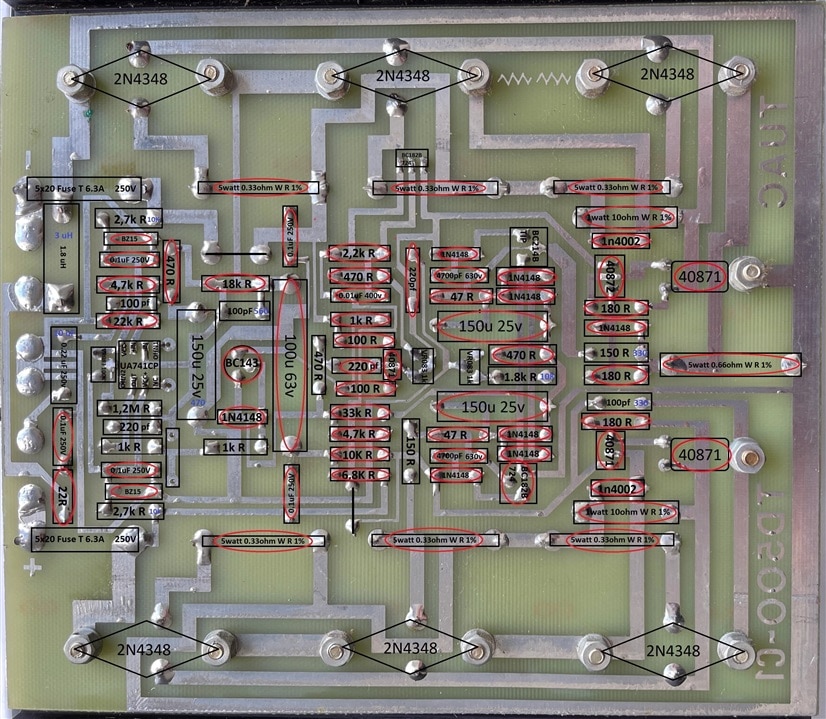

    Thanks for the pics, they helps a lot Slight smile I'm doing some measurements, soldering and waiting for several new components..
  • kardan
    0 kardan over 2 years ago in reply to Ian-Scott
    It is very hard to find 630v for the 4700pF, but I should be able to use 250v for the 4700pF and 0.01uF as you have. I assume they are replaced earlier on mine.
  • michaelkellett
    0 michaelkellett over 2 years ago in reply to kardan
    There is no need for a 630V cap in that position. The max voltage difference on the amplifier board is about 120V so even a 250V cap gives you massive margin.
