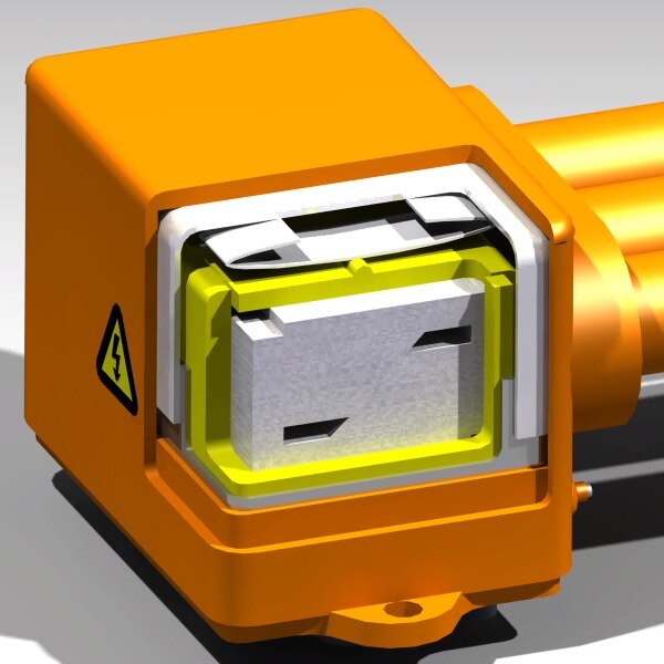

Researchers want to replace copper with aluminum as a new conductor for power systems
Eavesdropper
Eavesdropper
14 Feb 2011
Scientists from the Technische Universitat Munchen (TUM) are collaborating with engineers from BMW to develop the means to replace copper with aluminum as a conductor in on-board power systems. ‘But why’, you might ask?  Price. Copper is the conductive material of choice; however, in comparison to aluminum copper is heavy and expensive. With electric power and electronics playing an ever-increasing role in all kinds of vehicles, and in particular for fully electric vehicles, the switch to the cheaper and lighter aluminum could be an attractive option. Before the lighter and less expensive aluminum can replace copper in power supply systems, a number of technological challenges need to be surmounted. When temperatures are high, as one example, aluminum displays a distinct creep behavior. Conventional connectors could thus not be used, as they would become loose with time. A possible alternative, the use of aluminum-based elements in the cables and copper-based elements in the connection zone is fraught with difficulties. Since there is contact between the copper and aluminum cable is a large electrochemical potential, such cables would be greatly endangered by corrosion. So the scientists developed the aluminum-based LEIKO concept to counteract these difficulties. A sheet metal cage (an electromagnetic compatibility requirement anyway) enhances the mechanical stability of the plug and guarantees the long-term support of the contact pressure spring. Because the necessary contact force is no longer provided by the contact elements themselves, the originally problematic 'creep' behavior of aluminum turns into a contact stabilizing, and thus, positive property. This, in turn, also guarantees a constant contact force over a lifetime of ten years. To this end the researchers came up with a special wedge-shaped geometry for the aluminum contacts. The aluminum creep now leads to the two contacts snuggling closer and closer together over time, thereby rendering the electrical connection better yet. Moreover, the consistent use of aluminum alloys and the application of precious metal plating made it possible to relocate the formation of corrosion-prone local elements to less critical locations in the system. Initial results indicate that the material substitution will lead to significant improvements in weight, cost, and ultimately emissions. For more information please visit: http://translate.google.com/translate?hl=en&sl=de&tl=en&u=http%3A%2F%2Fwww.tum.de%2F&anno=2

    May I make a few comments that I suspect may have been mutterred under the breath of a few engineers.
    Automotive environments are not healthy ones for any sort of connection - the temperature cycling and potential exposure to moisture do nothing for reliablility. One fear is that the sealing in the connector will degrade over time and then the electrolytic corrosion starts in earnest. This is largely why aluminium is not used in power distribution if it can't be helped.
    There is a move towards 42V systems in automotive, but no single manufacturer has made this leap as yet. The advantage is that you can "bus" the power in thinner cabling (less i2R loss) and use canbus control rather than more complex looming (reduced manufacturing complexity). It will however leav a lot of the "add-on" market floundering.
    A 10 year reliability is not good enough for automotive! With ABS and electric PAS systems these need to be 100% for the life of the vehicle.
