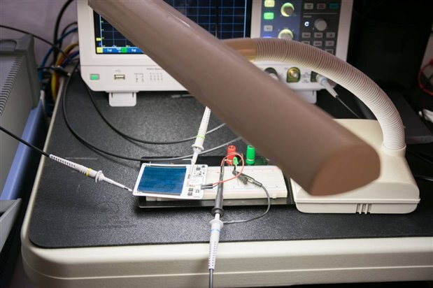

Testing the performance of the energy harvesting kit in absolute terms is rather difficult. The energy levels we are dealing with are relatively limited and incorrect test setup can lead to perplexing results. Likewise, I do not have any radiometric equipment to measure absolute irradiance, standard xenon “solar simulator” light sources or the spectral distribution of the light sources.
Because very small currents are involved, regular power supplies and electronic loads would not be accurate enough to perform testing with. While I do have a Keithley 2450 SMU from the recent RoadTest, it is currently engaged in a long-term test and will soon have to go back for repair, so instead I decided to take a different approach to characterising the kit. Using my Rohde & Schwarz RTM3004 with 10:1 passive probes (10Mohm impedance), I monitored the voltage on the organic PV cell, the supercapacitor and the output. The high input impedance reduces the effect of loading on the circuit, almost to the point it is negligible – at 1.8V, this would represent 1.1664mJ, which is at least two orders of magnitude less than the values we are attempting to measure. Calculations of energy yield are made by observing capacitor voltage over time which makes a key assumption that the capacitor is “exactly” 0.4F and does not take into account the losses in the oscilloscope probes. This does, however, include any of the quiescent losses the unit may have but excludes the efficiency loss of the output buck converter. The output voltage was set to 1.8V for this testing as this maximised the voltage range of the capacitor that could be used for testing, reducing errors. A 100 ohm resistor was used as a "dump" load so the accumulated energy could be depleted for a fresh recharge cycle.
In testing dark quiescent consumption, I measured the capacitor voltage initially and after some time with a Keysight U1241B 4-digit handheld DMM, thus removing “ongoing” leakage from the equation. I placed the whole kit inside a disused fridge with the door closed to ensure darkness.
Instead, I will look at its performance based on use in typical scenarios in the home office and under fluorescent and LED desk lamps. To gain a gauge of the brightness of the sources, I used the digital light sensor in my Xiaomi Redmi Note 8T phone which reports the lux brightness up to 32,000 lux. This is unlikely to be accurately calibrated, while variations due to angle of source and field uniformity of the light are not guaranteed. Note that as lux is based on lumens (a wavelength-weighted measurement), it is not a radiometric unit and thus the spectral distribution is important! However, the results still provide useful information in terms of the range of power you can expect to extract with such a kit under various situations.
Testing was performed without making any modifications to the kit, which unfortunately seems to preclude testing the I-V characteristics of the organic PV panel.
Energy Yield
I begin with the most important question – how much energy can this kit extract from the environment. The first test was my office workbench at home, where I measured 220 lux from a cool-white LED fixture which is a fairly “modest” amount of light.
With no load connected, the voltage went from 3.9V up to 4.25V in the span of 5500 seconds. Using some basic math, this means that 0.5705J of energy was extracted in 5500 seconds, or about 103.7µW.
To verify my calculations, I decided to put a resistive load on the 1.8V output that would be very close to this power draw to see if the capacitor voltage would remain constant. The calculated resistance is about 31.2kΩ. Looking in my junk bin, the best I could muster was 36kΩ made of two 18kΩ in series.
Over the same period, the capacitor voltage is seen to rise, extremely slowly, thus validating our calculated power yield as being very likely to be accurate (assuming the capacitor size is exactly 0.4F). To be sure this was not “by chance”, I then cut the series resistors apart to make the load go open circuit – the output voltage can be seen to go “noisy” at this time (~900s) and the capacitor voltage rises more quickly, reaching the saturation voltage of 4.5V by 3300s resulting in no charge until 5100s when the voltage has fallen far enough to start charging again.
Fluorescent Lamp Tests
Under neutral-white fluorescent lighting of 500 lux, the capacitor went from 1.9V to 3.9V in 3380s, resulting in a power of 686.4µW. Under 1000 lux, this took 2830s for a power of 819.8µW. This brightness would be considered a very bright workbench.
At 2000 lux, it completed the cycle in 1050s, delivering 2.21mW of power. With 4000 lux and the tube almost touching the cell, this was cut to 555.5s delivering 4.18mW. But these cases are unrealistic in the case of sitting something on a bench, so having highly efficient circuitry and reasonable expectations is important.
