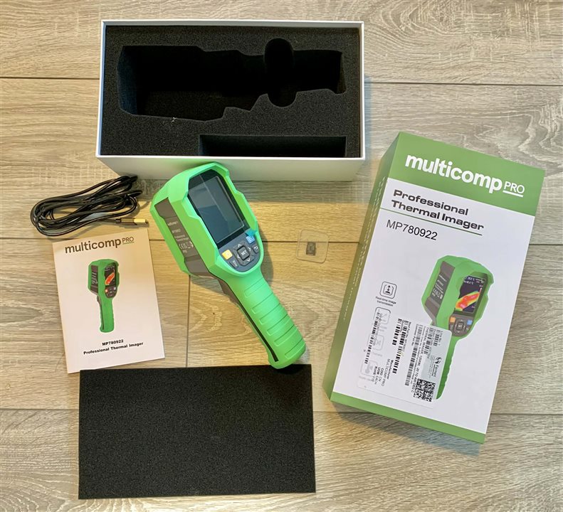

Unboxing the Multicomp Pro Professional Thermal Imager : A First Look
The fine (and clearly very patient) folks of the element14 Community somehow concluded that my particular brand of Halloween-themed tinkering deserved to win this year’s Halloween Hackathon (Please pass on my thanks cstanton).   Armed with my spoils - a Multicomp Pro Thermal Imaging Camera - I naturally decided the only sensible thing to do was conduct my own completely unofficial, uncommissioned, and enthusiastically uninvited road test of the camera.
There’s something undeniably exciting about opening a box that contains hardware you know is going to reveal the invisible. The Multicomp Pro MP780922, a professional-grade thermal imaging camera, promises exactly that - engineering-friendly insights into heat, airflow, energy loss, and electronics diagnostics. I excitedly sliced through the seal the second it arrived on my doorstep, and here’s what greeted me inside.
First Impressions: Premium Kit for Serious Makers
Lifting the lid feels like opening a rugged toolkit rather than a flashy gadget box. The camera sits in high-density foam, and right away its build quality stands out: IP65 enclosure, rubberised grip, and an industrial design that says “drop-tested, field-ready.” If you’ve ever used lightweight hobby-level thermal devices, this is a dramatic step up.
Alongside the camera are:
A USB-C cable for data and charging
32GB Kingston microSD card
A 30-page manual
Everything is neatly arranged and gives you the feeling that the manufacturer actually expects you to use this in the field - not just admire it.
In the Hand: Built Like a Lab Instrument
Picking it up, the camera feels reassuringly solid. The rear features a bright 8" TFT display with crisp colour gradients and a refresh rate fast enough to track movement without smearing. The buttons are tactile, with a rubber membrane ideal for gloved operation - nice for winter outdoor projects or workshops where solder fumes and stray screws wander freely.
The bottom of the handle has a 1/4-inch tripod mount – extremely handy when you want to make use of the PC Interface (more on that later…).
The top of the camera has, squirreled away behind a weatherproof panel, a USB-C port and a microSD slot.
The sensor housing at the front sits behind a protective lens and recessed to avoid knocks and scratches, something you normally only see on higher-end cameras. It’s the kind of fit-and-finish that tells you this device wasn’t aimed at hobbyists - but will make makers very, very happy.

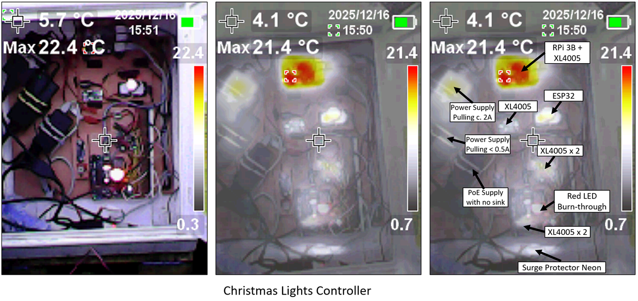

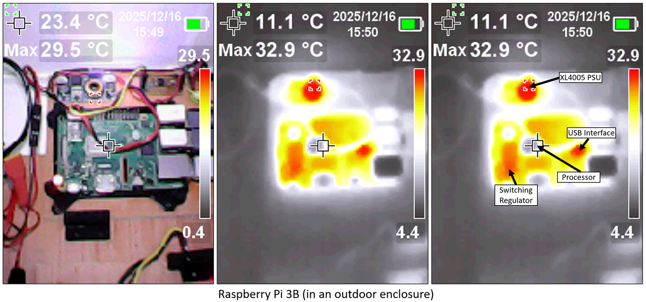

Pointed at a Raspberry Pi centred project (A home-brew Christmas lights controller), it immediately spilled its secrets.
The USB ports were clearly doing some cardio, the power supply circuitry radiated a comfortable warmth, and the processor itself appeared suspiciously chilled. To be fair, the board was sitting outside in wintry temperatures, and the CPU was clearly taking the evening off with a mulled wine when I snapped the shot. Catch it mid-workout and I suspect the thermal story would look very different.
A peek inside the entire project enclosure also revealed the sloths and the athletes in the chaotic jungle of my wiring.
The level of detail is the sort you normally expect from serious lab gear or stern regulatory equipment - not something you casually wave around while grinning at your latest build.

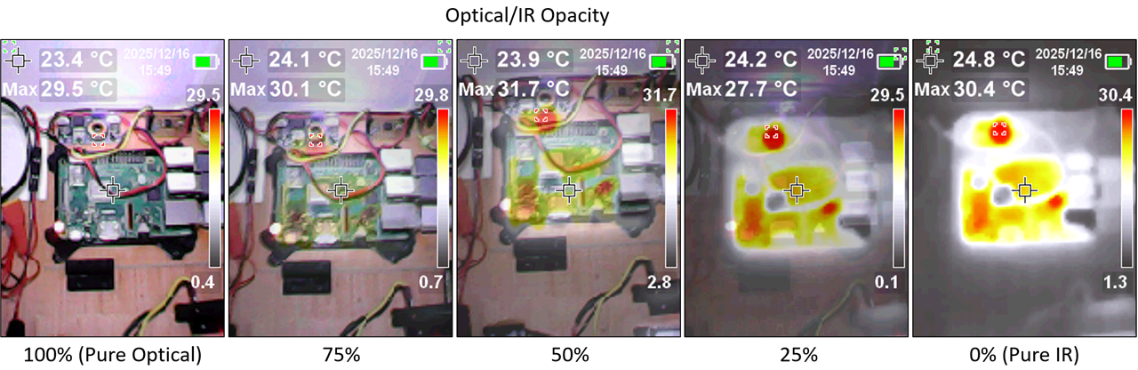

The 120x90 IR resolution gives detailed maps, with the variable opacity enabling you to see the pure IR image or a mix of optical and IR.  This allows you to manage the bleed through of colour from optical images where the optical colour influences the colour maps.

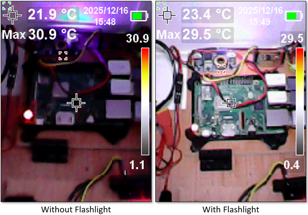

  1. Crisp Illumination for those dark corners
    The built-in flashlight and 100% Optical mode really helps throw light into the darkest of corners, allowing you to frame the shot perfectly before switching on the IR witchcraft
