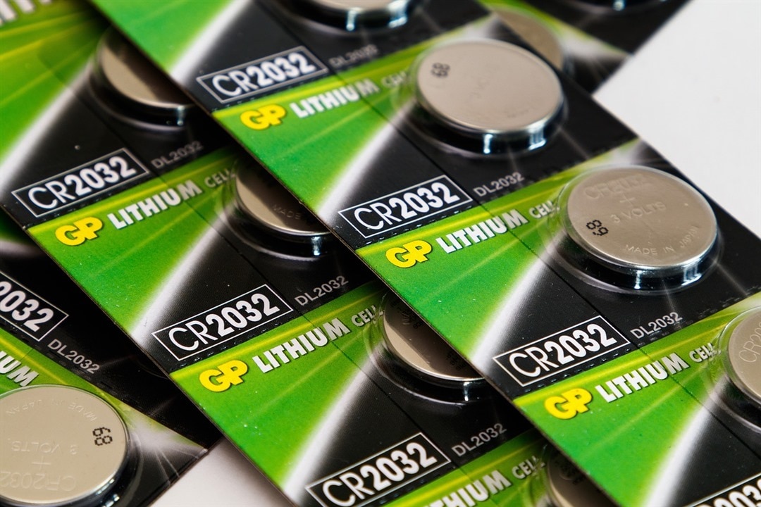

IoT devices typically use batteries as their primary source of power. But the type they use often depends on the application, environment, and energy requirements. For example, IoT devices rely on rechargeable (secondary) and non-rechargeable (primary) batteries. The non-rechargeable types, like Lithium Thionyl Chloride, are practical for difficult-to-replace or maintain applications like smart meters, remote sensors, and industrial asset tracking. They have a high energy density, a long lifespan (10+ years), and operate in wide temperature ranges.
On the other hand, more power-hungry IoT devices use rechargeable batteries, such as Lithium-Ion and Lithium Polymer. These types are ideal for communication and data processing in wearables, healthcare sensors, smart home devices, etc. Nickel-Metal Hydride batteries are sufficient for IoT devices requiring moderate power, as they have decent energy density and rechargeability.
Smart home devices use rechargeables for security cameras,  thermostats, and other smart home devices. They also have nonrechargeable batteries for smart locks and other low-activity devices. Non-rechargeable batteries are commonly used for industrial IoT sensors for continuous operation in environments with vibrations and harsh temperatures. Rechargeables are perfect for wearables and healthcare devices as they can provide constant monitoring in a portable system.

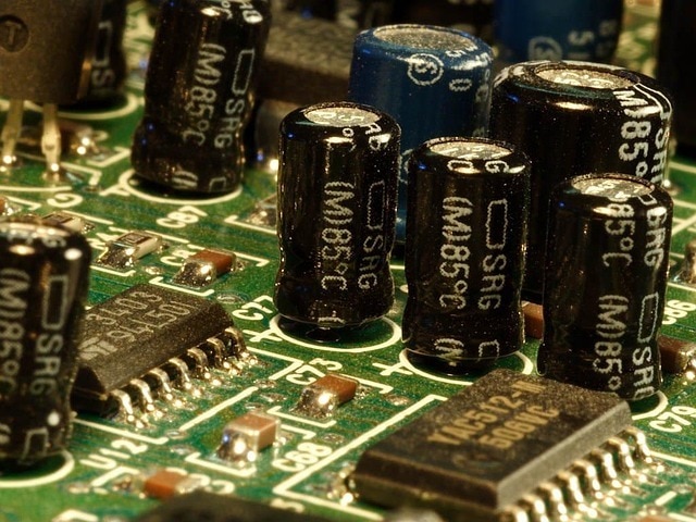

Capacitors integrated on a circuit. (Image Credit: PDPhotos/pixabay)
Supercapacitors are designed to store and rapidly release short, high-energy bursts in IoT devices for powering displays, sensing, and communication applications. This capability is achieved with minimal voltage drops and rapid recharging. They also collect energy from solar, RF energy, or other sources, effectively maximizing uptime.
Supercapacitors can supply backup power to IoT devices for data preservation if the power goes out or during peak loads. Due to their high energy density, long cycle life, and rapid charge, these are more suitable for applications like wearables, smart sensors, and devices in remote regions that require consistent power.

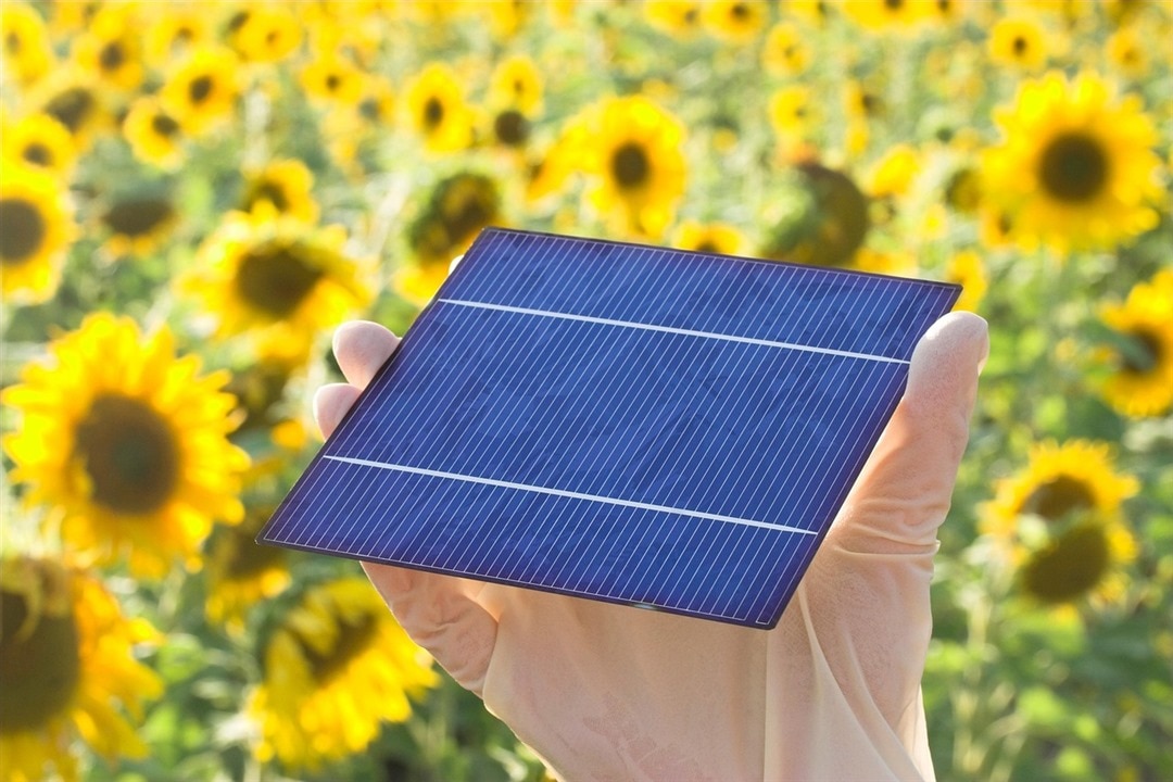

Solar cells charge supercapacitors. (Image Credit: mb-bn/pixabay)
Low-voltage DC power supplies or energy harvesters like solar cells gradually charge the supercapacitors to power the IoT device during high demand. An energy management system efficiently transforms the collected energy into the voltage level a supercapacitor requires. Usually, a dedicated low-voltage DC-DC converter (charge-pump or buck-boost converter) manages the small, fluctuating voltage generated by energy sources. Charging then starts from 0V, maintaining a consistent current flow into the supercapacitor.
In this context, it is important to understand that supercapacitors serve as high-energy storage units with low equivalent series resistance (ESR). This allows them to efficiently store energy from low-power harvesters and deliver short, high-current bursts for IoT tasks like data transmission.
The charging circuit keeps the supercapacitor safe from overvoltage and blocks reverse current flow into the energy source. Since supercapacitors are like a short circuit at low voltages, charging circuits must handle high inrush currents effectively while maintaining efficiency.
We also use wireless power transfer to replenish supercapacitors. This method uses electromagnetic fields to deliver power to the supercapacitor’s receiving coil via a wireless charging unit. Placing the receiving coil within the magnetic field induces an alternating current according to Faraday's law of electromagnetic induction.
Then, the receiver circuit rectifies and regulates the induced current, supplying a stable DC charging voltage to the supercapacitor. This enables wireless power transfer to charge supercapacitors without physical contact, which is ideal for compact IoT devices requiring recharging.
