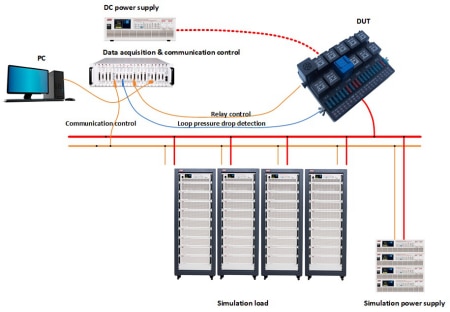

The durability test system for high-voltage electrical appliances is designed by NGI for the endurance & reliability test of electrical components such as fuse boxes in automobiles, rail transit, household appliances, aircraft, ships, medical equipment and other related products.
                         Diagram of durability test system
(This diagram is only for reference. Customization service is available.)

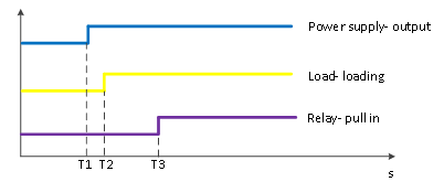

1) The start sequence of each unit can be set on the application software. Within the setting range,  the power supply, load and relay will be activated in turn.
                             Start sequence diagram

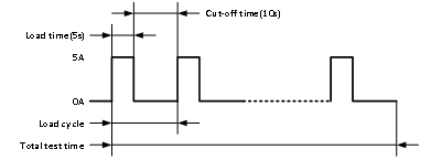

2) The load current and operation sequence can be edited. For example, engineer can edit a load cycle, loading at 5A for 5s and cutting off after 10s.
                             Diagram of load cycle
