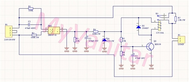

Figure-1 shows the schematic diagram of the device. P1 is used to connect the 220V-AC input and the ON/OFF switch to the circuit. C1 is used to reduce the AC voltage. The value of the C1 also determines the current handling rate for the transformer-less supply to be used by the rest of the circuit. In this application, 470nF was adequate. R1 discharges the C1 to avoid any unwanted high voltage shock when the user disconnects the device from the mains. R2 is a 1W resistor that has been used to limit the current.
Figure 1, Schematic diagram of the AC soft starter
BR1 is a DB107-G bridge rectifier [1] that has been used to convert the AC voltage to DC. C2 reduces the ripple and R3 discharges the C2 at Switch-OFF. Also, it provides a minimum load to keep the rectified voltage at a reasonable level. R4 reduces the voltage and limits the current for the rest of the circuit. D1 is a 15V Zener diode and has been used to limit the voltage below 15V. C3, R5, and R6 build a timer network for the relay. It means it makes a delay for the relay activation. The R6 value is essential, it should not be too low to drop the voltage too much and it should not be too high to reduce the network response time. 1K provided a satisfactory discharge rate for relatively high ON/OFF switching speed. With my experiments, this network provides enough delay and response time, of course, you are free to modify them based on your applications.
Q1 is the NPN BD139 [2] transistor to activate/deactivate the relay. D2 protects the Q1 from the relay’s inductor reverse currents. R7 is a 5W series resistor that limits the turn ON inrush current. After a short delay, the relay does short circuit the resistor, and the full power applies to the load. The value of the R7 has been set to 27R. You can modify it depending on your load or application.

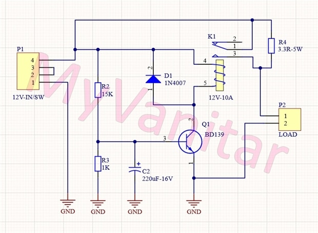

Figure 2 shows the schematic diagram of the DC soft starter. It is a simpler version of the AC soft starter with some minor modifications.
Figure 2, Schematic diagram of the DC soft starter
P1 is used to connect the 12V supply and the ON/OFF switch to the board. R2, R3, and C2 make the delay network for the relay. R4 is the current limiting resistor. The same as the AC soft starter, you are free to modify the delay network and R4 values for your specific load or application.

    It is an interesting solution for reducing inrush current, the one comment I would pass, is that your design would keep the load at its reduced running voltage in event of a failure in the circuit that…
  • three-phase
    three-phase over 6 years ago
    It is an interesting solution for reducing inrush current, the one comment I would pass, is that your design would keep the load at its reduced running voltage in event of a failure in the circuit that prevented your relay from operating.
    For that 220V circuit, you have used a 22 Ohm, 5 Watt resistor, anything above a 0.5A load, which isn't much for mains power, is going to overheat that resistor should your relay circuit fail.
    You may want to look at your circuit so that under a failure, it just puts the supply straight onto the load without going through the resistor.
