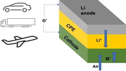

The new lithium-air battery cell consists of a lithium-metal anode, an air-based cathode, and a solid ceramic polymer electrolyte. (Image Credit: Argonne National Laboratory)
Electric car owners have longed for a battery that allows them to drive over a thousand miles on a single charge. Argonne National Laboratory and Illinois Institute of Technology developed a new lithium-air battery that could power cars, airplanes, and trucks in the future. The team claims this battery, which underwent testing for a thousand cycles, can store up to four times more energy compared to lithium-ion batteries.
The new battery has a solid electrolyte component rather than a liquid-based type commonly found in lithium-ion batteries. This helps prevent the battery from overheating and bursting into flames, which occurs in lithium-ion and other batteries.

Previous lithium-air designs had the lithium in the metal anode passing through a liquid electrolyte to combine with oxygen during discharge, yielding lithium peroxide or superoxide at the cathode. While charging, the lithium peroxide or superoxide breaks down into lithium and oxygen components. This leads to on-demand energy storage and release.
The new solid electrolyte has a ceramic polymer material composition made of nanoparticle elements. This creates chemical reactions that yield lithium oxide during discharge. "The chemical reaction for lithium superoxide or peroxide only involves one or two electrons stored per oxygen molecule, whereas that for lithium oxide involves four electrons," said Argonne chemist Rachid Amine.
This is the first lithium-air design to achieve a four-electron reaction at room temperature. Air in the surrounding environment also provides oxygen while it functions. Such an implementation means the battery doesn't require any oxygen tanks.
