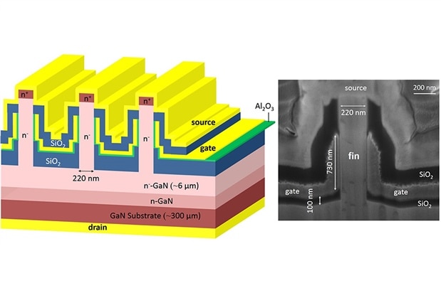

Vertical gallium nitride resistors with fins that act as gates, switching the transistor on and off. (Image credit: MIT)
When it comes to lateral devices, all the current flows through a narrow slab close to the semiconductor’s surface, limiting them from gaining increased voltage while vertical devices utilize the entire surface of the semiconductor, gaining significantly increased voltage prowess. That being said, power electronics depend on transistors to function efficiently as well, but manufacturing vertical-based power devices are both costly and challenging to produce and integrating them into the gallium nitride that doesn’t interfere with the transistors electronic properties are difficult.
The researchers developed an alternative process that makes it easier and less costly to produce vertical power devices- instead of using a narrow region to route power on a large device; they just use a narrower device. The team developed vertical gallium nitride transistors with fins that feature contacts on both sides that when bridged act as a gate and by confining electrical current to a narrower area, it becomes more efficient with less power bleed.
