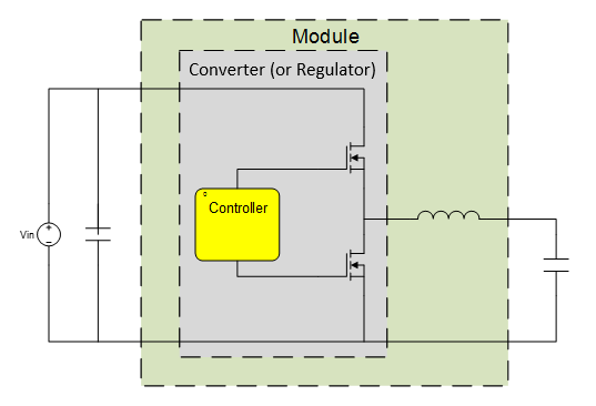

Integration is the driving force behind many of the technologies we see from semiconductor manufacturers. Power devices are no different, whether it be integration of compensation, switching components, multiple outputs or inductors.
For this conversation we are going to define controller as, well, a switching controller. A converter would be a controller with integrated switches (we’ll focus on synchronous converters with both high and low side FETs). We are going to define a module by the inclusion of the output inductor, meaning in most cases all that is left for you to do is add input and output capacitors and your supply is ready to go. We will focus on a basic buck converter since it is most common.
Here is a very simplified model of the integration from a controller up to a module. Other features like power good, frequency synchronization, compensation, etc. can be found in all three types of devices. The core differentiators between the types of devices though are defined above, integration of switching elements and integration of output inductors.
The short list of advantages and disadvantages is typically smaller footprint, easier design but costs more. Let’s look at these tradeoffs a little closer

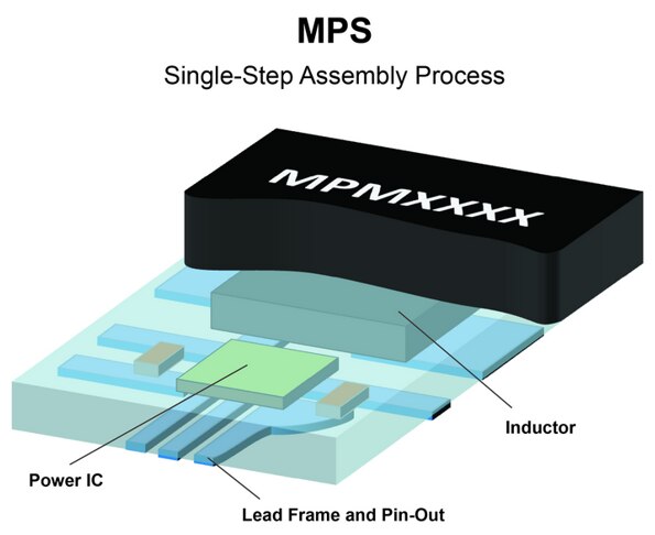

Footprint size and optimized layout are the other big benefits of a module design. The circuit is laid out inside the module to optimize size as well as thermal, EMC, and efficiency performance. The result is that you get an overall footprint about as small as possible without compromising performance. Take a look at the cutaway illustration below from Monolithic Power Systems of one of their power module devices to see an example of how the internal layout is optimized.
